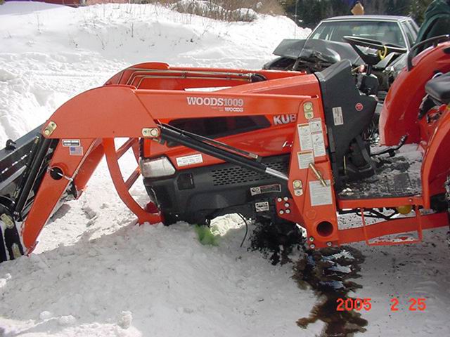

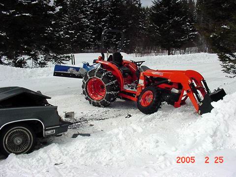

I mentioned this accident on page 2 of this thread. I just found the photos and wanted to share them with the forum.
Everyone ok, tractor replaced, I had three hours on this one when the mercury did it in....
