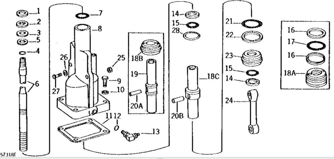

I took the old girl down the road today and that was a scary ride! I have noticed the there is play in the wheel but man its a lot worse than i had expected. So when i got home i was looking at it and when i turn the steering wheel right the whole steering wheel turns up and that is about 3/4 of a turn then when you turn left it will go down. So is there an adjustment for this?

Well there are certainly people with more 400 expertise than me but from what I can see from the parts breakdown on the JD website the upper steering shaft (21) seems to be held in place by two snap rings (7) and a thrust bearing (11) with more shims and washers between.
It seems likely the snap ring and/or thrust components have failed causing the excess travel. I’d be suspicious if failure of another component in the driven end of the steering system could’ve forced the upper shaft and caused the damage. You wouldn’t want to repair it to have the same thing happen again so hopefully someone more familiar will be able to answer that.

Ok. So it looks like I have the power steering option. I have one hydraulic line on the bottom of the steering column on the right side.

I don’t have a manual, maybe someone else can offer more advice but if it were me I’d start by looking at the adjustment nut on the top of the stack and confirm there is no damage there and if it takes up some of the slack.
Looking at how the control valve is laid out it looks like there should be some up down travel but if the adjuster nut has been forced out of the threads, something lower down has probably failed forcing the upper control shaft up. I’d probably pull it all apart regardless to be sure nothing else has failed paying particular attention to the snap rings and thrust washers. Also a good time to replace the o rings.

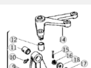

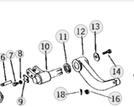

The steering shaft that steering wheel attaches to is designed to move up/down a little as steering wheel is turned from one direction to the other as this movement open/closes control valves in housing. I can't remember the correct amount of movement up/down BUT the top adjusting nut has a specific torque value. I'll bet the steering slack isn't in the valve housing but in the steering lever(key 12)attached to valve housing shaft(loose capscrew) or the bellcrank has worn bushings(key 12) from lack of grease under fuel tank. Remove rear inspection cover in clutch housing & be sure capscrew(key 14) is tight.

You might get by with replacing the bushings, but shaft of bellcrank could also be worn. Then there are tie rod & drag link ends that are most likely worn too.

I can turn the steering wheel 3/4 of a turn before the drag link even starts to move. I removed the cover on the left side of the transmission housing to look at the steering lever and the steering wheel moves 3/4 of a turn before that even starts to move

Hi Jim
Your manual solved my steering problem. There is a large bolt on the steering that someone told me I needed to tighten. I did that and it improved things but when I looked it up in the manual it said it needed 170ft/lbs. When I put a torque wrench on it, I had nowhere near that sort of pressure and it took all my strength to get it up to that. This seems to have fixed the problem and the steering is working fine now. Thanks again.

John Deere did an update. The large washer was changed to a thicker one. IIRC from 1/4" thick to 1/2" thick. The bolt then had to be longer too. JD also changed the torque spec from 170lb-ft to 240lb-ft.
Changing the bolt and washer and the increased torque really made difference on my tractor.
The tech manual also says torque, strike with hammer, torque again.
