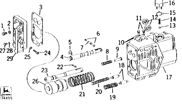

Picture 1: you see the screws labeled as "11" - those screws are test ports for the forward and reverse control circuits. You may be able to apply compressed air to those ports. I did not try that when I had my machine, and if you have leakage, that may indicate a valve problem not necessarily an internal issue.

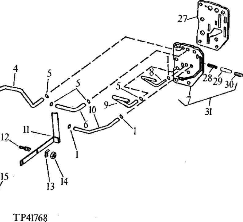

Picture 2: If you remove the reverser control valve, there are oil lines that go directly to the reverse/forward clutch cylinders. If you apply air to those, they should engage either the reverse or forward clutch pack, depending on the line you are pressurizing. I believe the lines you need to pressurize are labeled 8 and 9. This is what I did when I had this problem on my 300. After replacing the forward o-ring, it would hold pressure. It would not hold pressure on forward clutch pack originally.
