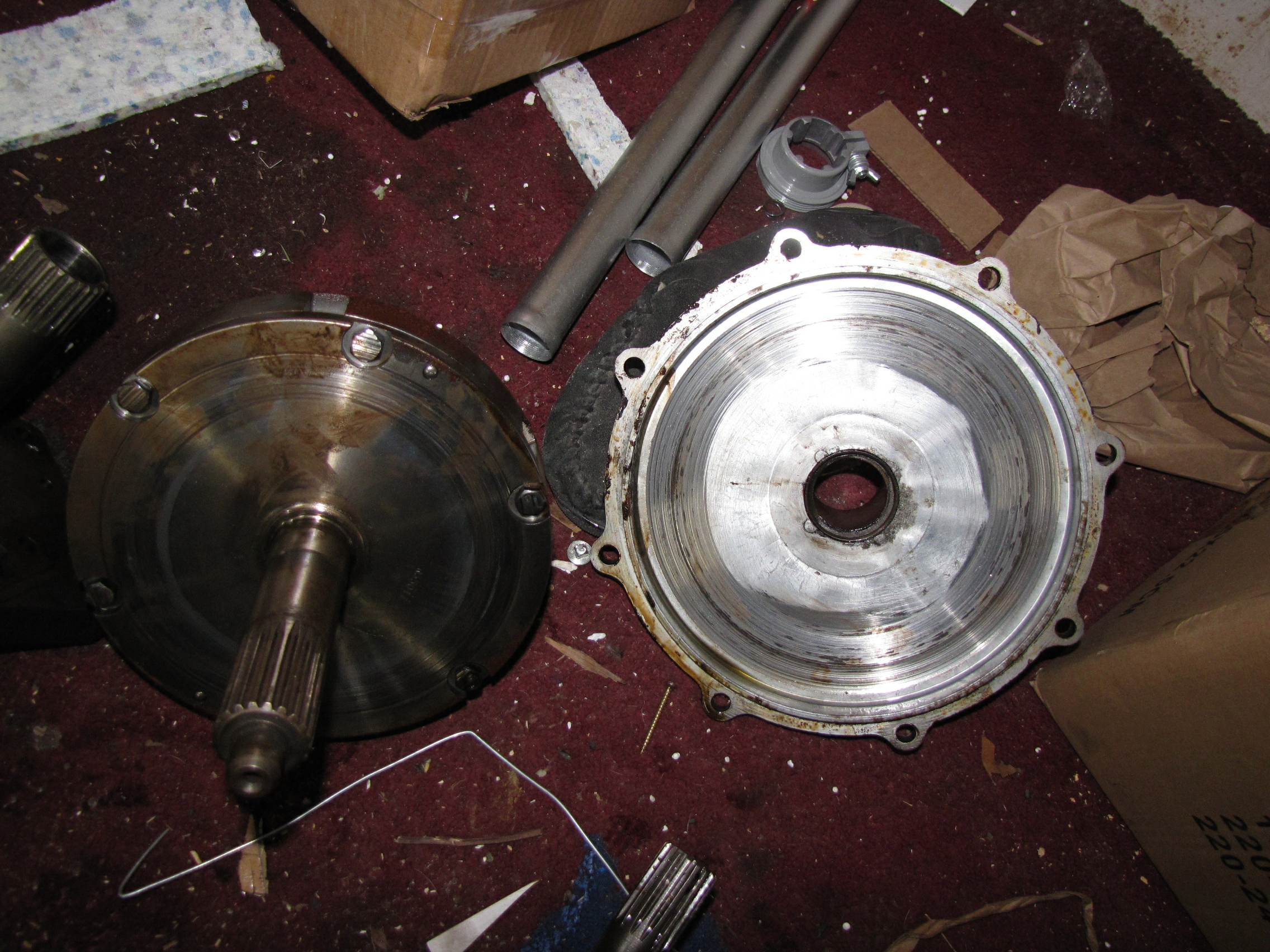

The two parts in your photo. One appears to be the front portion of the forward clutch pack assembly. Yes/no? The cover next to it fits over the shaft and the seal in the cover rides on the shaft back near the point where the shaft and flange/housing meet. Correct? If that's the case, then where does the splined end of that shaft with the pilot stub go? Seems to me there must be excessive room for that shaft to move in that direction.
The bushings where the sealing rings ride are replaceable. I have a book covering a 2440 with reverser transmission and it shows the bushings, showing the I.D. of the bushing for the forward clutch to be 2.130 to 2.133 inches. Its says bushings are replaceable, but offers no specifics about special tool, adapters, or machine work required.

So that one allows for .003 wear. I'm positive this is way past .003
The shaft is the front clutch pack. The end you cant see has the 2 metal rings on it and slides into the housing where the bushing is shot. Then the cover goes on over the end with the spline on it.
The splined end goes into the main clutch on the flyweel.
I really hate to part this thing out. Everything works great other then the reverser and I'm really starting to believe it's just this bushing. I was looking at it yesterday and I can see where the back ring was actually riding past the holes where the oil comes in.
I'm going to call the dealer today and see if maybe I can get that bushing. If so I'll see if I can get it out. I believe if I can get that replaced and put new rings in it it will be fine. The clutches don't look half bad. I can get the cover fixed or make a steel plate to go inside it.

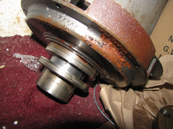

Here's a couple more pics.
This is the backside of the hub that the front clutches are in.
The small part at the end is about 2.3 so maybe it is the same as the other tractor.
The larger part is roughly 3.5. As you can see, it has a large groove. That's where the oil goes through to get inside the hub to work the pressure plate. On each side of that groove is a metal ring to keep the oil in.
Next pic is the housing where this goes.
There's a brass bushing for the smaller part of the shaft (2.3"). It probably needs replaced too, but what's causing the problem is the big insert in front of it where the 2 metal rings ride. It has some pretty deep gouges from the rings and the groove from the back ring is all the way up to the holes where the oil comes through on its way to the groove in the hub. I'm positive this is whats stopping it from working. It's pretty obvious that the oil can escape behind the rear ring. I'm going to call the dealer today and see if I can get that insert. If I cant then there's no saving it. If I can, I'll see if I can get it out.
If so I think I'm looking at the insert, rings, and bushings.
I got my fingers crossed.
