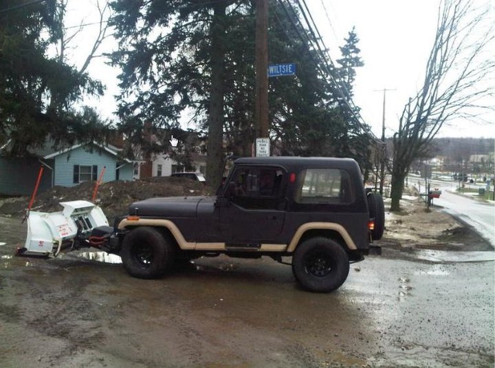

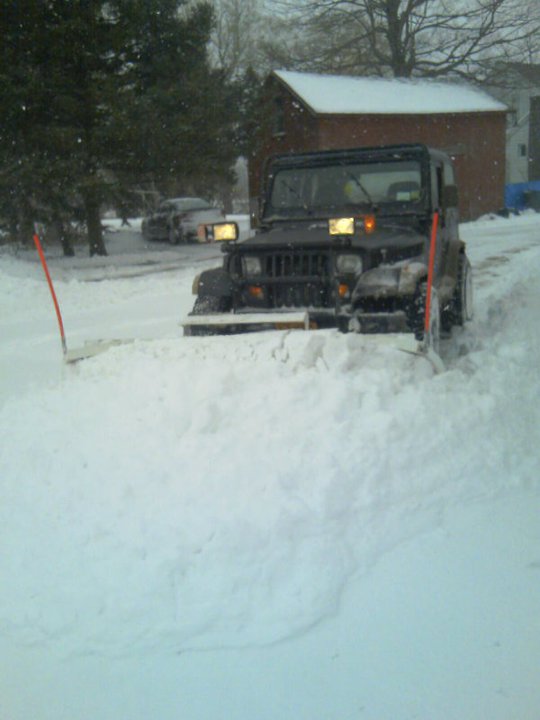

I run a 95 YJ Wrangler.. Last year of the leaf spring front end jeeps. 4.0 liter, 5 speed, with a Blizzard 760 speedwing... it is alot more plow than most will run on anything less than a half ton truck.. The plow contains alot of snow since the wings default in the scoop position.. I will put my Jeep against any truck with an 8 ' plow anyday of the week and guarantee it will out plow it. Maneuverability is 2nd to none on it ! I do run about #600 ballast in the back of it, because it will come light on weight pushing heavy or deep snow.Maybe I can find a picture or 2 of it

Picks of the jeep with the 760 speedwing 7'6" in scoop 8' with the wings pinned back in the straight position.

Do you think maneuverability trumps the lack of weight? I would not like to add and remove 600 pounds of ballast by hand everytime I needed to move snow.

Do you think maneuverability trumps the lack of weight? I would not like to add and remove 600 pounds of ballast by hand every time I needed to move snow.
No. I am running a plow that's alot bigger than the jeep should be carrying, If you went with a 6 1/2 ' blade you would not need that much ballast. I don't have any family so Losing the back seat isn't an issue for me anyway.. Plus its not my only plow truck.. I do have full sized trucks as well..
