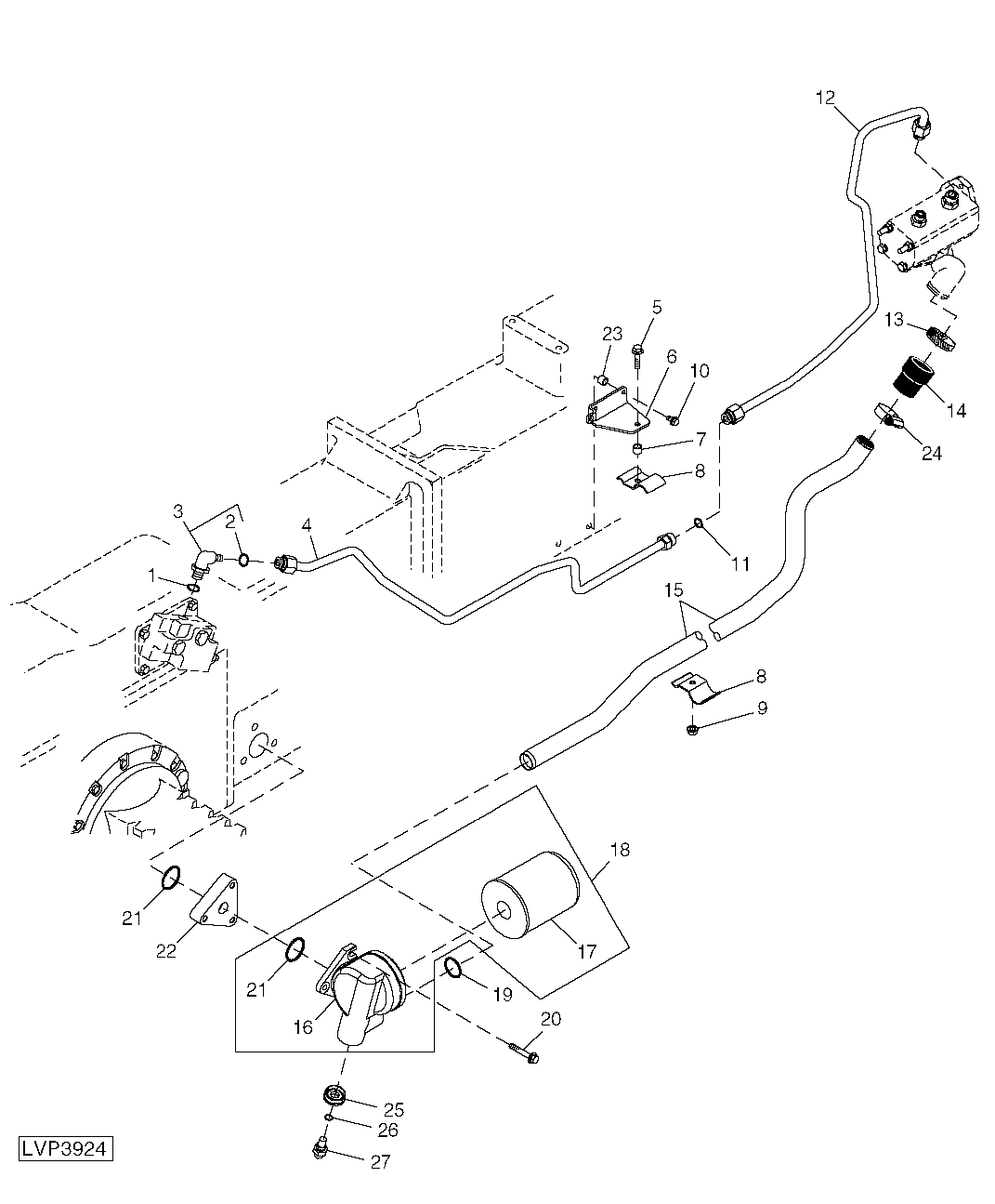

I took out the relief valve and it looks fine. Put it back and no change.
At this point, the only thing I can think of is that I have an air leak somewhere, perhaps one of my hoses is bad. I have a friend in town with a hydraulics shop and I'll be taking my tractor to him as soon as I get my trailer fixed.
The suction hose would be the one to really look at because the others would be leaking oil...
   / Jerky hydraulics on JD 5310 #16
Hose is #14. Orings #19 and #21 could also leak air into the suction line.

Thank you sir. I'll have a look see tomorrow.
