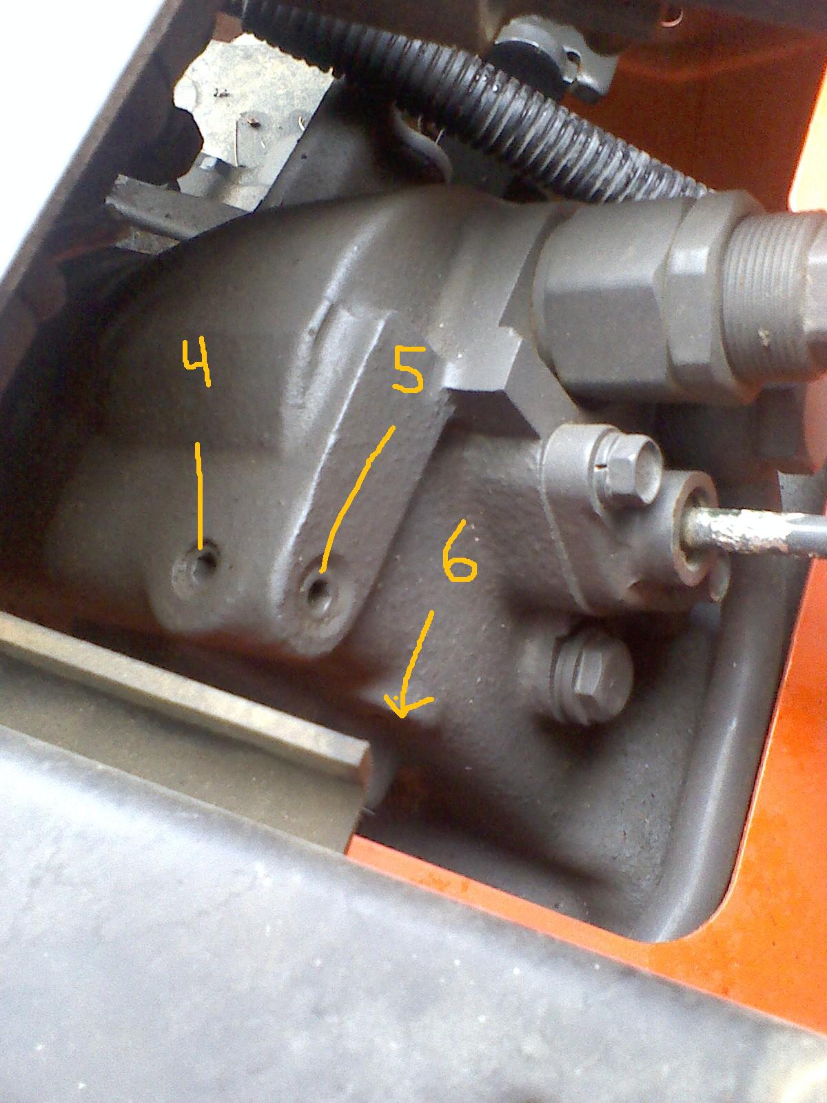

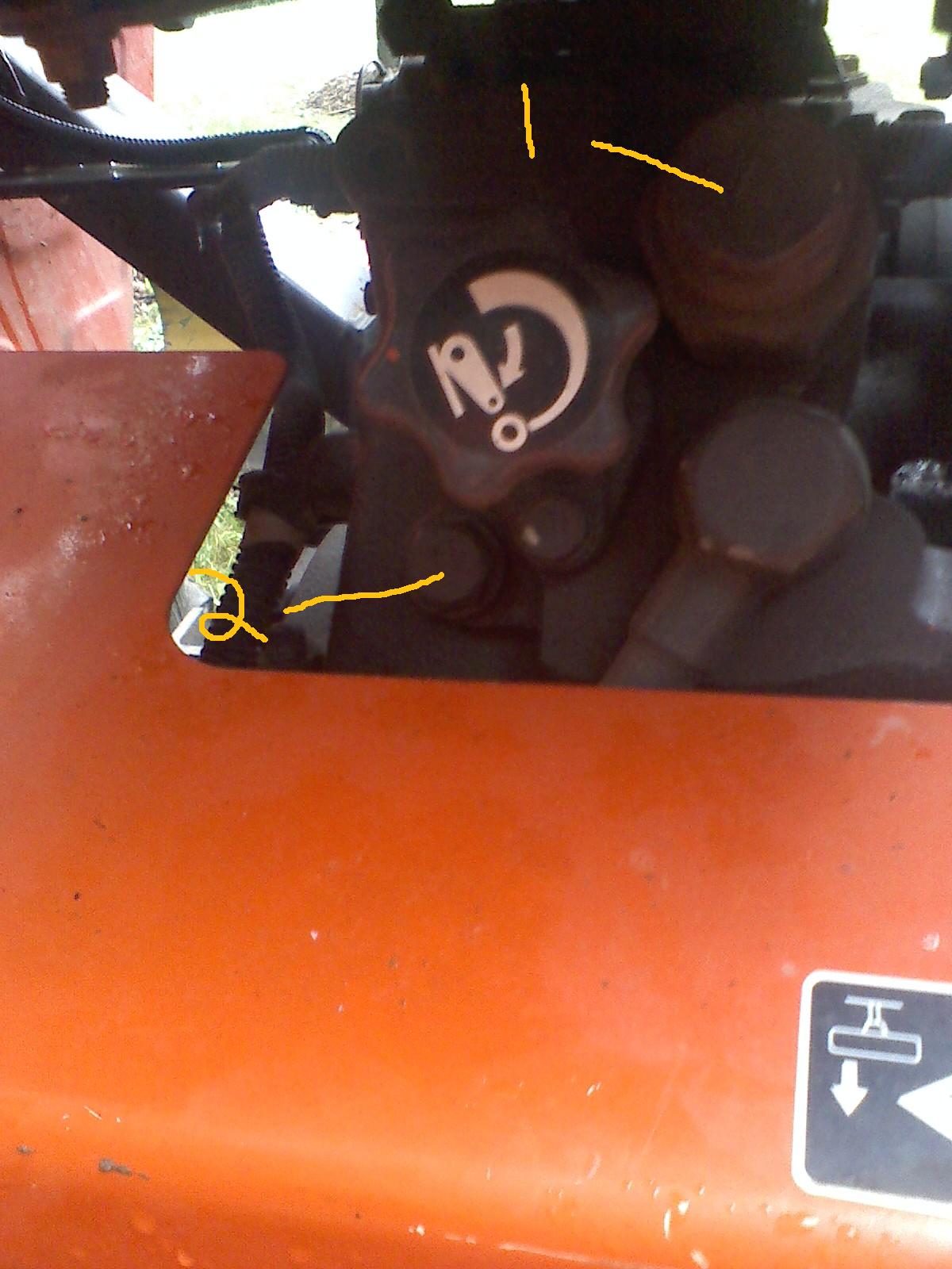

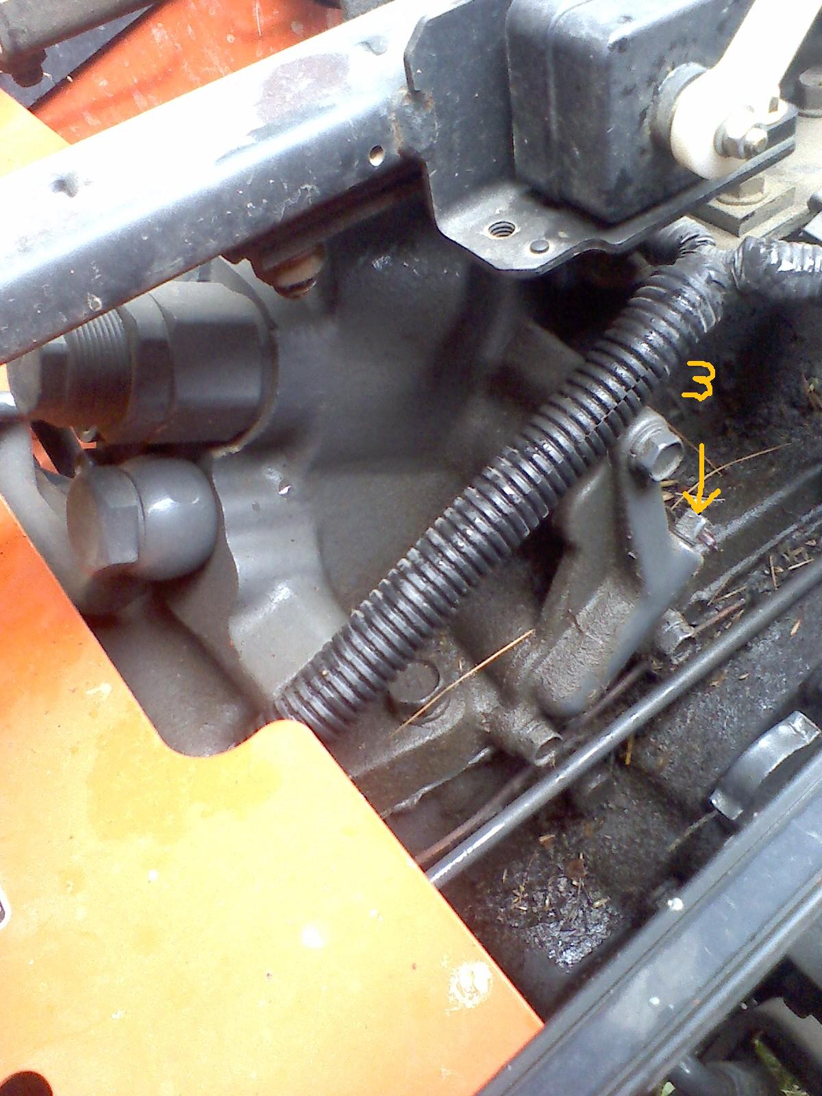

Well, I have often read these "jerky 3PH" threads, and until now, there seemed to be no hope. Mine is jerky. I have just learned to deal with it.
I kinda was hopefull when it was said that an adjustment was all that was needed, until the post about the adjustment being inside and top-cover needing removed and all. If that is the case, I will continue to deal with it, because for me, living with it is worth not having to take it appart, because it just aint that big of a deal to me.
And I doubt my dealer will be any help. I purchase the tractor 5 years ago, and have not even been back, or complained about the problem to them. So I dont see them being any help (not that I would even want it) if I called them and said "hey, I bought this tractor off of you over 5 years ago and ...".
But at any rate, it prompted me to take a closer look at mine. And there are some plugs and bolts (some look adjustable) on the top cover that I have no Idea what they are, or what is under them. So I posted pics and was just wondering if you guys had any Idea???

most are just "plugs" (???) #60, 40 and 20 (sorry not much help...) Except for #1 in your photo... Assy Valve Safety (again ???)
