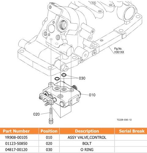

The YR908-105, etc... are the complete valve assemblies for the newer-ish tractors.
Attached valve part number for L3800.
Unfinished, do you have the parts break down for the internal guts of that valve? Should be listed as control valve - parts???
