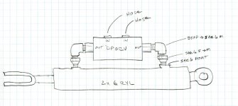

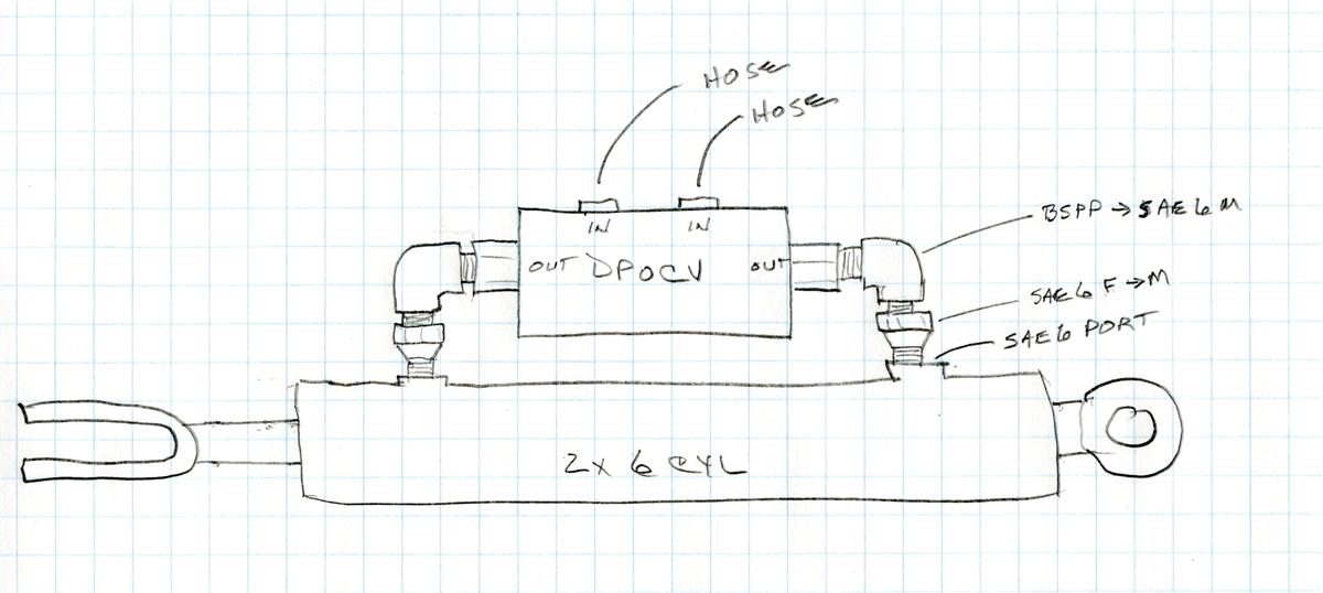

I'm probably confusing everybody, with me first in line, LOL.
Since a picture even crudely drawn is worth 1000 words:
1. All DPOCV ports are 3/8 BSPP.
2. Wanted BSPP to SAE 6 swivel elbows, no such animal. The only BSPP to SAE elbows I could get are "rigid adjustable" (has an "adjustable" nut on the SAE side which is not shown on my crude drawing).
3. Because the elbows are rigid, in order to assemble this obviously the elbows must be taped and screwed into the DPOCV until the length between the cylinder side of the elbows exactly matches the distance between the SAE 6 ports on the cylinder, and then install a swivel connector to make the hookup to the cylinder ports. So I have been looking for a SAE 6 female to SAE 6 male swivel adapter. None found.
4. Plan B is to try instead a 3/8 JIC female to SAE 6 (orb) male swivel adapter.
Longer cylinders with more working room between ports make this easy by using tubing and flare fittings. When there's no room for that, it has be all fittings. Either that or have a big mess of plumbing hanging off the cylinder, which I don't want to do.
Does this help?
/ JIC vs. SAE substitution #9
Picker77,
I see, thats's tight......is there room to possibly turn the DOPCV 90 degrees and use 90's on the cyl ports and valve block, then use tubing bent at 90 degrees to make up the diff....?
or mount valve block to side and use small 1/4" ID hoses between block and ports...?
Yep, I could probably do either of those, but that's what I meant about having a bunch of plumbing hanging on there, trying to avoid that.

Leonz, please note that nowhere in my diagram are there any BSPP threads being used with non-BSPP fittings--All four ports on the valve are BSPP, and the elbows are BSPP to SAE-6. The problem is getting from the SAE-6 side of the elbows into the SAE ports on the cylinder. That is going to require a straight swivel adapter, which I can't seem to find in SAE-6(F) to SAE-6(M) configuration. Thus, the consideration of possible workarounds mentioned so far.
I'm hard headed so I'll try this myself first, and if I can't make it leak free then I'll drop the whole thing on the counter at my hydraulics shop.. those guys love to see me coming. :laughing: But for me, first trying to figure out myself how to make these things work is half the fun of owning a tractor. If I just wanted to be done with it, I'd have coughed up the $260 and bought a ready-to-use side link cylinder from CCM, lol.
