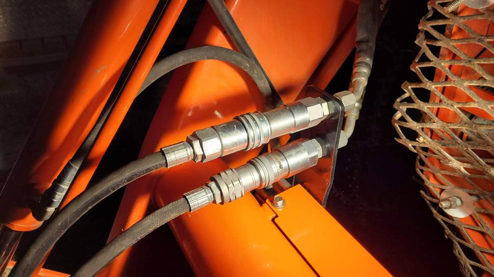

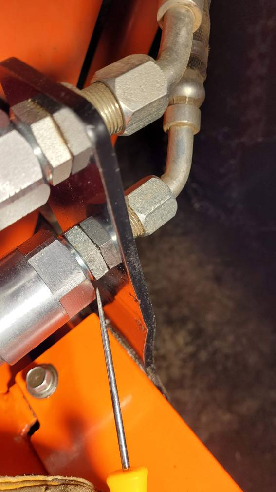

The first pic shows the full set of connectors. The second pic has a probe pointing to where the ORB connection has been leaking.
The leak has been creating a visible trail of fluid, with drips to the ground every 10 to 12 seconds.

In picture with probe Is the leak between lighter colored hex and disconnect body? If yes look very closely at where fitting mates to disconnect body. Can you see edge of chamfer around the fitting? I have seen a few fittings where hex was turned down and exposed the chamfer causing them to randomly leak.

Mr. Oldnslo, the leak has been where the 2 fittings join...at the tip of the probe.
Previously, the O-Rings did not show any visible deformity or obvious indication of failure.
My 66 year old eyes did not find any gouges or rough spots on the metal edges where the O-ring seats.
If it returns, I will disassemble and get some close up photos of how the O-ring is seating on the fitting, and both connector ends...maybe an enlargement of the photos will show something.
Worst case is to replace the fittings...but hate to throw $$$ away!
