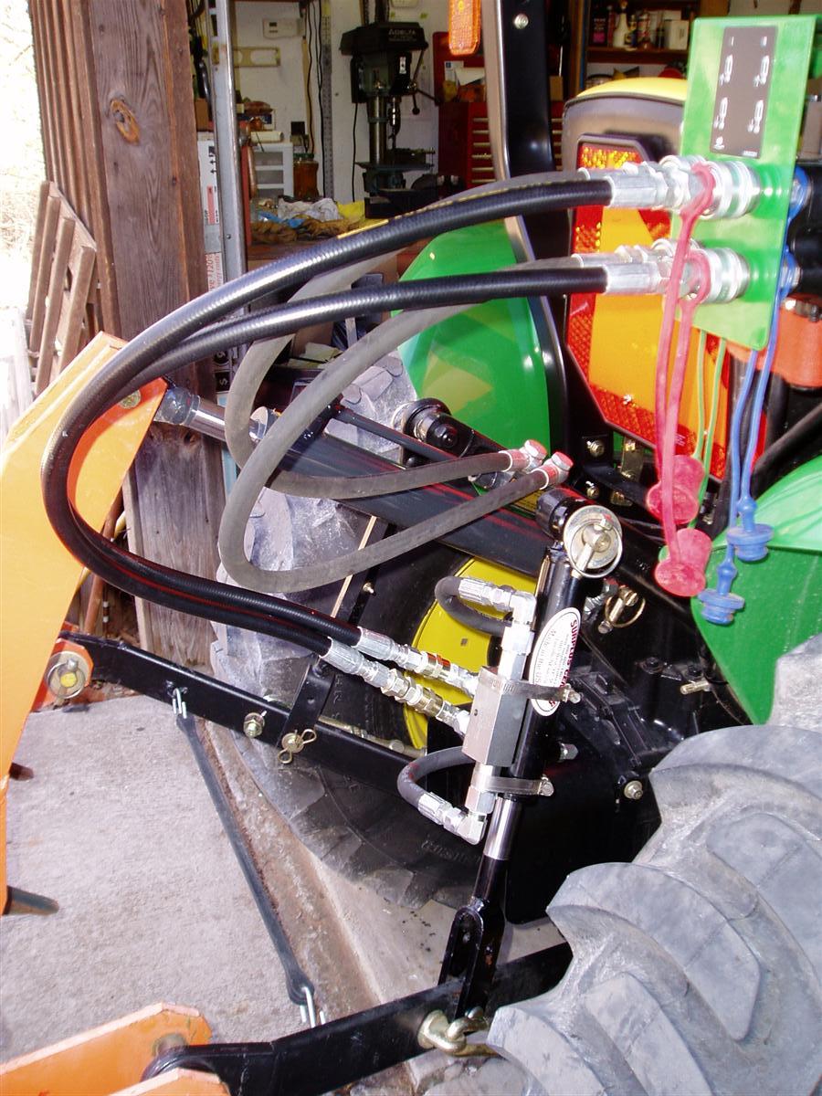

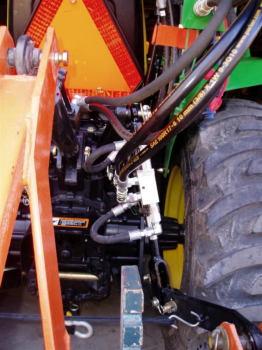

Finally threw in the towel and Rube Goldberged this hydraulic side link. It works great, but isn't pretty. There was just not enough cylinder length between ports to do it neatly like I wanted.
   / JIC vs. SAE substitution #54
Are they (the little short ones) 3/8" hoses? All you needed was 1/4" for everything, cheaper and easier to route, and less bend-radius.
   / JIC vs. SAE substitution #55
Don't forget you can always run double 90's out of the DPOCV and connect to the opposite corresponding port on the cyl (cross hoses)....then just reverse the other feed hoses......
#56
Good idea, that would have worked too. Never dawned on me to cross them at the cylinder and simply reverse the QC's. Duh... However, these will be ok as is, I think. Although I have exceeded the recommended minimum bend radius a tad on the two short hoses, they are permanently in place and don't need to twist or flex in use.
Kenny, the hoses are 3/8". I've standardized the entire tractor to 3/8" fittings and hoses, since that size hoses and fittings are so readily available off the shelf just about everywhere.
I still need to fabricate a small bracket up front for the grapple QC's (currently tie-wrapped to the torque tube).
The last thing I can think of is scraping up enough money to install a dedicated control for the grapple, maybe with a thumb switch on the joystick--one of these days--so I don't have to run the grapple off a rear remote. But that's in the "nice to have" category, and it can wait. Since I use the HSL a lot more often than the grapple, the current setup isn't any real trouble to use.
