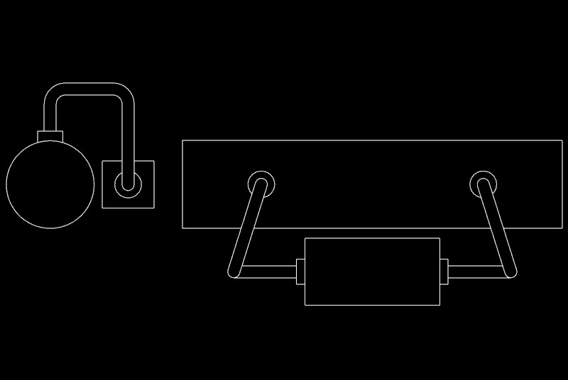

Thanks, HHG.. That might have worked better, but the problem I saw with it was when those elbows were properly tightened into the body of the DPOCV, their 90 degree ends would be too close together to exactly match up to the distance between the cylinder's ports. Conversely, the BSPP rigid elbows I have came with a very long (about 3/4") thread length on the BSPP side, so they are sort of "adjustable" and they will end up about two threads short of bottoming out when they are at the correct distance apart. So I'm hoping I can count on a double layer of PTFE tape to make that joint seal even though they won't be bottomed out. Might not work, I'll know soon. I do have a bag of the correct size BSPP bonded seal washers, although I won't need to use them for this setup. I'm probably doing a lousy job of trying to describe what I'm trying to do here, sorry for that.
If this works I'll post photos. If it leaks, I'll own up to it and move on with an alternate solution. In any case, you guys have all been a big help in my attempt to get it done. Even if it doesn't work, I've gained a ton of valuable schooling on connectors and adapters during this little exercise.

I don't know if you've resolved this issue yet or not, but what about placing the valve off to the side of the cylinder. This would allow you to splay the lines out a bit to make some more room. The attached sketch does not show any fitting for clarity... just shows "tubes" that would be comprised of various fittings, etc.

Tried it out this afternoon, leaked like crazy--but NOT at either end of the BSPP fittings. They stayed tight and dry. The problem (as I feared) was making the female JIC to male SAE swivels leak-free. So I still have some things to try to see if I can make that work. The straight female to male swivel adapter (the male end of which goes directly into the cylinder ports) has to swivel, or I can't get the rest of the assembly screwed in.
I reinstalled the side link cylinder back on the tractor (without the DPOCV plumbing) and I'm suspending work on it for the moment while I get some long hoses and QC's made up and installed for a bucket thumb I just finished building a mount for. I need to get the thumb working ASAP, so I can do some brush clearing work while the weather is good. Then I can go back to the side link project.
Mechanos offered another possibility using tubing (thanks), and I might have to go that route, dunno yet. I do know shoehorning the valve directly between the ports on this short-bodied cylinder using just fittings has not been easy. :)
