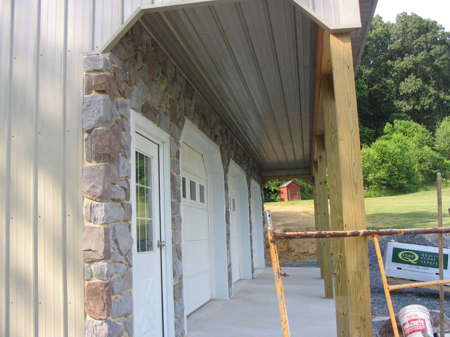

Here is a shot of the front from the side. We have about a half day of work left.
Not much for the PT to do now except hold the box with the stone in it and carry the morter bucket.

That is one classy garage! /forums/images/graemlins/cool.gif If only my house looked as nice. /forums/images/graemlins/frown.gif /forums/images/graemlins/grin.gif

Beautiful job !! , I have always wondered how they put the stone up before doing the mortaring? Is that some kind of special backing that the stone sticks to, holding them in place until mortar can be applied, or just a thin layer of mortar? I ask because I have been contemplating doing the same thing to the base of our house. /forums/images/graemlins/ooo.gif

Thanks Chad...
Barry:
They tack a metal web to the face of the building and then apply a coat of cement. when that dries, they attach the stone veneer much like you would brick, with a cement morter.
After the stone has dried some, they start the morter the gaps.

Sounds easy enough, I appreciate the info. /forums/images/graemlins/laugh.gif
