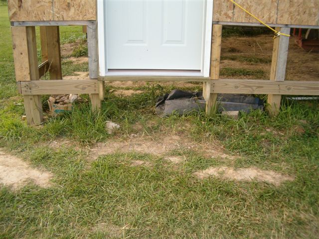

#171
Re: Jim\'s Pole Barn Project - hopefully
How do you like my fancy door knob? /forums/images/graemlins/laugh.gif

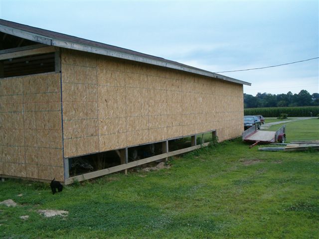

   / Jim's Pole Barn Project - hopefully
#172
Here is the North side. All done except for one piece at the end and the bottoms. That should be much easier and I'll be able to do it by myself.

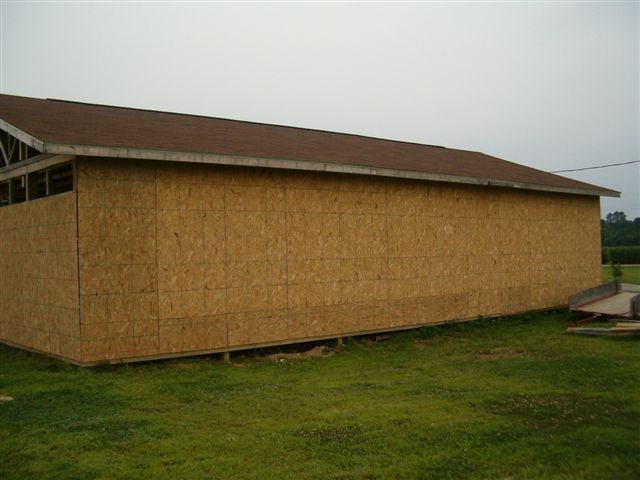

#173
What is left to cover of the North side.
#174
From this post you can tell how much fill I have to do at the front of the building. The back is only about an inch or so off the ground. By the time I remove the top soil I'll probably be filling about 18" in the front. I felt it was better to come up then go down because of water. I was really afraid that if I didn't come up that I could have water problems. So it'll end up costing to have fill brought, but probably cheaper (and less headache /forums/images/graemlins/smile.gif) in the long front. But the door sure is funny looking out there in mid-air. /forums/images/graemlins/grin.gif

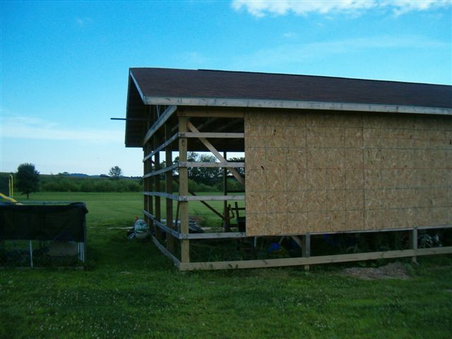

#177

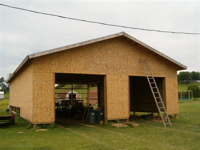

Here is a shot of the back also around 3:15 or so. I took these pictures in case I forgot later or if it started to rain.

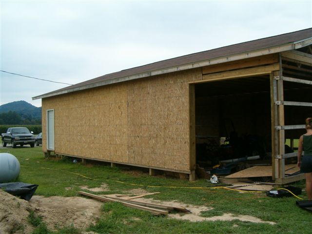

Here is the North side, around the same time as the others.

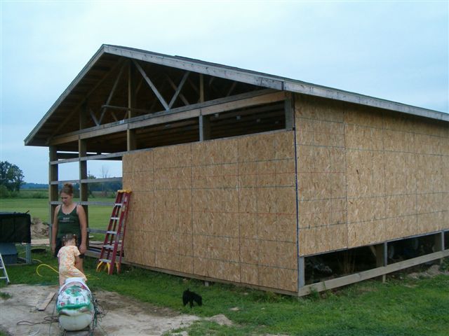

#179
Here is the front. We put the OSB up in smaller pieces to make it easier to handle. We went 24" wide and whatever the height was except the 3 or 4 middle pieces we broke those at the bottom cord of the truss.

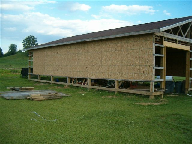

#180
This is what the North side looked like when I finally quit around 6:30 or so - it started raining /forums/images/graemlins/mad.gif /forums/images/graemlins/crazy.gif
As soon as we get this top covered I wanted to get it wrapped with Tyvek. This will by some time. As I want to get boxes in for the outlets and outside lights as well as give some time to save up some $. I might also go ahead and start wrapping some of the trim in aluminum. I'll probably also get the front doors up as well. Still haven't purchased the door for the tractor yet though.
