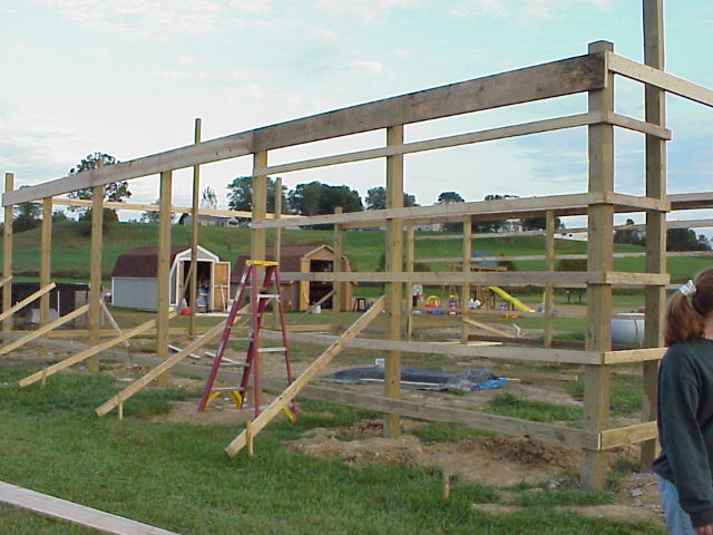

Hadn't posted in awhile because I hadn't made much progress in awhile. Had to go a way for a week for business, a wedding, and a couple of other things got in the way. I finally got all of the poles set and cemented in. I got the PT T & G 2X6s around the bottom to find the level. Was also able to get the 2X12s up on each side, 2X6s on the end and inside of the 2X12s at the top, and got a over half of the girders up. Was also able to get the 4X6s on the side cut off to the appropriate height. Here is a picture looking at the front where the 2 bays are for the car and truck.

Here is looking at the "right" side. Toward the back you can see where the tractor door will be. When we were putting the PT around the bottom forgot to skip the door. I'll come back and cut the off w/ the recip saw.

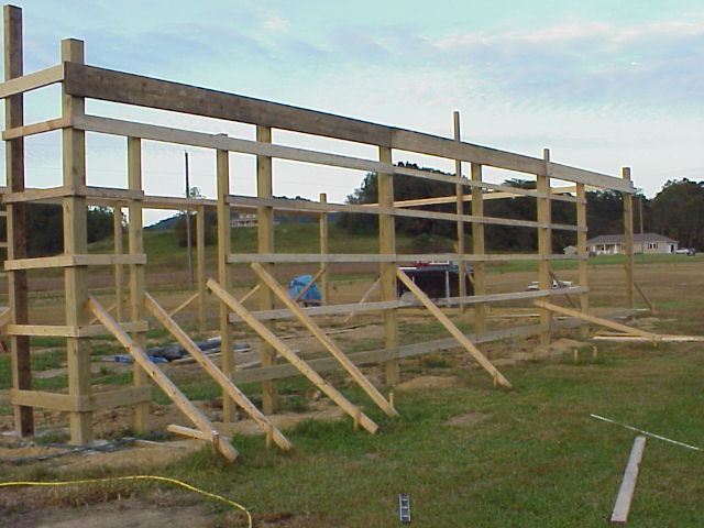

Looking at the left side. Only got the first set of girders up on this side. Still have the back to do yet too.

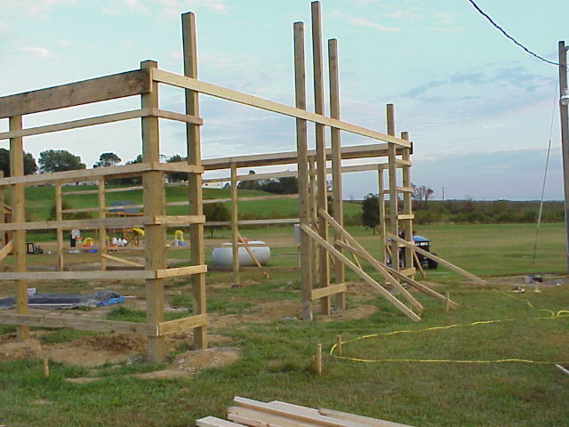

Another view of the front & left.

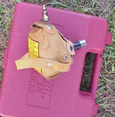

Why we were able to make so much progress today. Love this handy-dandy little tool. Especially considering it was only $80.
   / Jim's Pole Barn Project - hopefully
#59
Re: Jim\'s Pole Barn Project - hopefully
Looking down the "barrel." This little thing is call an air palm nailer. This one is made by "Tradesman." It put the 20d Ring Shank nails in like they were nothing - fast too. I didn't actually time but I bet it would put those 20d nails in, in 5 - 10 seconds definately being closer to the 5. Not as fast as a framing nailer, but a whole lot faster than a normal hammer. Doesn't wear you out either like swinging my 22oz. Eastwing Framer. A couple of points about it. It doesn't require special nails. Any nail will work. It has several heads including the normal one (which we used today), a magnetic one, a finish nail one, one for vinyl siding, and a hammer head. Came w/ extra o-rings (hope I don't need those for awhile) and a 3 year warranty. Unless I can talk Carter Lumber in to giving me a framing nailer w/ my OSB/roofing order, this will be my framing nailer for awhile. Must not use much air. My little (6HP, 33 gal) Craftsman oil-less compressor only ran maybe 7 or 8 times all day and my drain valve is leaking a little bit. Got my $80 worth in one days use. Wish I would remembered I had it yesterday when we hung the first 3 2X12s /forums/images/graemlins/crazy.gif, todays 3 were much easier. /forums/images/graemlins/laugh.gif /forums/images/graemlins/grin.gif Is that a sign that you have too many toys.....err....tools when you don't remember that you have them? /forums/images/graemlins/confused.gif
