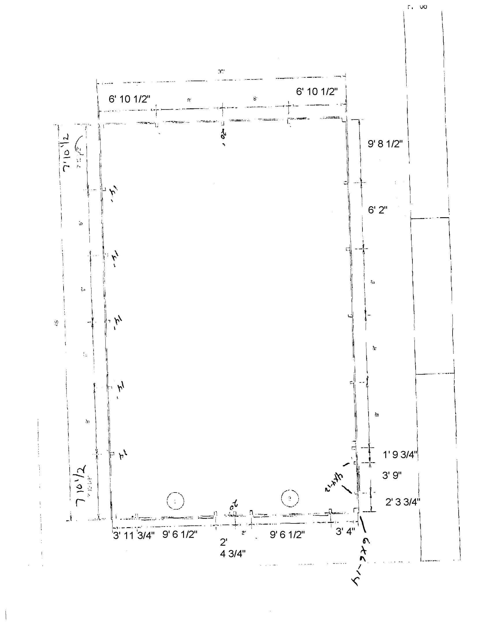

Sorry Joe that it took so long to get this posted. Been a lot going on lately. I hope this is readable. Just remember all measurements are to the center except for the corner posts. They go to the outside edge of the pole. All poles are 4X6 except for the corners they are 6X6.

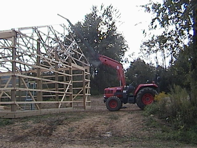

</font><font color="blue" class="small">( Forgot to mention that I'll be putting the trusses up on the 18th. That'll be my second milestone, I've got 4 major milestones, first was the poles, second w/ be the trusses, 3rd w/ be the roof, and finally completion. I guess there should be 5 if you include the floor. But that is phase 2. /forums/images/graemlins/grin.gif )</font>
How do you plan on attacking the trusses? I was going to rent something, but my brother said he would make me a boompole to attach to my quick attach plate. /forums/images/graemlins/smile.gif
This worked very well. Strapped the truss in the middle and had two guys on the ends with ropes to steady it while I positioned the truss.
I attached a picture of it.
Good luck, RedDog <font color="orange"> Kioti DK65 </font>

Another picture.

How do you plan on raising the trusses? You're gonna set them on the 18th? I may be out of town, in Louisville at the Power Equipment Expo..........OR found out today, I may be having another stent or two put in the ol' ticker. We'll see how things work out.

Very Carefully /forums/images/graemlins/grin.gif. I've got Plan A & Plan B. My cousin and I are going to try to use a 4X6 attached to the bucket and try to see if we can lift them that way. Otherwise I think there will be 5 of us there. I think we could probably set them up upside down and flip them. Right now I would like to try to Plan A.
