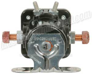

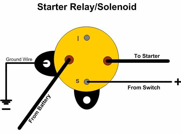

Yeah, that's typical for Chinese wiring. Mine was even worse than that. 10 volts at the solenoid won't give the pinion much of a kick - and I don't think it will even work below 9v. On a cold day it gets even worse.
I installed a an inexpensive NAPA starter relay and some 10 gauge wire. Now I get full voltage to the solenoid, and she cranks first time-every time.
If you need help identifying the solenoid - or wiring it up - just let me know. If you're interested, I installed a relay for my glow plugs too.
//greg//

   / Jinma 284LE won't turn over #20
No problem. Here's what the relays look like that I put on my TS354C; one for the starter, one for the glow plugs. The diagram shows how to wire in the starter relay. Note the wire that says "from switch". It's ok to use OE wire there, but when it comes to conducting current - bigger is better. So you might optionally consider replacing that OE wire with 10AWG stranded.
If you like this idea, we can talk about wiring in another relay to get more current to your glow plugs as well.
