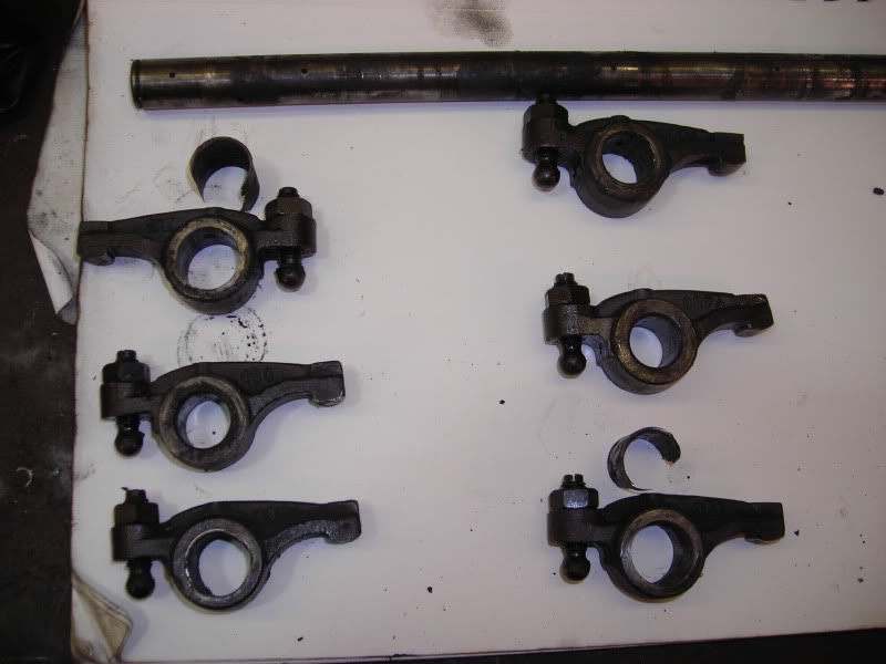

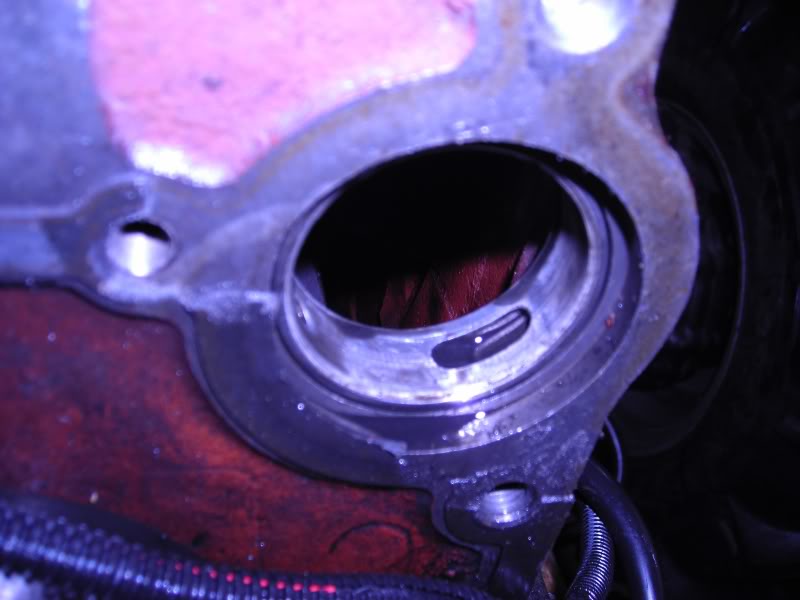

Once I diassembled the oil pump so I could get the camshaft out I tapped it out forward thru the block I think, it's been awhile ago so it fell out the bottom, I only replaced the one that was in wrong. Watch when you remove the camshaft, the tappetts are solid and will drop down once you start pulling the camshaft and fetch up against the lobes. No big deal, you can just reach up thru the bottom of the block and push them up. The oil held a majority of them in place for a bit till I go it out. You can see one of the slotted holes in this pic, there's two. One is the supply from the oil supply galley, the other that you can't see is the supply to the top end. The rear cam boss has a narrow slotted groove about 60 degrees or so around the periphery of it that only aligns both holes for a portion of the rotation, that's what meters the oil to the top end.
Damage, you can see the worn sleeves in the rockers, could have been worse I guess.
When you put them back is a bit different, I used thick axle grease to hold them in place while I put the camshaft in. Try and reuse them in the same place
Don't forget a new welch plug for the end of the camshaft bore. I did and had to fill the hole I had drilled for pulling with a sheet metal screw with weld to reuse the old one..
Once you get the head off and if have to turn the engine over for any reason with the pistons still connected watch the sleeves don't move. I had to use some short pieces of 2 x 3 and the head bolts to put over the top of each cylinder to make sure they didn't move up.
Mark the gear train at the front to make sure you get everything aligned. I think that was a gasket I forgot to order and had to make also.
I had a bunch of pics on Photobucket when I did mine but we all know where they went. I guess they're still there, I attached a few...............Mike

How did you pull the old bearing and push in the new one?
I carefully tapped the old one out using a screwdriver, wasn't tight at all. The new one I used a block of wood to get it started and used that as far as I could, once it was flush with the top of the counter bore (where the welch plug sits) I used the old bearing since I didn't care if that got screwed up. It went in the bore slightly but not enough to make it hard getting it out with a bit of wiggling. When you do put the new one in, make sure you get the two passages lined up and watch you don't drive it in too far..........Mike
