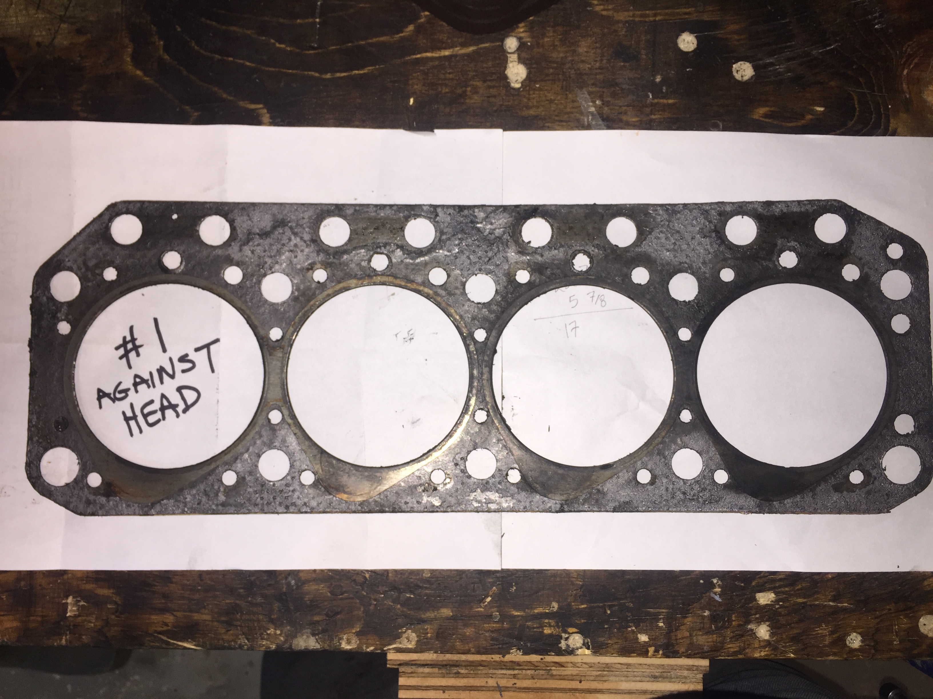

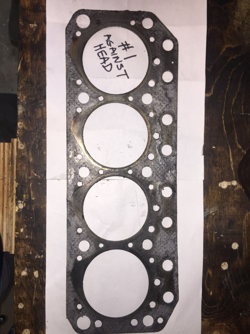

Update : Received new cam and bearings. Removed head.

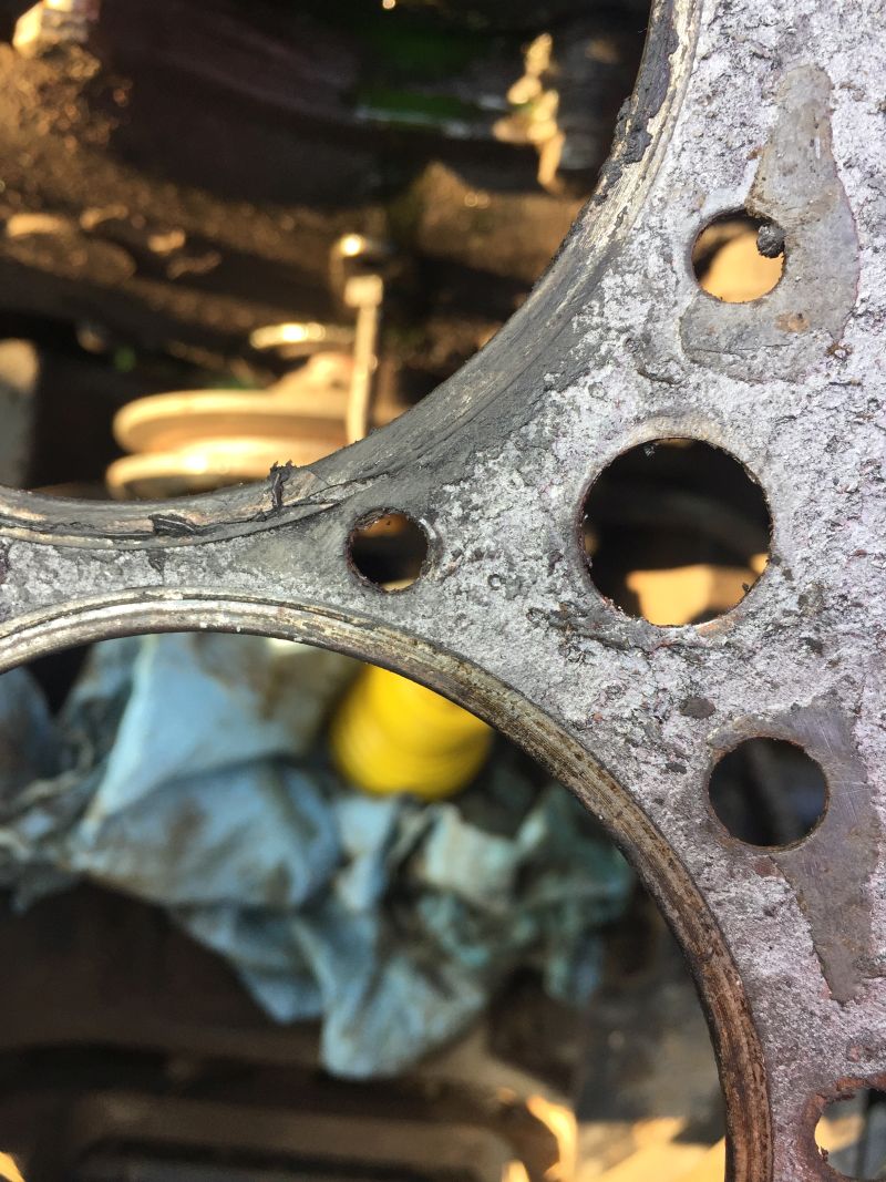

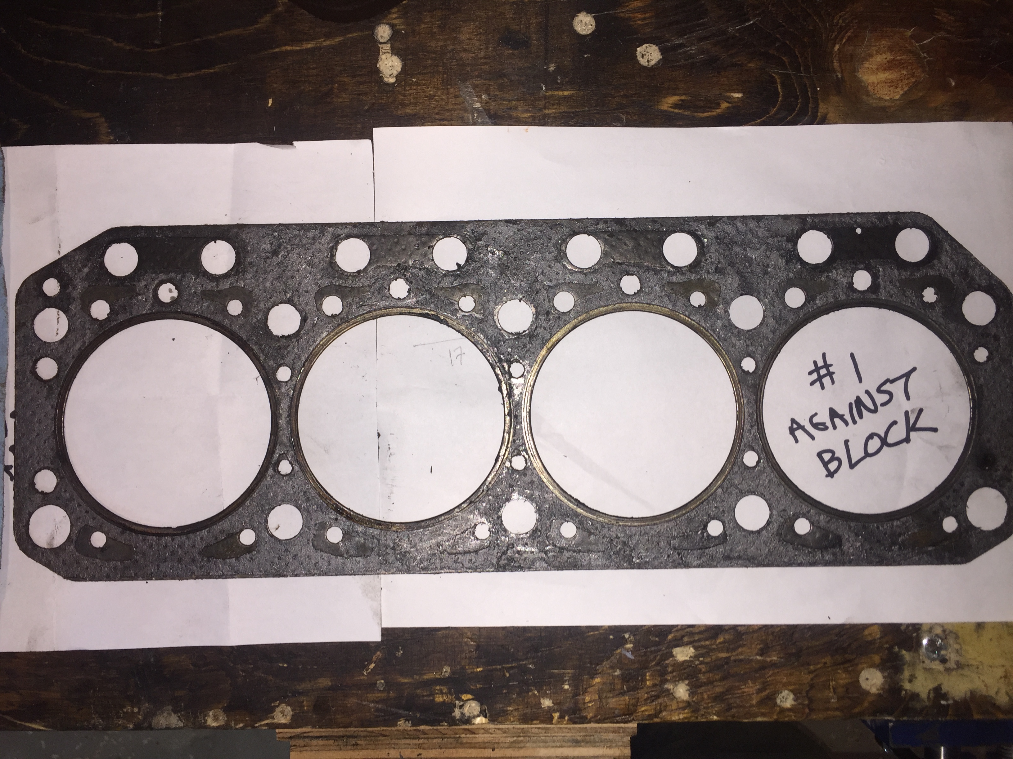

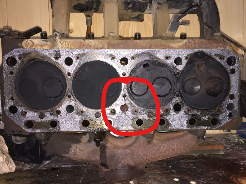

I did not find an obvious blown head gasket. There was a surprise though, a chunk of wire bent at 90 degrees stuck in a water passage between cylinder 2 and 3. i was careful to lift head straight up so I dont think i bent this but the gasket is not marked :

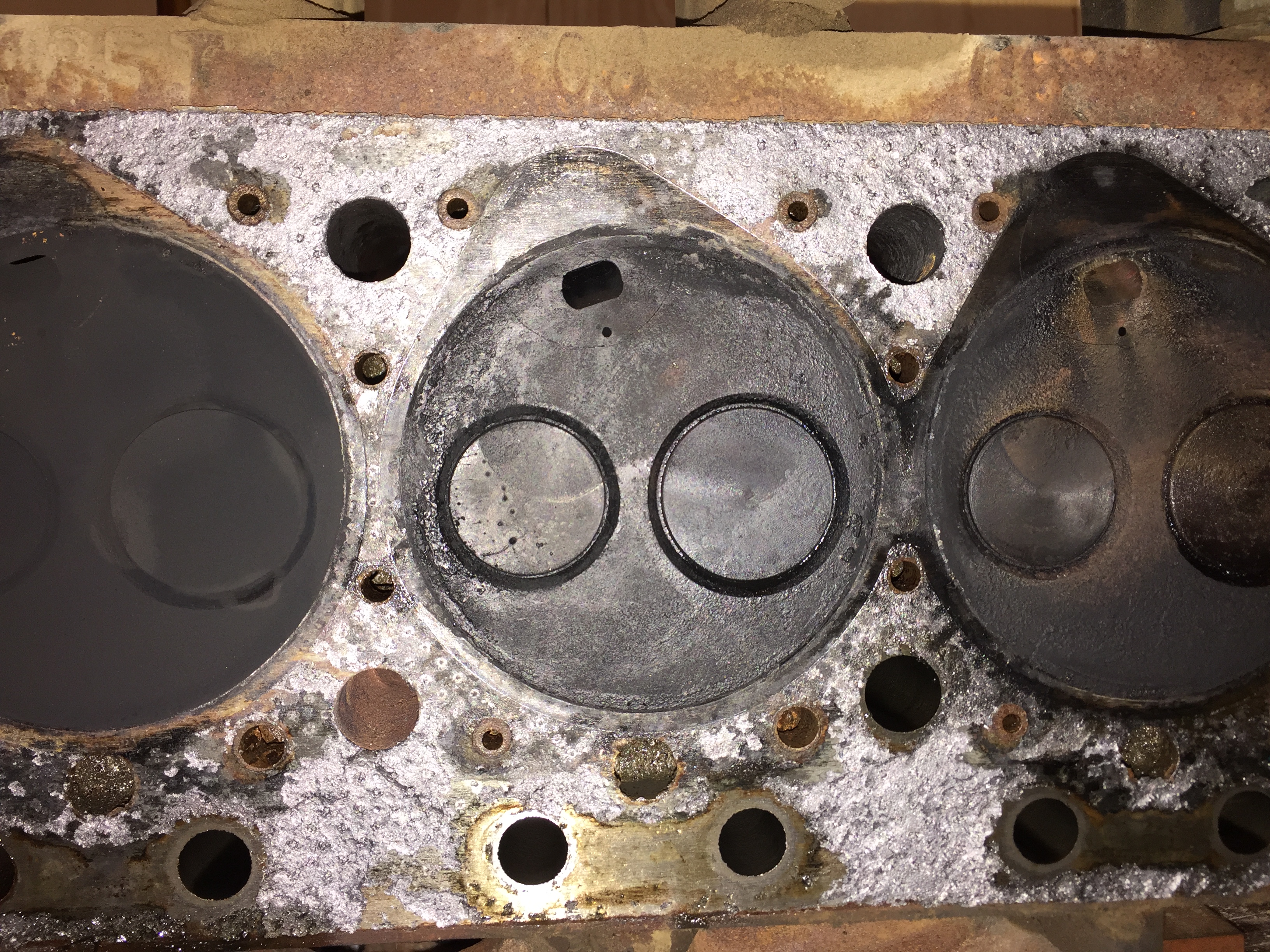

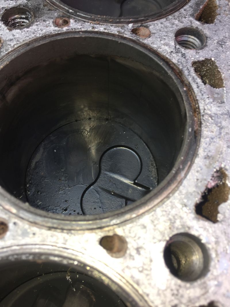

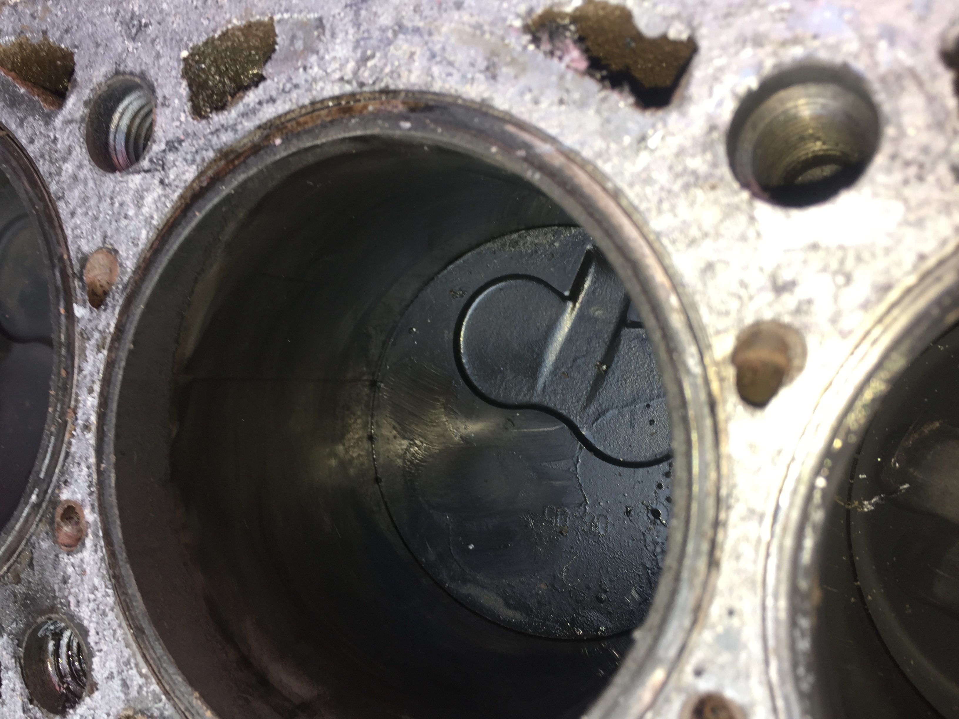

Cylinders 1 and 2 that were firing are dry and sooty. 3 and 4 are greasy sooty. The cylider sleeves sit proud of the block and the head gasket sits on top of the exposed rim. The fire rings between seem OK The seal on 3 beside the found wire is rough and may have pressurized that water passage although there is no sign of water in the cylinder. #3 has 2 vertical scores that almost look like cracks in the photo:
I wont know until I get the block out.
I Sprayed the valve stems with brake cleaner from the top. I get slight wetness seeping through the large valves on #1 and 3
The head bolt beside the suspect spot Had rusted threads. All the rest were oily. The other head bolt at #3 had chowdered threads and may not have been torqued right.

Update: I have pulled the head. I didn't find an obvious head gasket problem but there was a surprise. I found a piece of wire jambed in a water passage between #2 and #3. It appears to have been stuck between the cylinder insert and the gasket. One end rusty and the other carboned black.
The #3 cylinder head had carbon build up at that location and the gasket against the rim of the insert is rough
The head bolt beside this was rusted. The other head bolt at this location had damaged threads and likely was not torqued right.
The gasket surfaces against the head look OK to me. The only bad spot against the block is where that wire was
It appears like a carbon build up between 3 and 4 on the head although the gasket at that location is not burnt.

#3 cylinder has two vertical scores that almost look like cracks in the photo
There's a leak between cylinders I'd say, no other way to get carbon built up in that area.

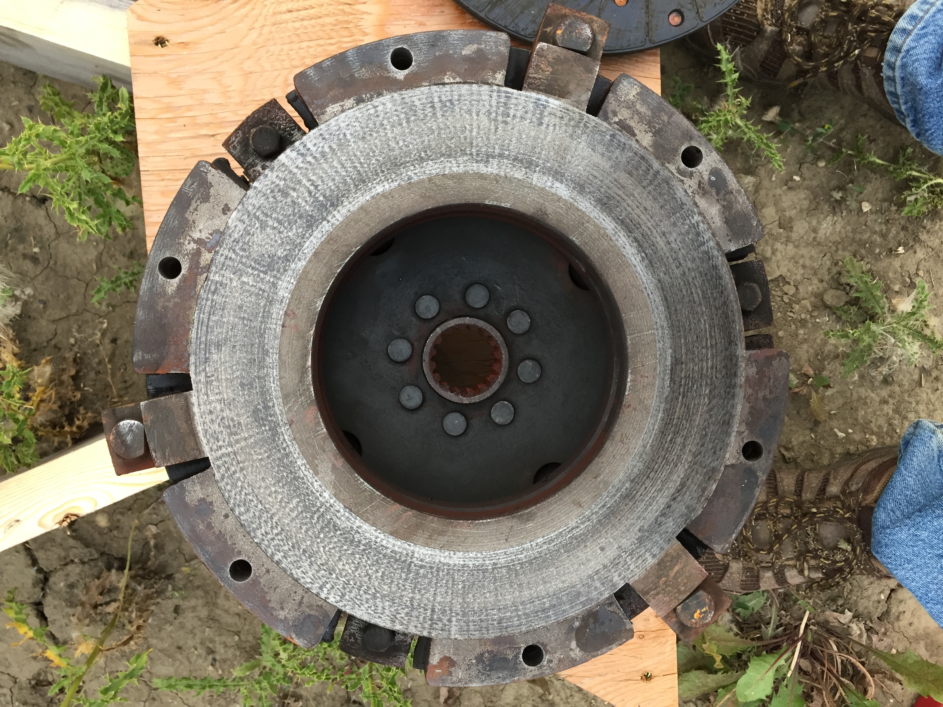

So I am moving forward slowly. I quit overthinking this and towed it to a flat spot, dropped the loader and split it. I blocked the back half stationary and only moved the front with two scaffold planks and a 3 ton floor jack.

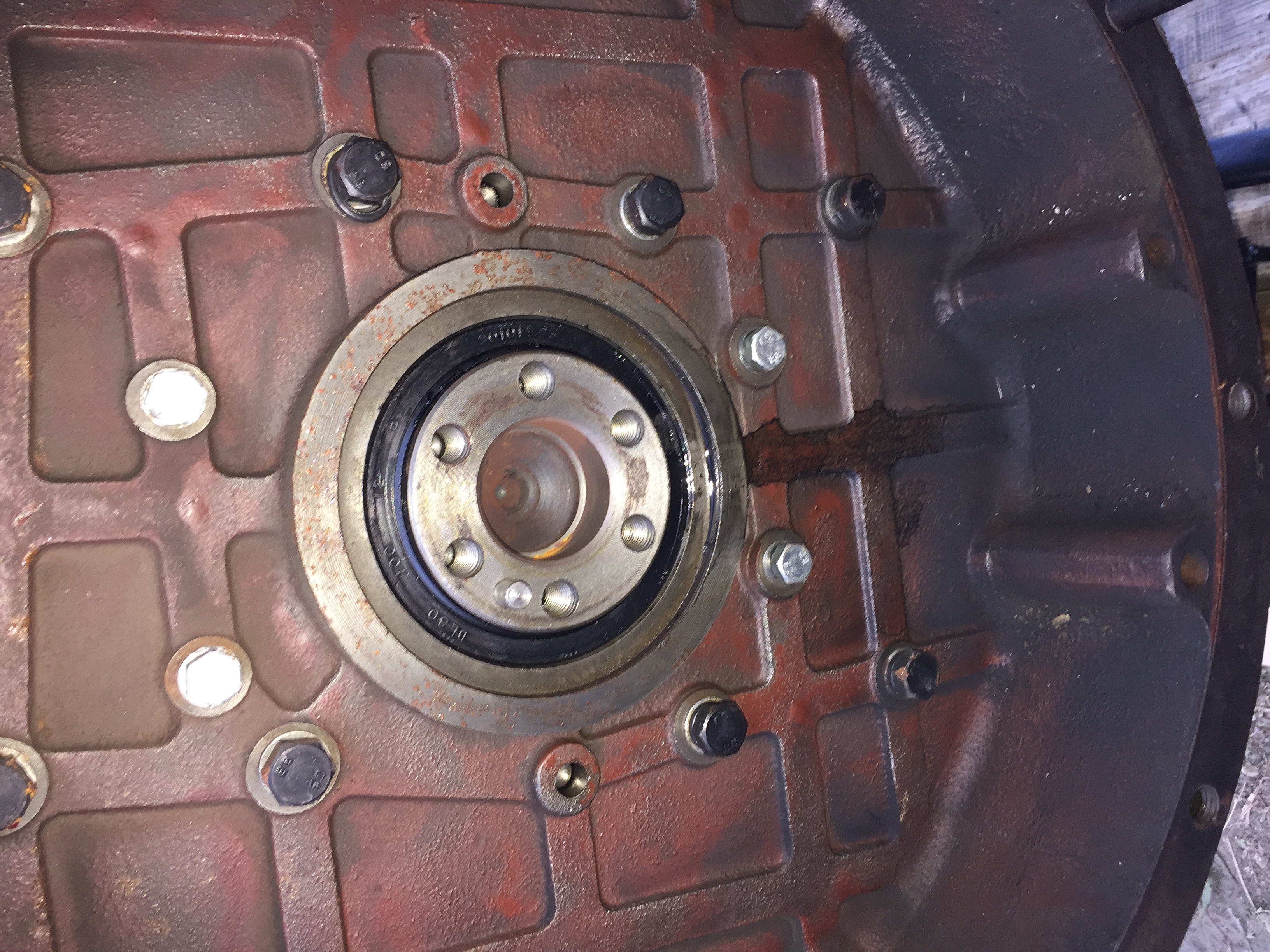

Clutch, flywheel and flywheel cover were bolted on correctly and came off easy. The rear main seal is starting to weep.
The pilot bearing is seized and I had to press it out. (I always found it strange that I grind gears when shifting from R to 1 or 1 to R when sitting still. Pretty sure that the pilot shaft is turning because the bearing isn't). The throw out bearing is tight but dry and rattly sounding. Both these bearings are non lubricated with open races in the rear (I can see the balls, there is no cover). The good news is no leaks on the transmission side.
The flywheel and pressure plates look to be in good shape.
I don't know how to tell how much wear is on the clutch plates. Here is the PTO plate - 9.8mm thick.
How thick is the new one? How thick is a new main clutch friction plate?
Is there any reason why I shouldn't replace the pilot and throw out bearings with sealed lubricated bearings?
The tractor came new with a bag of spare parts. Included is a replacement rear main seal. Given that the original is failing with only 300 hours on it, can I expect that a non-Chinese one would work better?
