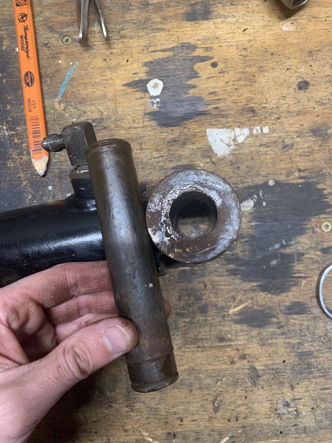

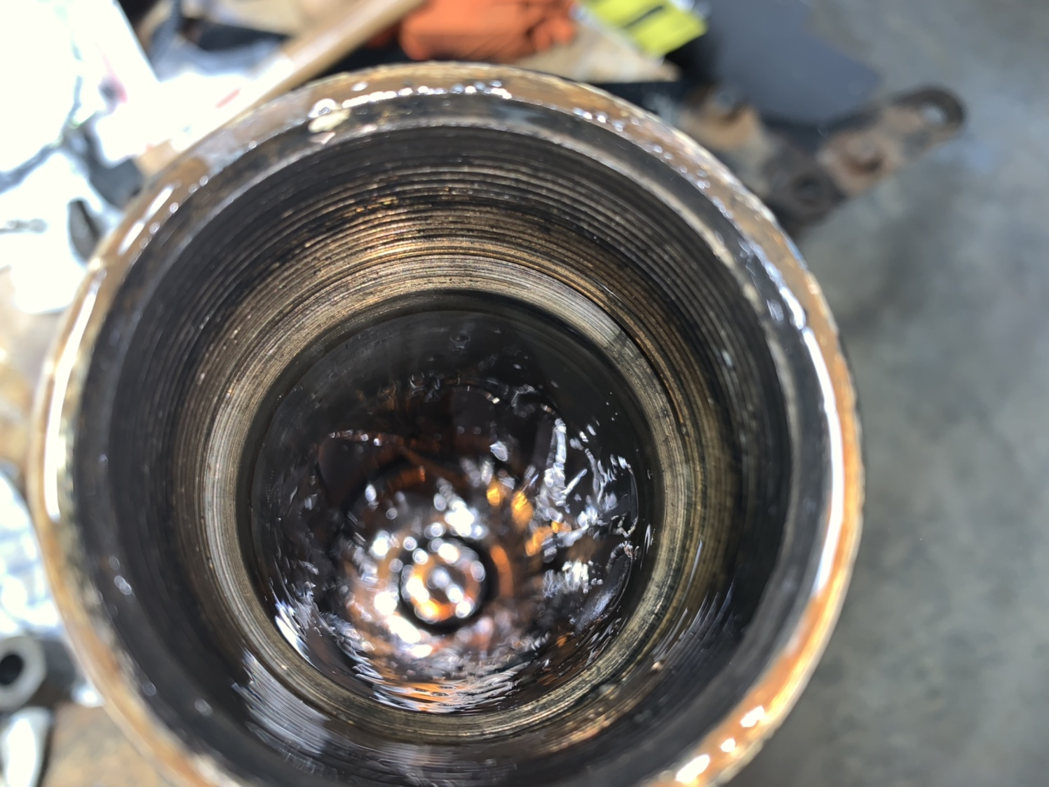

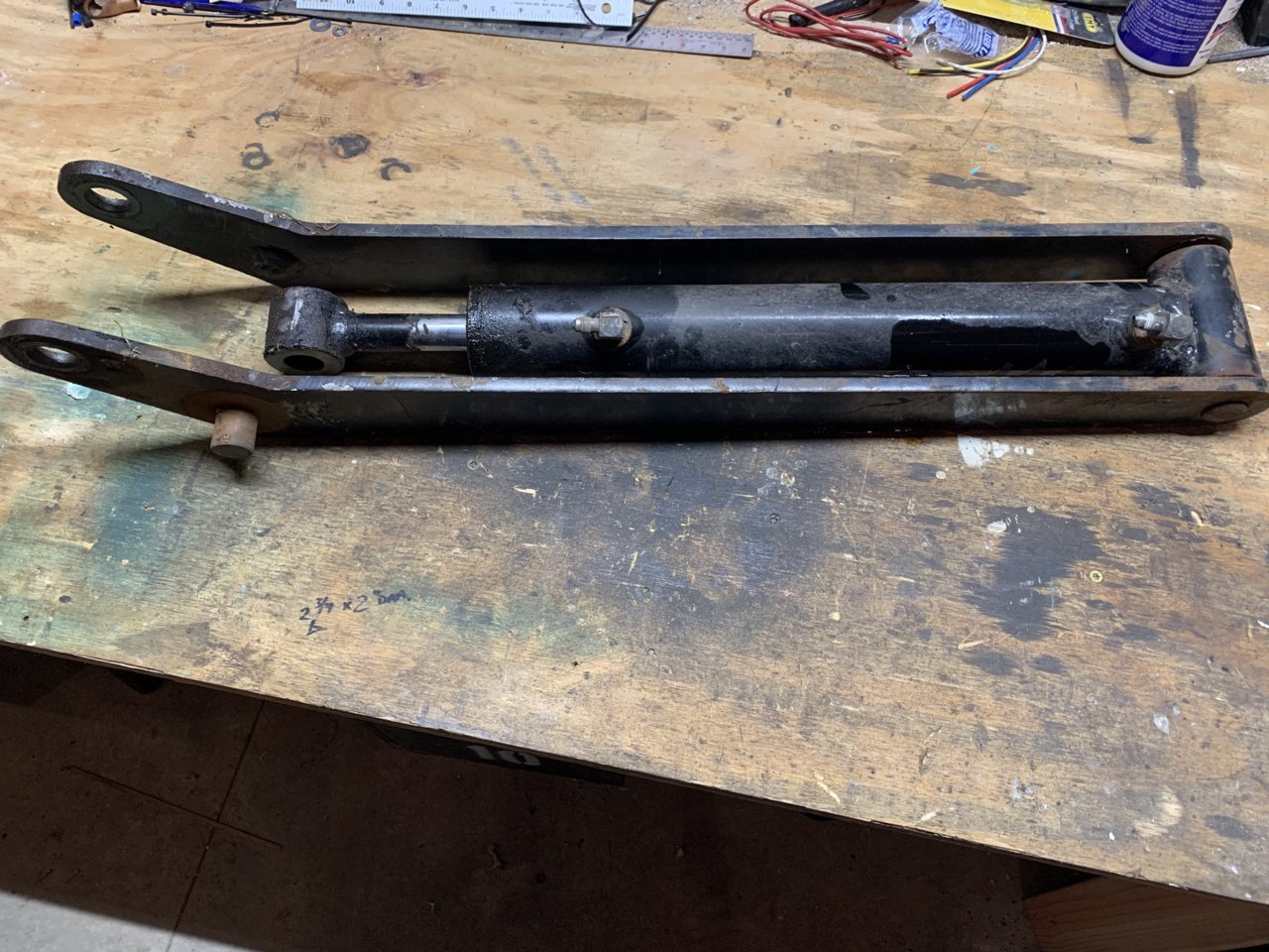

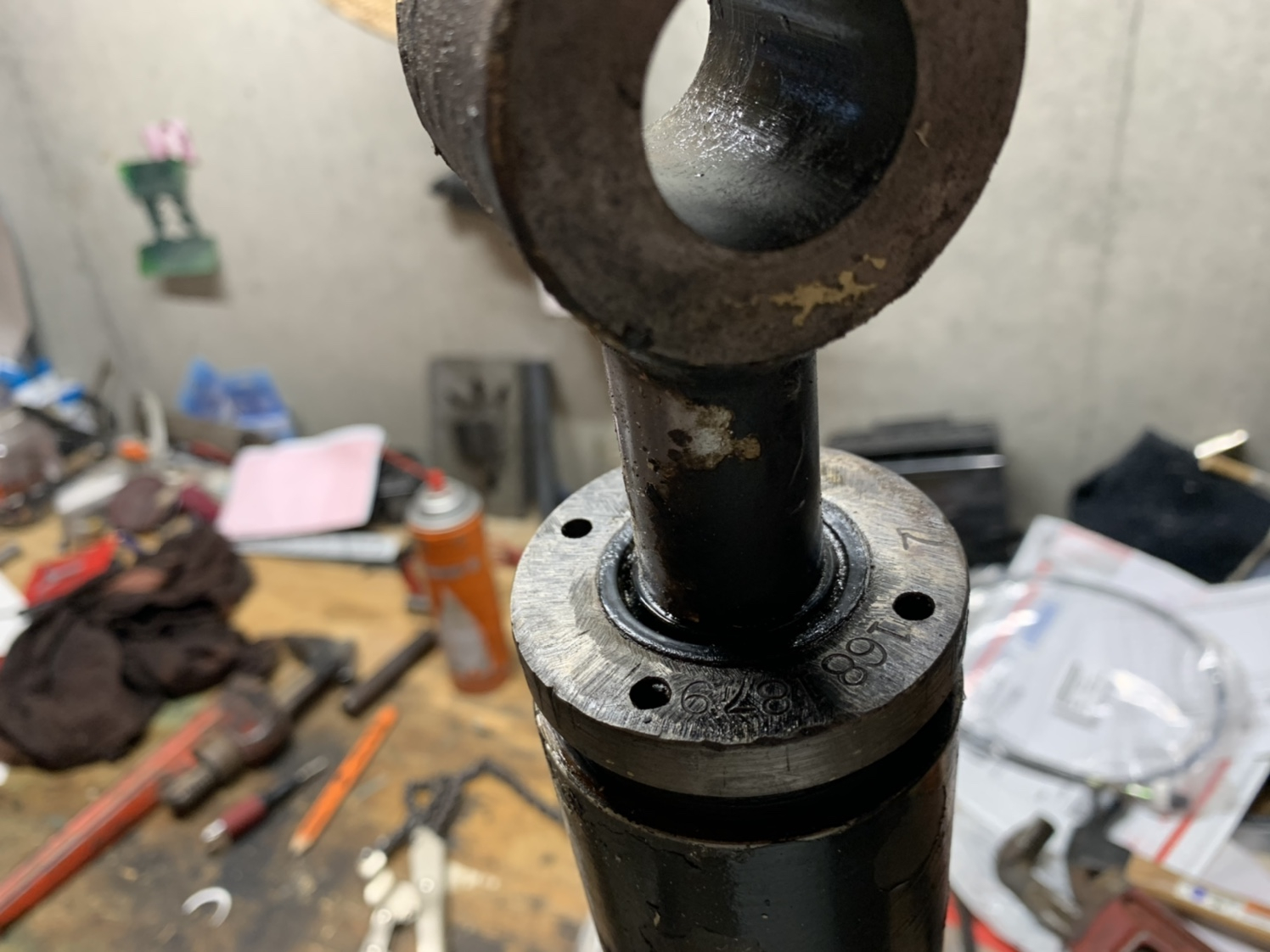

Little more work to the mini skid steer. Got the tilt cylinder removed. Upper pin is seized BADLY. Hopefully it'll come out in the 20T press. I don’t want to mushroom the end.
I’ll put a bit of heat on it to warm it up if need be, after I disassemble it. It’s so worn I can move it with my pinky.

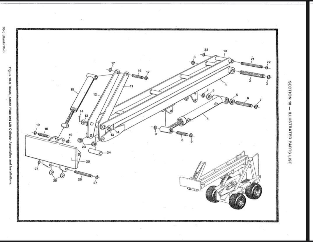

Had to pull the auto-leveling linkage with it, looks like someone failed to remove it before... Ends were a bit mushroomed.
Pic2: Seized. It almost looks like it's part of the cylinder end.
Pic3: Breakdown.
#16 in pic 3 is the pin we're looking at. I had the exact issue with PN #7, it was terribly seized. Took a lot of work to get it out. I'll drill for a grease zerk. Next to be pulled and greased are #2 and #21 as I'm sure they're probably just as seized as these past two.

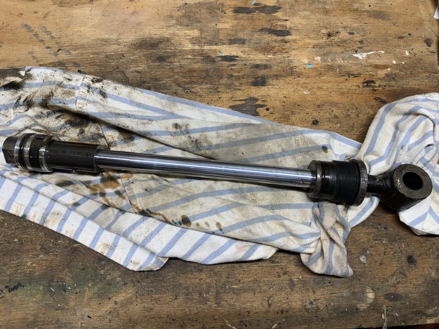

#45
20T press popped the pin after I put my weight into it. Sounded like a shotgun when it let loose. I’ll have to clean up the pin and bore.
Couldn’t get gland nut off at first, 36” pipe wrench with a cheater bar and my 150lbs on it cracked it loose.
Next, repack the cylinder and reinstall.
Looks weird in the pic but it’s an illusion. Looks great in person.

Forgot the pic of the pin that popped like a shotgun:
If this isn’t the poster child for “install a grease fitting!!!”

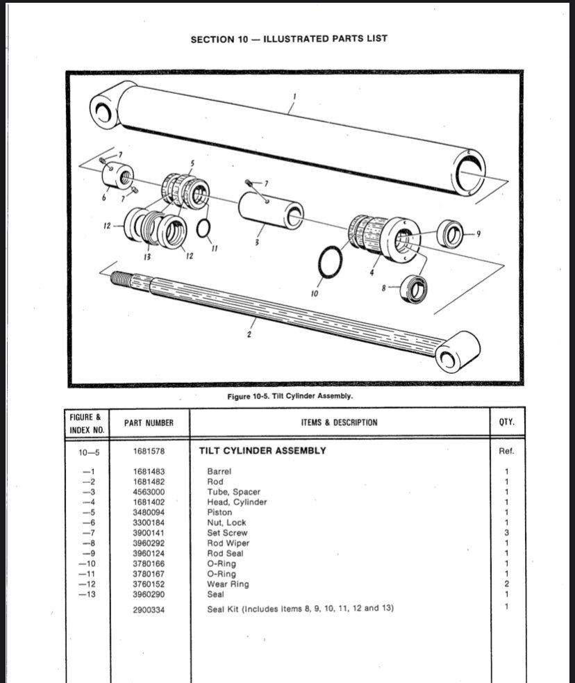

So I went to rebuild this cylinder (tilt/curl) two nights ago, it seems like the parts kit is incorrect. Maybe JLG recycled the part number or something. First kit was perfect, lift cylinder is strong as it should be. The tilt/curl is weak, really needs a rebuild. I'll have to bring it to a hydraulic shop to match up the seals.
