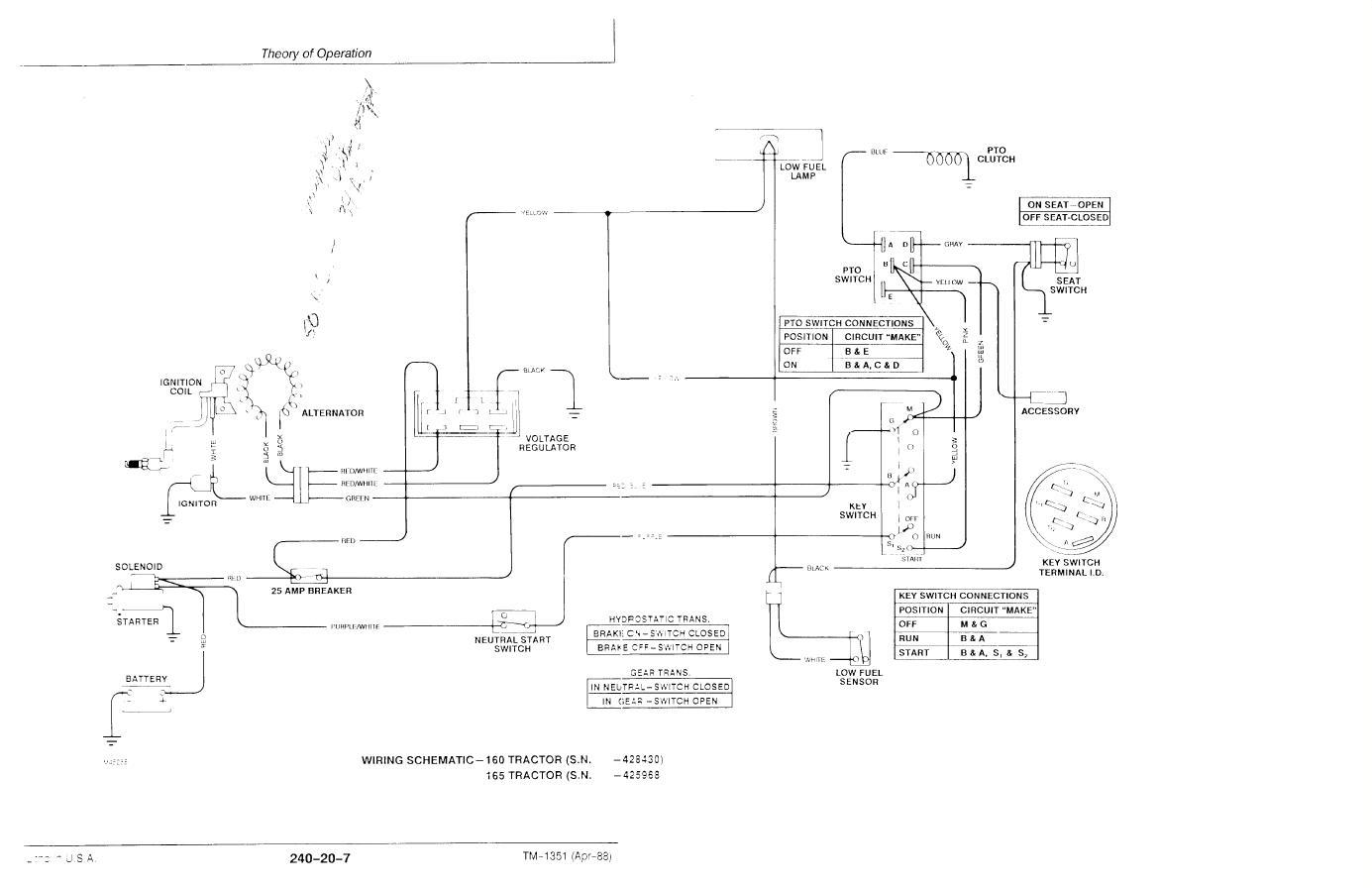

I have an 86 JD 160 lawn and garden tractor. I was cutting grass with it when all of a sudden the blades quit mowing, out of the blue. Could not get it to work for anything, so I turned the machine off.
Now the machine won't turn over, as though the battery is completely dead. I was not having problems with the battery at all, and the connections are clean and tight everywhere.
I'm starting to suspect my entire ignition switch could have gone out. Is it possible the switch going out could have also affected electrical power going to the electric clutch?

I imagine it's all ran through the key, so if the key is shut off while your mowing, obviously it would kill power to the electric clutch. I've noticed on mowers virtually everything is run through the key in some way or another, usually to prevent any accidental drainage issues.
You could always grab a test light or a multi-meter and turn the key, see if power is coming to the key switch first, and then see if power is leaving the key switch, test each terminal leaving the key switch individually, maybe some have power and others do not.

Took a multi-meter and tested the ignition switch. It appeared to have problems, was definitely very iffy on contact between start and run, so I decided to replace it.
Called up the John Deere dealer and they had it in the next morning.
However, that apparently was not the problem, tractor still will not do anything. Not a big deal, the switch was only $18. Getting late in the day, so I guess I will have to try tracing more circuits. I'm starting to suspect the voltage regulator.

Hi again everyone. We've had a lot of rain the past couple weeks, so I have not had time to deal with my electrical problem.
Today I went out and we traced the circuits. I know that there is power getting to the 25 amp breaker in between the ignition switch and the starter solenoid. The power is getting to the starter solenoid, we checked it right at the connection. However, nothing happens when I press the clutch in and turn the switch.
So, we disconnected the wiring harness at the voltage regulator, I turned the switch on, pressed the clutch, and the starter engages, turning the engine over. However, the engine didn't crank, and I believe that is because there is no power getting to the ignition coil since the voltage regulator is the only thing that completes that circuit. So I am guessing that my voltage regulator has an internal short that prevents any power from getting to the starter solenoid and the ignition coil when I turn the key.
I am not an electrician, so I'm pretty much taking a halfway educated guess here.
I am attaching an electrical schematic, can anyone tell me if my thinking is wrong?
Thanks in advance for any help.
LC

The ignition coil will never have power going to it on that style. If you apply power to it, you could destroy it. Please tell me you shut the deck switch back off before trying to start. If not, do so and it should start. Next, if the deck quit, and then it wouldn't start, I would suspect the pto switch. The safety start system runs through it so that you cannot start the engine with the deck running.

I would agree with the pot switch, or seat switch
/ John Deere 160 - stopped cutting #10
Also if the connector on the key switch is burnt or on the back of the pot switch is burnt or melted that could be the problem also
/ John Deere 160 - stopped cutting #11
I will look at a wiring diagram today if I get a free minute. The seat switch will not keep it from starting. It comes into the circuit after the brake/clutch switch is released.

How many and what color wires are going to what you call the voltage regulator? Do you have power coming into the small purple wire at the starter solonoid with everything hooked up?
#13
There are 5 wires on the plug to the voltage regulator. 1 red, 1 yellow, 1 black, 2 red w/ white stripes.
There is power going to the purple wire on the solenoid when I attempt to start it. So, I took out the spark plug, hooked it up again and turned the engine over. I could not see any spark coming from the plug.

Just to let you know, I didn't see a clutch or brake switch in the circuit, that mower is from the 80, most of them didn't have brake switches, just a hydro neutral switch.
/ John Deere 160 - stopped cutting #15
Ok, so a no spark issue. Pull the engine shroud off. Remove the single wire going to the ignition coil. With the spark plug out as before, but hooked up, crank the engine over and see if there is spark. Yes, then either the ignitor is bad or the wire going to the coil is grounded somewhere. No spark would mean either a bad coil or a badly rusted or missing flywheel magnet. I am leaning towards the grounded wire since it sounds like there were some other possible wiring problems that started this.
This problem is getting more and more curious.
I took the shroud off, before going on to the ignition coil I decided to check the spark again. Darn thing cranked right up. Rode it around, the PTO switch came on, seemed to be working fine. Everything is great now, right?
Wrong. I went out this morning to crank it up, and after a couple minutes of very hard starting it cranks up. I revved it up a little bit to check it out, and after about 15 seconds it dies out. Now it won't crank unless the throttle is as far down as possible at idle. When I try to rev, it dies. Immediately. I crank it up again and it will only idle, any attempt to give it any more fuel causes it to die.
The fuel pump appears to be pumping fuel. I cleaned the carb thoroughly, I assume it is working properly, but not sure. I'm still suspecting some kind of electrical problem but I am really stumped.
