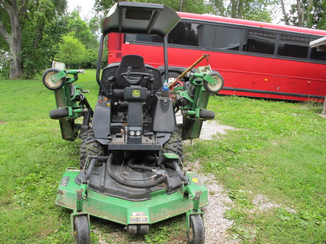

While it was down I put new tires on it and I really like them a lot better. Went as big as I could. Also decided to go ahead with doing something about the operator heat problem. Anyone with a 1600T knows exactly what I'm talking about, the radiator fan blows all the hot air up under the operators platform where it proceeds to convection bake you while you mow. Enough is enough. Why JD didn't see that coming I'll never know. Why they haven't fixed it is even stranger. So, first photo is just the mower front view. Nothing much to see here. New tires, guarded toggle switch in the aux light switch hole for the fan.

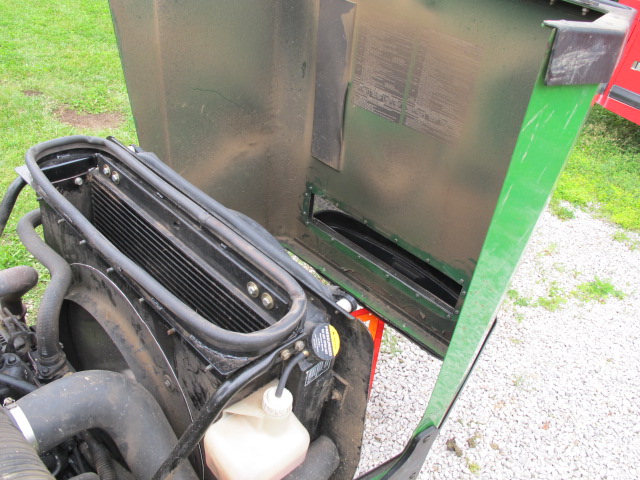

Here's the magic. Old fan removed and blocked off, new opening to the inlet screen.

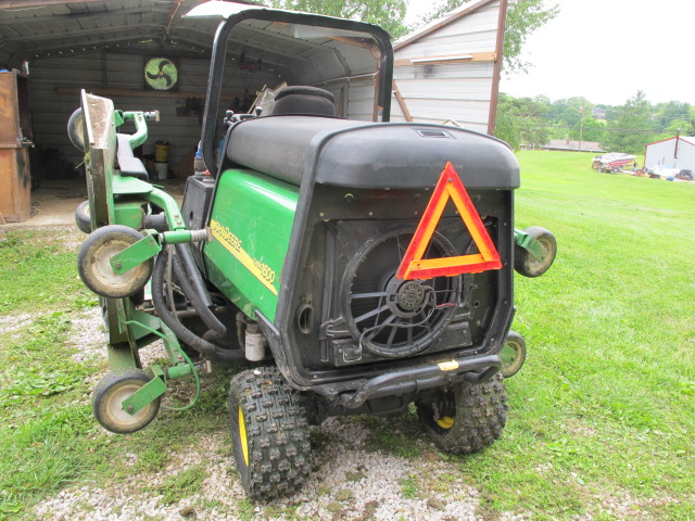

And last, the new electric fan This one is out of a Lincoln Town car, is 17-1/2" diameter at the tips of the blades and has a 2 speed motor which I run on high.
I've run it a couple times now and the motor runs a bit warmer but I was a LOT cooler. Practically like having A/C by comparison. The fan could be a little larger. The first one I tried was an 18-1/2" fan out of a Volvo SC90 but it has a very fancy motor that has to have some sort of PWM signal before it will run. Big heavy cables too so that most likely means an alternator upgrade is required. Easy enough, I have one or two new reman spares (GM) that should work fine.
Anyway, I think up to a 21" fan might fit so if anyone has information about a good candidate, like maybe something salvaged off a piece of industrial equipment I'd sure like to try it. Before the conversion temps ran 160 steady. Now it continues to creep up and looks like it is stabilizing right at about 210-215 but it isn't hot weather yet. Cools right down if I cut to idle and switch off the decks, so just a little more airflow should do it.
