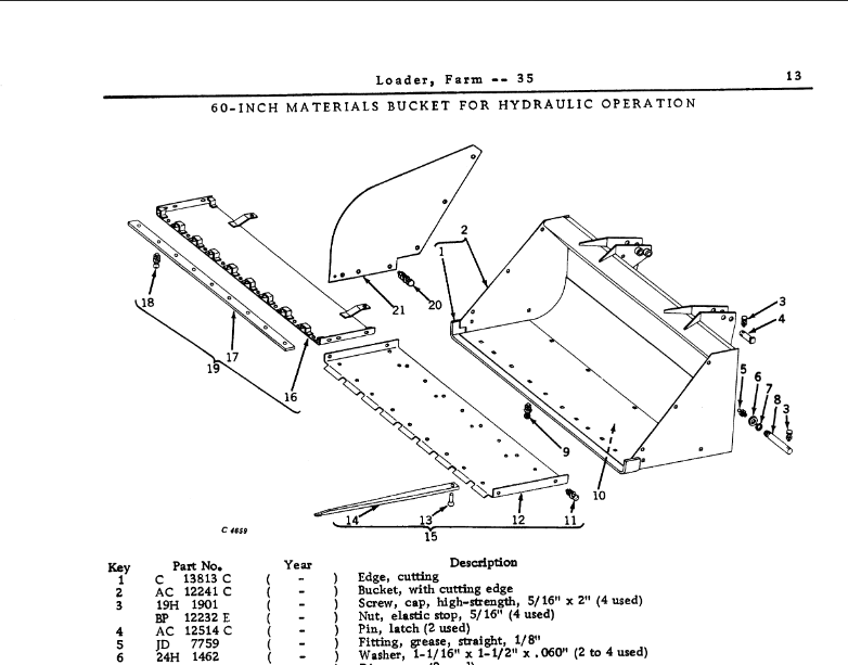

I have an old model 35 series 1 front end loader . I am guessing 1961 because of the year of the tractor . What buckets will fit on this ? It has a manure bucket on it I am thinking a regular bucket would be nice to have.
   / John Deere 2010 Bad?? #35
It wouldn't surprise me if a materials bucket that will fit your model 35 FEL is very easy to locate.

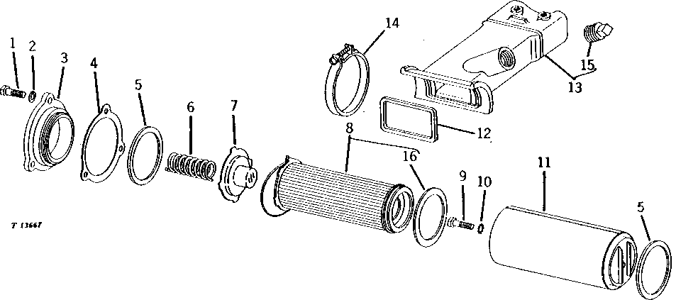

Still loving my 2010 however I have noticed the hydraulics have slowed a bit when cold in the am. I am wondering what I should be looking for when it might be time to change hydraulic filter ? where can get one ? where is it located in the tractor ? how do I change it. I want to repack the bucket cylinders over the winter and change this filter also.
   / John Deere 2010 Bad?? #38
Actually the 2010 doesn't have a filter but a screen. One can access the screen from the RH side below the footrest by removing the cap held in place by 3 bolts. Clean the screen with solvents & compressed air. Stand screen up with open end up in a clean bucket then pour hyd oil inside of screen & if oil readily penetrates screen it should be clean.
