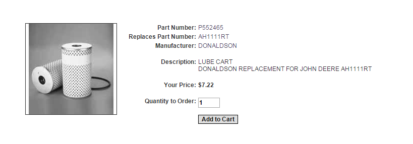

Where is a good source of parts and where can I get a repair manual? I will need a engine oil filter unless that is a mesh also ?
   / John Deere 2010 Bad?? #46
IIRC engine oil filter part number is AH1111RT and should be available many places
