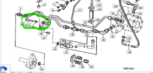

Thank you for your response. The check valve I put in was brand new. The old one had a broken spring, so I do not think it has been working properly ever since I bought the tractor three years ago. The new check valve made the hydraulics shutter even worse than it did before with the broken spring check valve. I got on this forum because I want to use the check valve if possible. But I also want the tractors hydraulics to work properly and not be under a strain all the time. A catch 22 as far as I can tell right now.
Thanks again for your advice, I agree. Leaking back was my major concern!

When you have the optional HI/LO or Reverser transmission, JD does NOT install inlet check valve.
I am not sure how much oil could flow back through a gear pump. The transmission pump is a gear pump.

Zebrafive - Thank you ! Very interesting comment. The transmission pump supplies oil to the gears and the front hydraulic pump. If the oil will not go through the transmission pump gears, I wonder if it can go out where it lubricates the actual transmission gears?
I also think I may be ok because the supply line is higher at one point than the hydraulic pump up front. Because of the high point in the line, even if it leaks back some, there still should be enough oil left in the hydraulic pump up front to be just fine. Any way, that is my thought to this point. I would put the check valve back in real quick, except for the fact that the tractor runs so much better without it. The tractor is so much quieter than it was, I could hardly believe it. I plan on monitoring all this real close for a few months. I also plan updating everyone with my results. Thanks to everyone for giving input! Jimmy in Texas

I'm by no means an expert on this system, but my feeling is that Mother Deere didn't put that check valve in there just so people could guess at it's purpose. I would suspect that without it, over a long enough period of time, much of the fluid in both the surge tank and even the pump could eventually drain back into the filter and transmission pump circuit leaving the pump relatively empty. On startup in this condition it could take a while for that fluid to made up so the hydraulics and steering will function. Would that happen overnight? Probably not, but after a few days/weeks of non use it might show up. I'm not saying there isn't a problem of some sort with your check valve, but it would seem to me repairing or replacing it might be a better alternative to tossing it under the bench.
Hey Harry in Ky, I found someone that thought that the check valve was in case of a surge back pressure. Any thoughts on back pressure? He thought I might blow some seals out if I left the check valve out. I am going to look at the schematic to see what seals he is talking about. Anyway, I thought you might find this interesting. Jimmy

I think presence or absence of this low pressure(155-165 psi) check valve will have little affect on whether a hyd seal fails. May I ask where this info originated?

Personally, I have never seen a check valve such as you described on any of the tractors I've worked on. Maybe I just never noticed, or never had occasion to get into whatever component contains one. I'm not sure if you mentioned where in the system it's located.
Check valve is designed to be located in hyd oil supply line from trans pump to frt pump.

Correct, this the check valve we are talking about, and he removed. I posted earlier JD does not install this check valve when HI/LO or Reverser transmission is installed.
