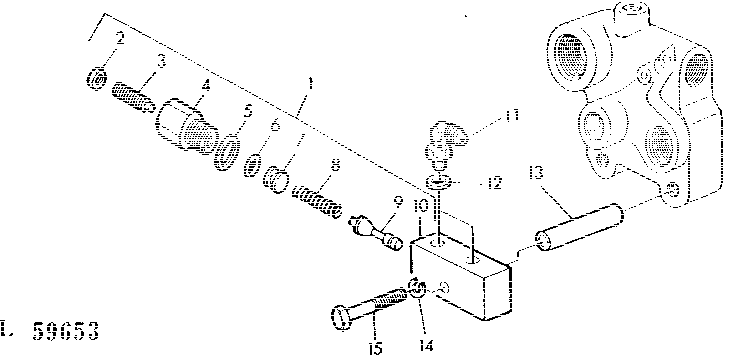

I would also suggest to check to be sure this pressure relief valve is seating properly. I'd also suggest to check system psi.
