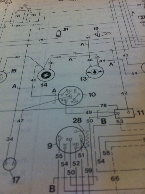

Sorry i was a little late about answering your questions, but we've owned it for probably 20 years. Its sat outside since we've owned it. Im going to drive it for my first time probably some time this month. The person who's always operated it was a good family friend.
But the reason it will need to be hotwired is because for some VERY mysterious reason, where the ignition/key is, all the wires are unpluged? and i have not been able to find a diagram as to how they get plugged back in and the manual is pretty much useless for that. So, i don't really hotwire it, i put a screwdriver on 2 different nuts on the starter and that starts it.
/ John Deere 2040 review/help
Oh ya, and i do have the keys for it, but theyre useless without all the wires being plugged in.

I wouldn't think there would be that many wires going to/from ign switch on a 2040.
hot wire from battery attaches to "B" post
wire going to starter solenoid attaches to "S" post
wire going to dash lights/gauges attaches to "I" post
/ John Deere 2040 review/help #8
Ok #10 in the middle of the pic is the key switch. Wire #46 is red 16 gauge coming from the alternator indicator light. Wire 47 is black 14 gauge and goes to the starter/safety switch. Wire 49 is red 16gauge and goes to the circuit breaker/ light switch. I assume G is your ground and IGN is the ignition. Hope this helps. Keep us posted!

Thanks for the diagram, but its not what im needing. Im talking DIRECTLY where the key goes in, but on the other side of the dashboard.
/ John Deere 2040 review/help #11
Hmm I'm pretty sure #10 on the diagram is what the key goes directly into, not sure what you mean? Maybe you were looking at #9 below it which is the light switch?
