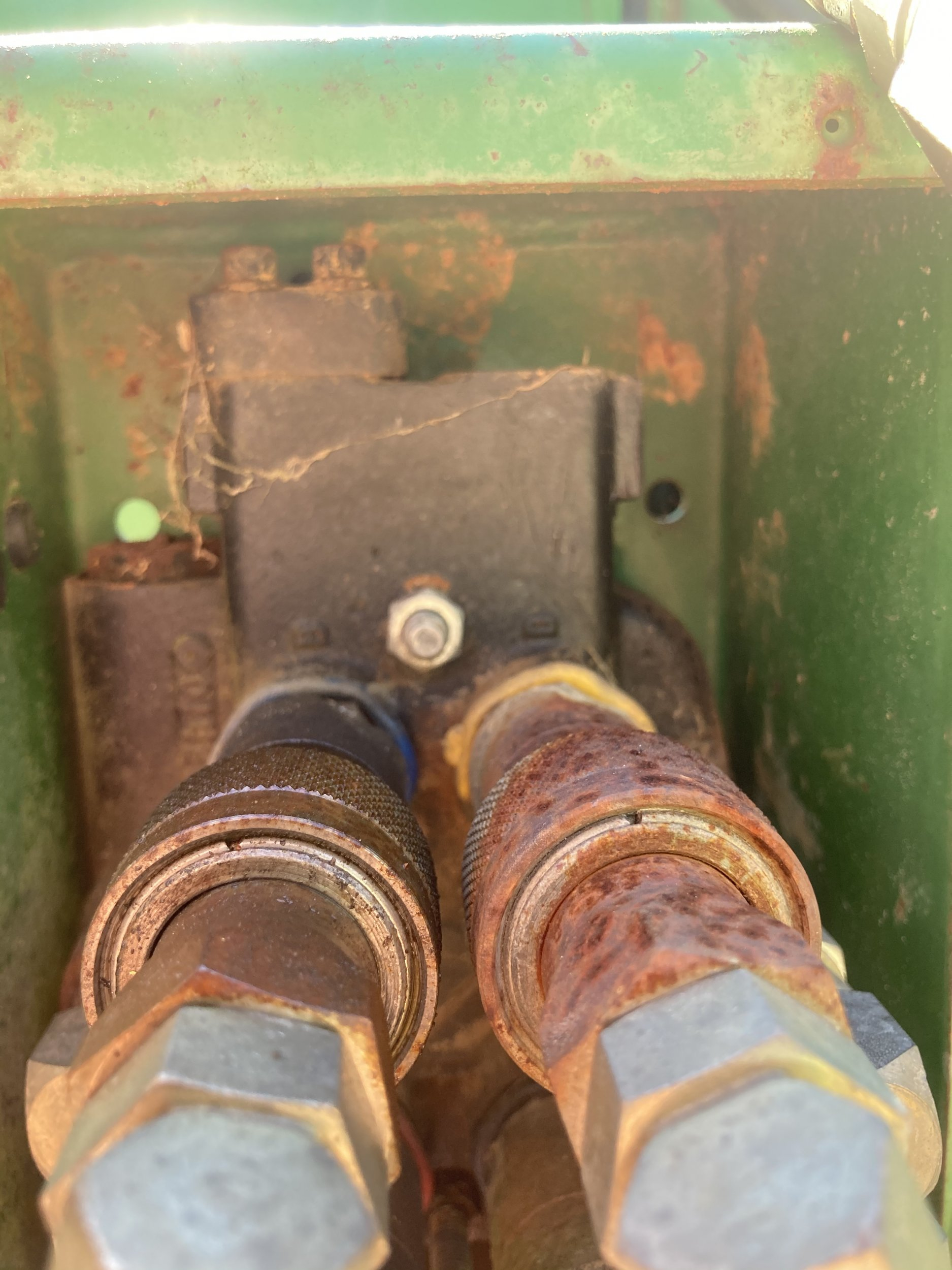

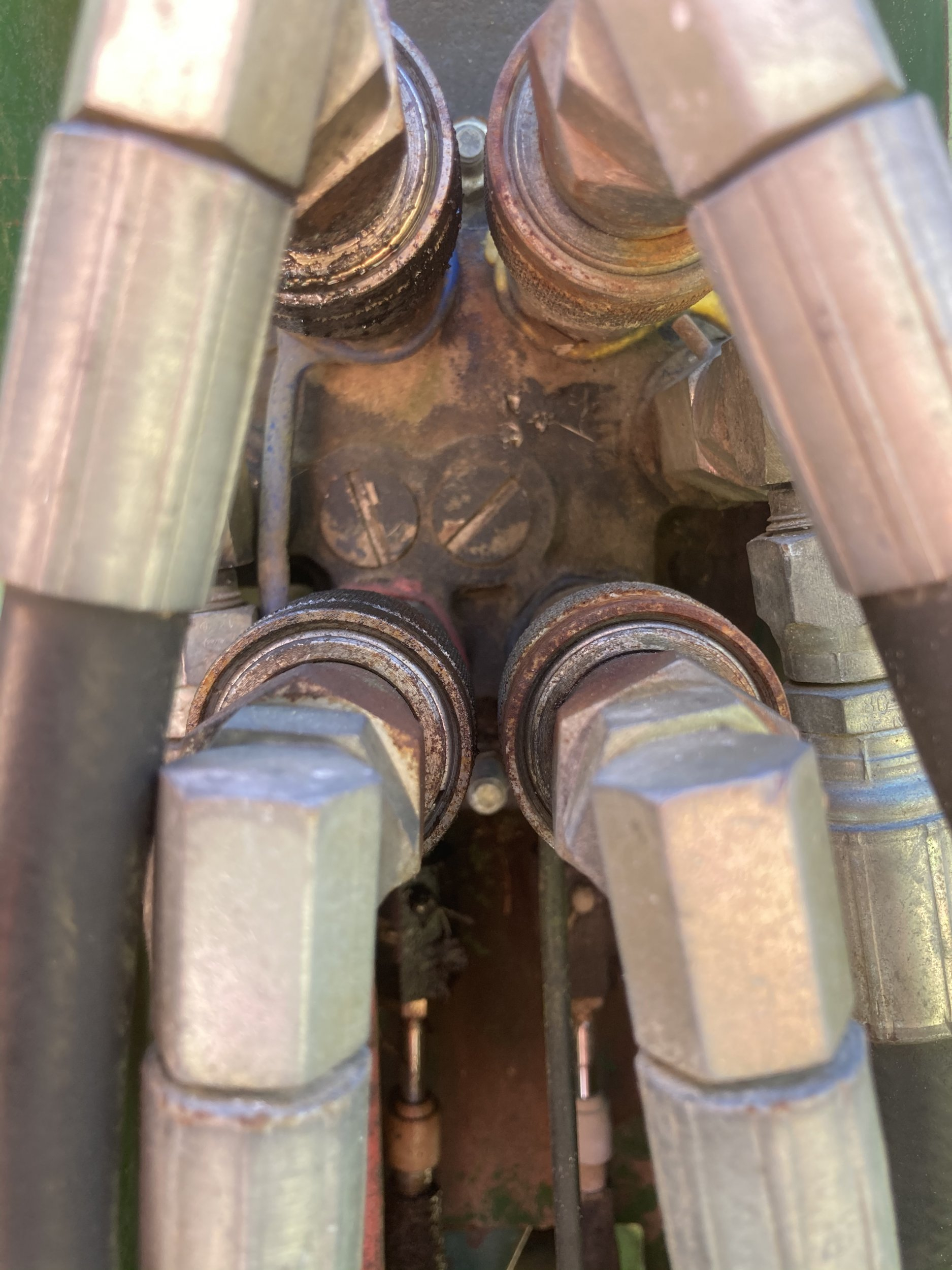

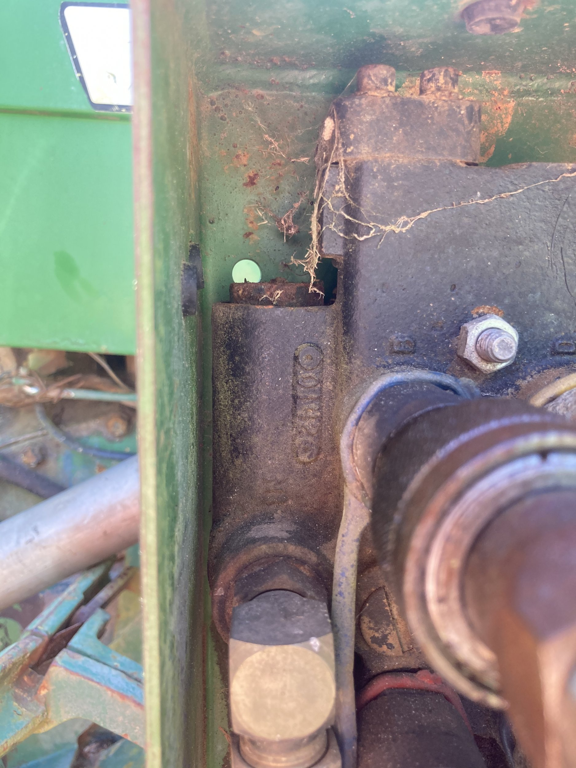

Your tractor has closed center hyd's. I think FEL control valve is open center OR if FEL valve has a relief valve it's not holding 2250 psi. Don't give up on tractor at this time. Can you please post photo of FEL control valve & photos of how hoses are attached to tractor hyd system?
These are the only pictures I have at the moment. I’ll get better ones tomorrow evening when I am back out there. It sprung a leak from one of the hoses yesterday so it’s going to be down until I get that replaced anyhow.

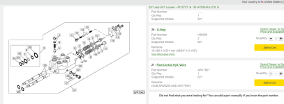

I can't determine for sure from photos but the hyd valve in photo I think is a closed-center valve. A better photo of valve & knowing how valve is connected to tractor hyd system is important.
Simple test: disconnect FEL hyd valve return hose from tractor, cap that fitting on tractor. With FEL control lever in neutral start engine, aim open hose in open hyd filler hole behind seat & no oil should escape open FEL control valve return hose. I think CC valve in photo is what you have.

TxJim, I think it's an open center valve. Key 21 is where another hose would connect. I am not sure if that is the "tank/return" hose or PB (power beyond) hose that connects there. I am guessing it has plug in it.
I do not know if there is a special cc conversion plug for this port.
Your test of disconnecting the return hose would confirm if OC or CC.
