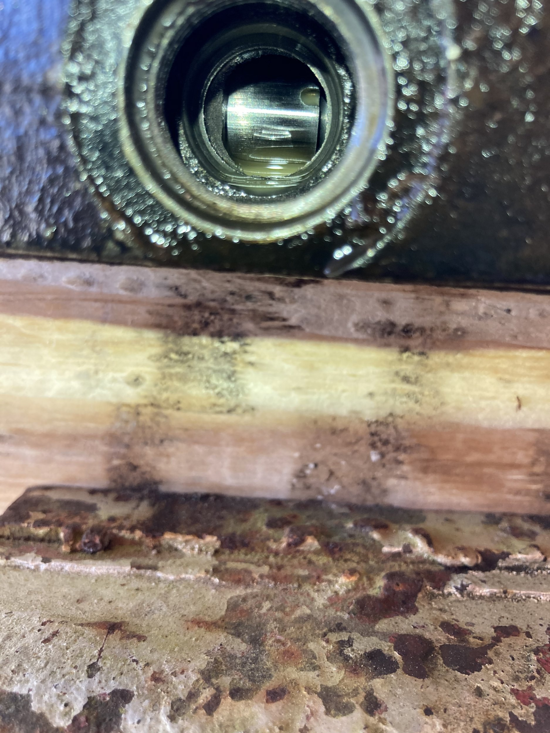

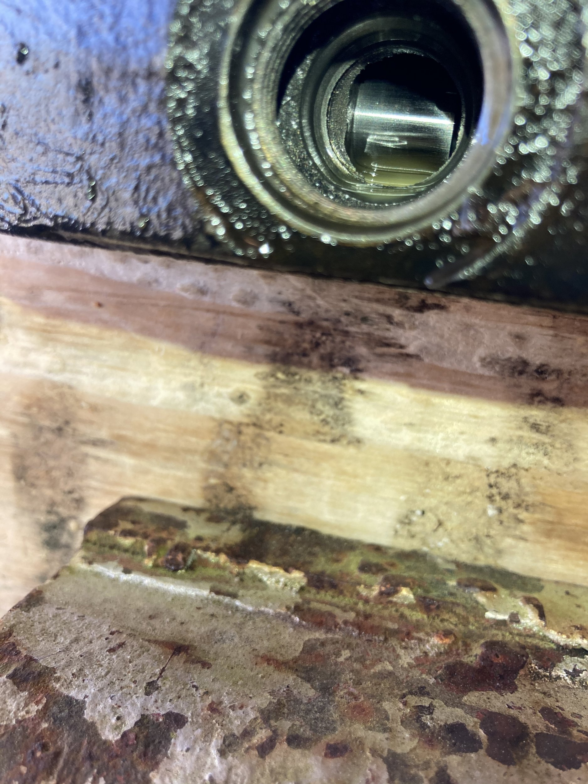

Tx Jim, I think you are right - I think I see a seat in there. See pictures and let me know what you think.

   / John Deere 2040 with Open Center valve on FEL #74
Yes sir I think a closed center conversion plug with correct inner seal will correct your tractors hyd problem. I found that fact out the ""hard way"' back in the 70's when I served as a JD dealer service manager

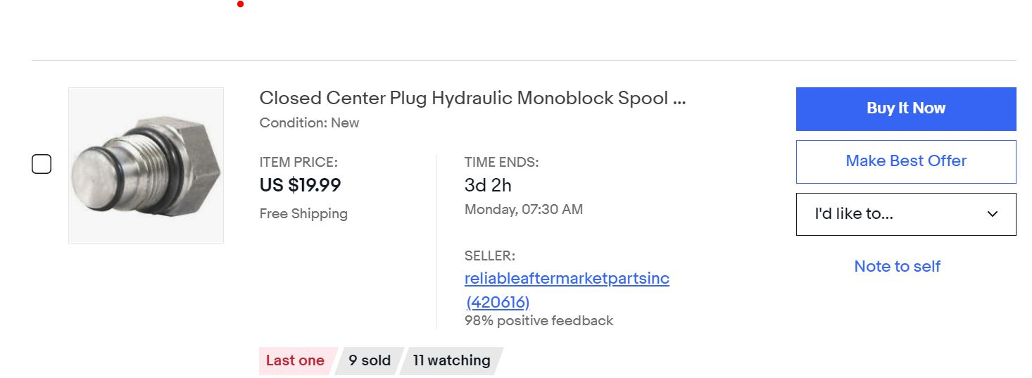

Thank you much to you guys. I’ve ordered the correct part (I hope) online, and will be waiting for it to come in. I’ll update when it gets here and I try it out. Looks like some time to spend cleaning this thing up and re-plumbing the mess that is these hydraulics...

Update time.... I purchased the cc conversion plug on eBay and it arrived yesterday so I installed to test, and it did not work.
I'll pull it all down again next week, when my new hydraulic filters come in and I can change the oil (hopefully getting rid of the last of the water) and see what I can see.
   / John Deere 2040 with Open Center valve on FEL #78
Did the seller replace the OC plug P/N AW17949? Seeing it might show how CC plug should be made.
At this point I'd probably buy a replacement CC valve.
