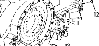

On your tractor JD engineers elected to call the valve in question the flow control valve but on older models same valve is called pressure or priority valve.. You can get a 5000# gauge from Surplus center.

That means the cab needs to come off
Cab has to come off for what reason. RS certainly doesn't require removal not to R&R or service flow(pressure) control valve

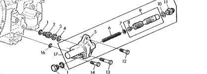

Pressure control valve should be ok since loader is working ok. Unless of course loader valve is plumbed in a manner different than factory recommendation. Pressure control valve provides priority oil to steering system. Loader, rockshaft, and scv's get oil after steering.

jd110
It's been too many yrs since I was a service manager and I don't have access to utility tractor TM & I don't remember the answer to this question. Is it not possible for valve(key 9) in previous posted photo to block orifice in trans case leading to rockshaft but not block orifice leading to scv/fel orifice?

According to my shop manual, the flow control valve is in the passenger side of the rockshaft housing. Picked up a pressure gauge last night.

Got access to the plug for the flow control valve, gonna need to use a magnet to et it out, what am I looking for to determine if its bad or not?
