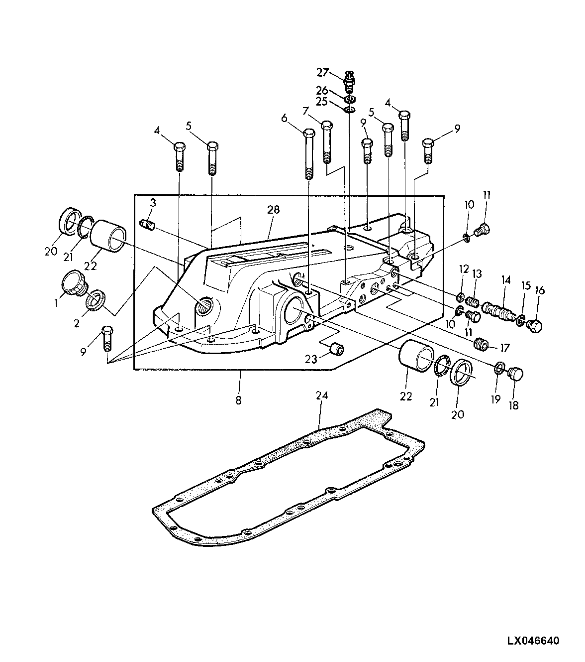

I can push the valve in with my finger, and it returns by the spring pressure, but I don't know how much spring pressure there should be, in my mind the spring should push the valve out of the hole and it should require a little bit of effort pushing on the valve with the plug to get the plug threaded, if you know what I mean.
   / John Deere 2750 3pt won't lift
#26
LX046640_______UN11MAR05.gifLX046640_______UN11MAR05.gifThis is what my manual is Calling the flow control from valve, part #14.
But when I look it up on the John Deere parts website, it's showing the flow control valve as being down near the Hydraulic filter.
   / John Deere 2750 3pt won't lift #27
I'm sorry for confusing you but Jd added that valve on later utility tractors and I was unaware of it until now, The valve in photo down on RH side of trans case by hyd filter is the one I was referring to.

OK, problem. Is I've also got that housing down on the side of transmission, so there is a flow control valve down there, and that's what the John Deere parts website lists as the flow control valve. So which one should I be looking at?
   / John Deere 2750 3pt won't lift #29
1st remove spool valve in your photo,install plug,start engine & see if 3 pt raises.
