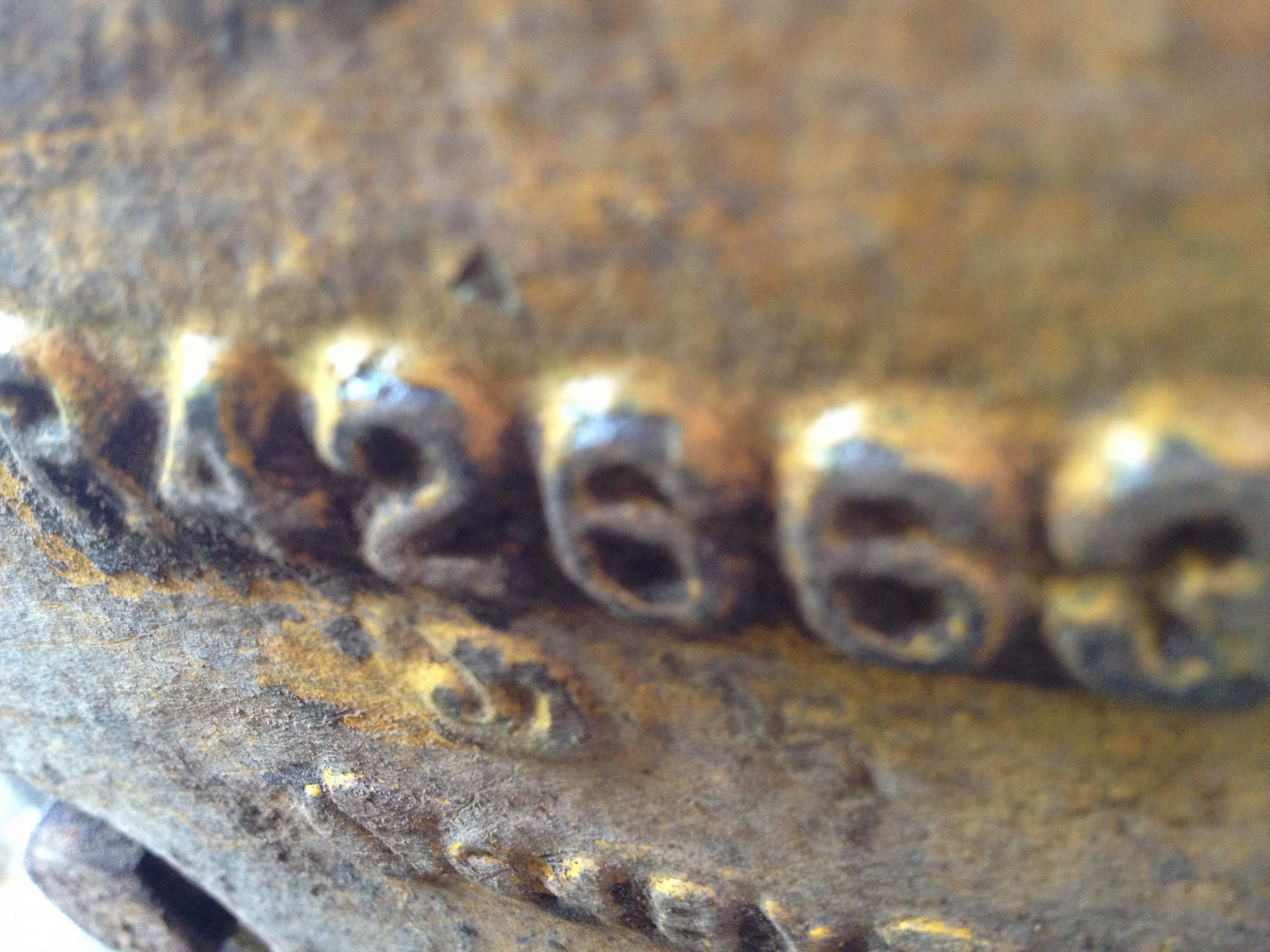

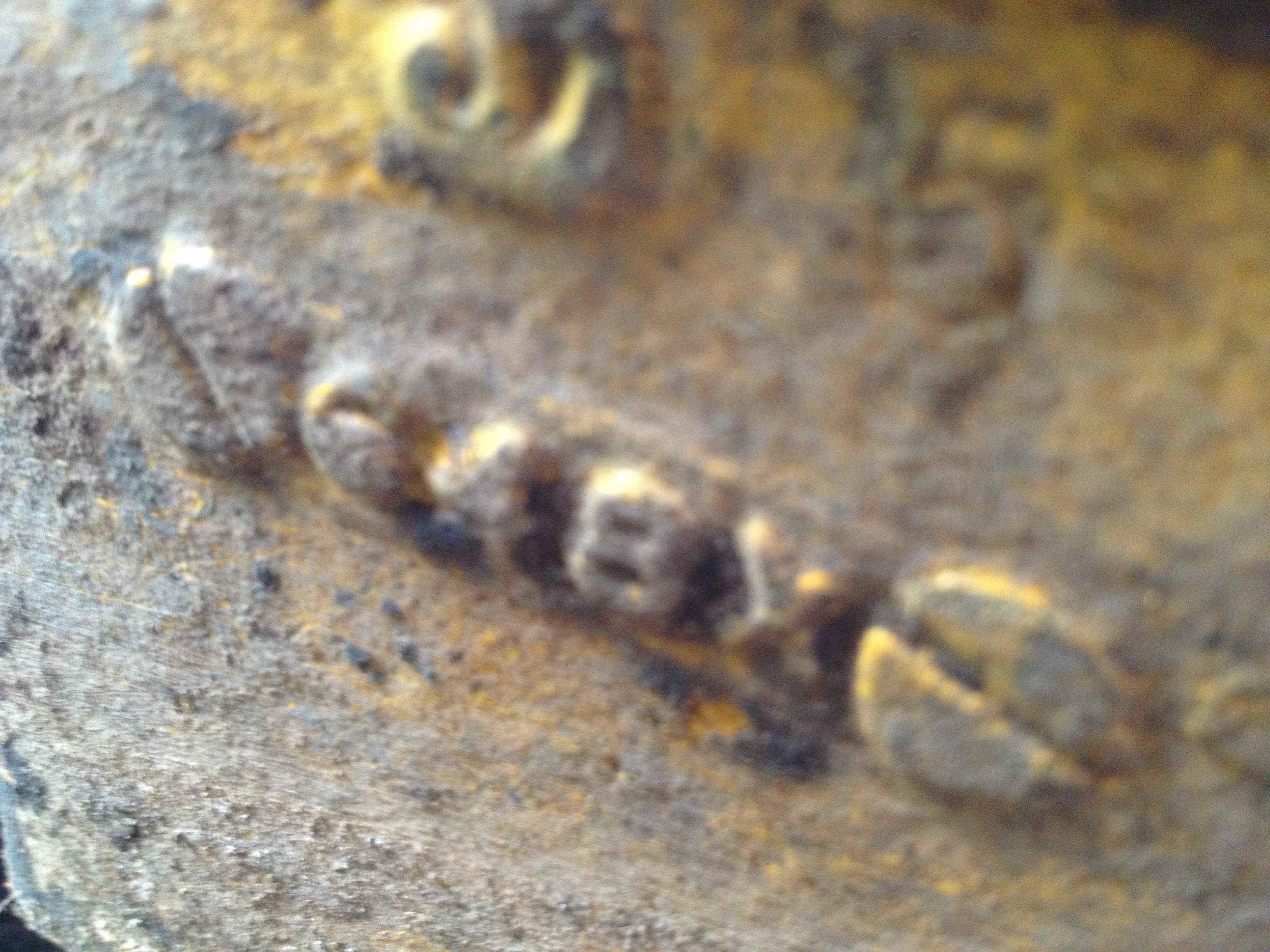

If it is there it'll usually be on a metal tag bolted to the pump.
   / John Deere 300 Industrial hydraulic problems #32
Okay. I'll look for it.
   / John Deere 300 Industrial hydraulic problems #33

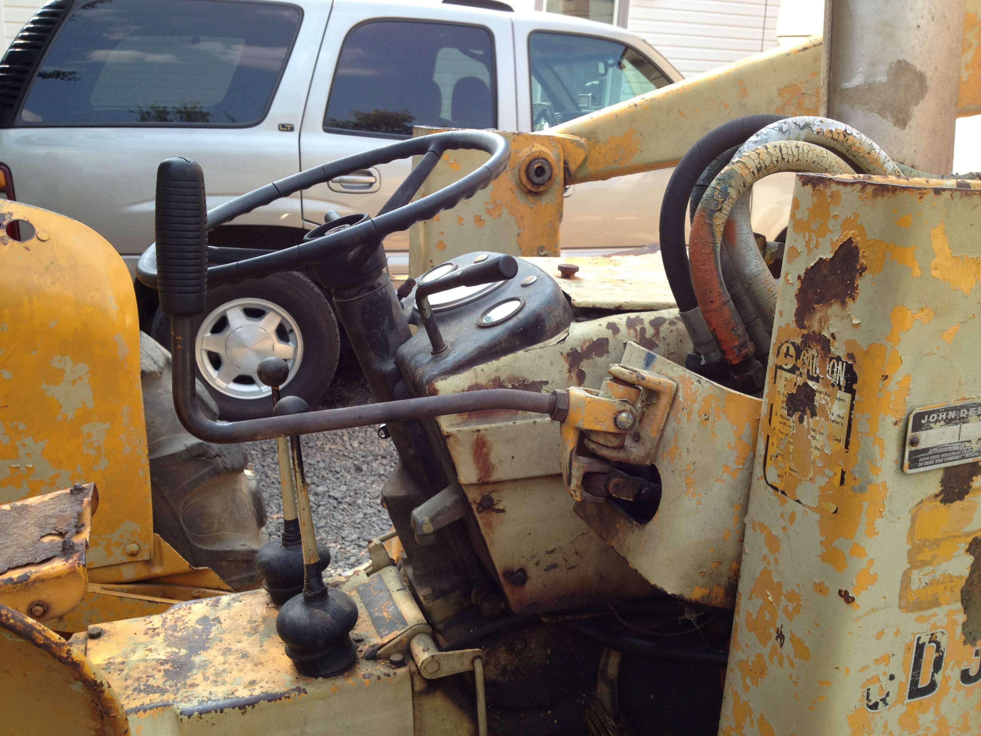

The back and forth steering trick worked. Started 3 times in a row!
I didn't find a metal tag on the pump but there are #s on the front.
   / John Deere 300 Industrial hydraulic problems #34

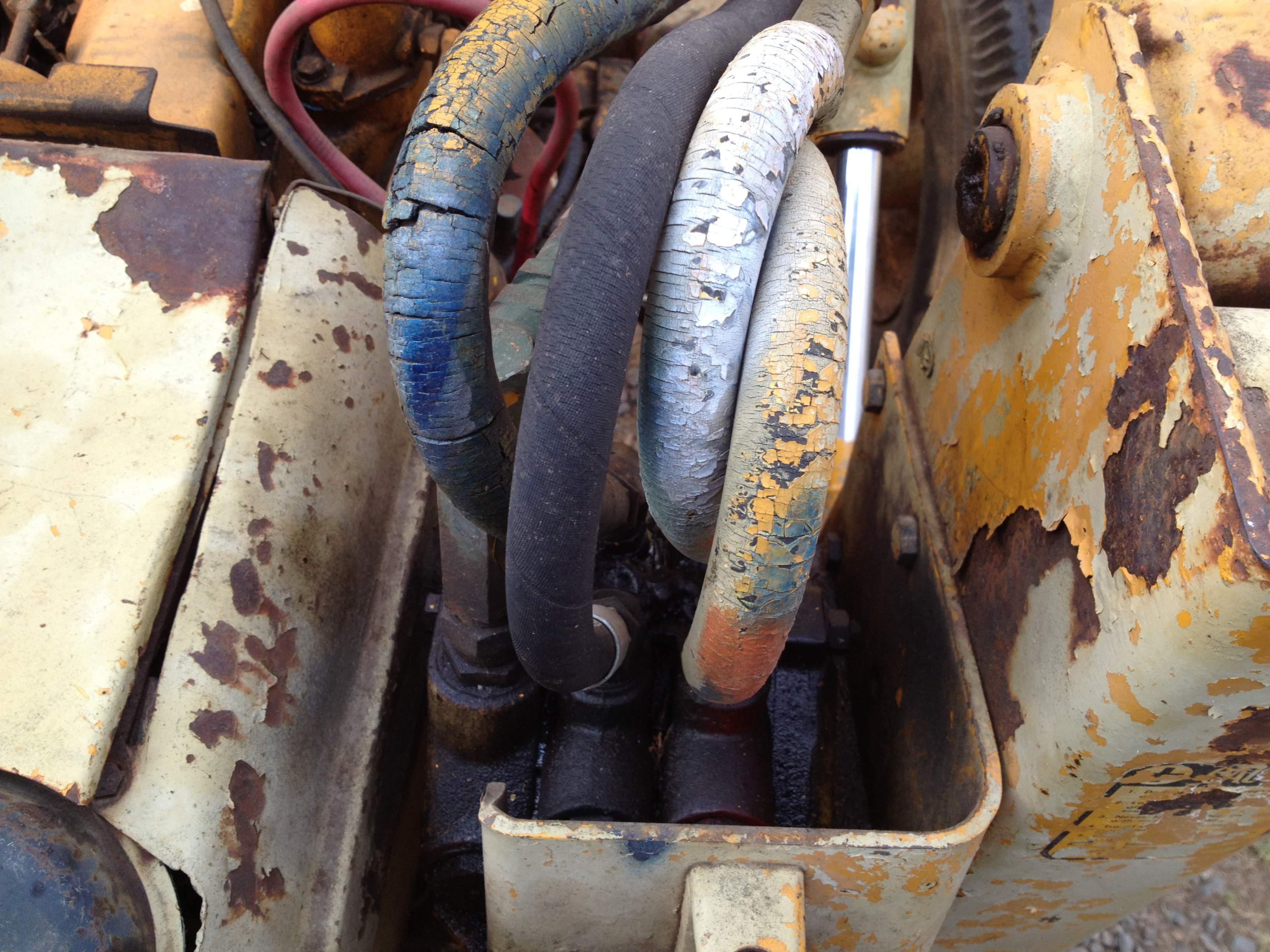

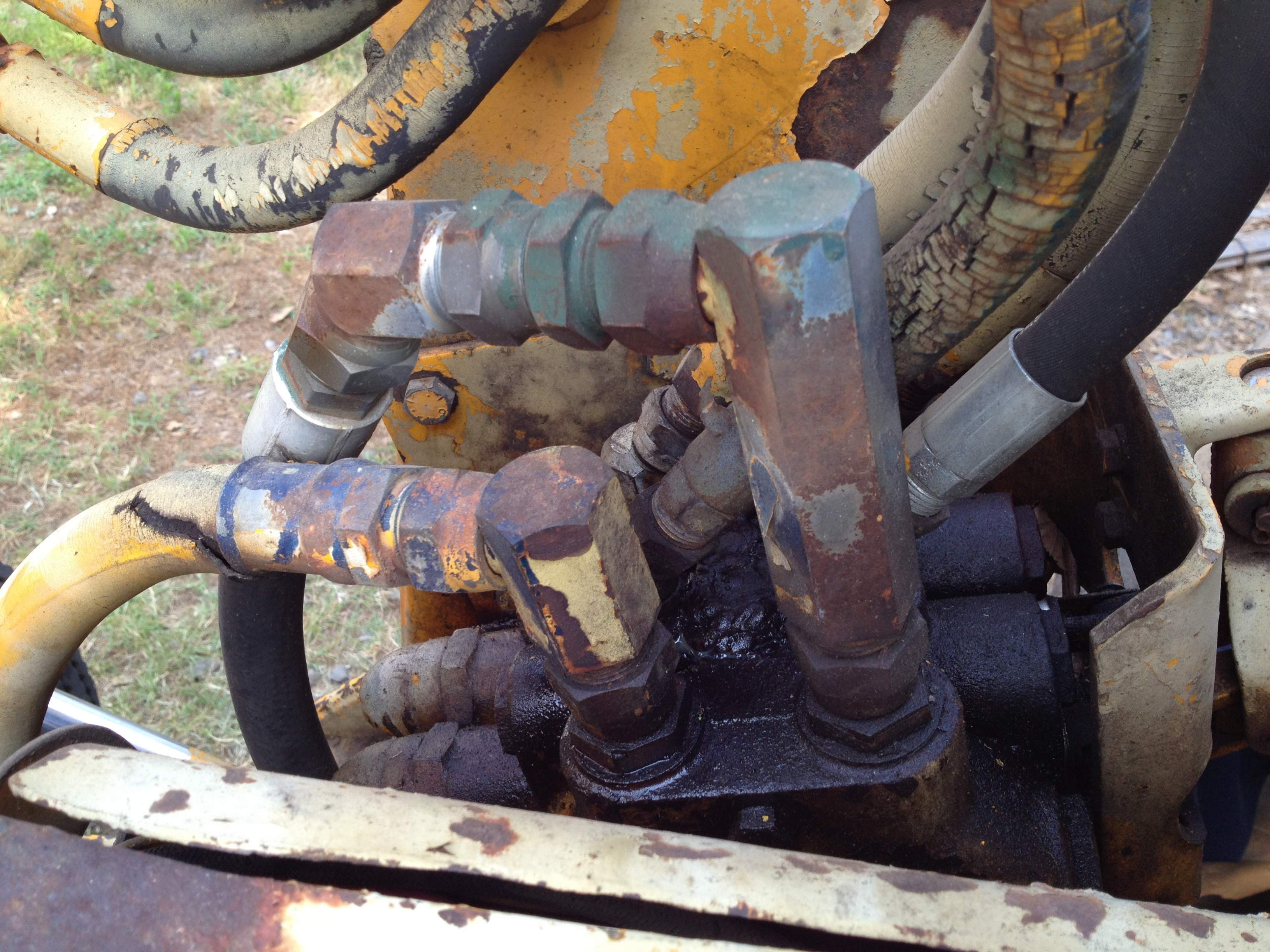

I still havent found the screen. I took photos underneath. Can someone photoshop an arrow where it is? I can't seem to find it.

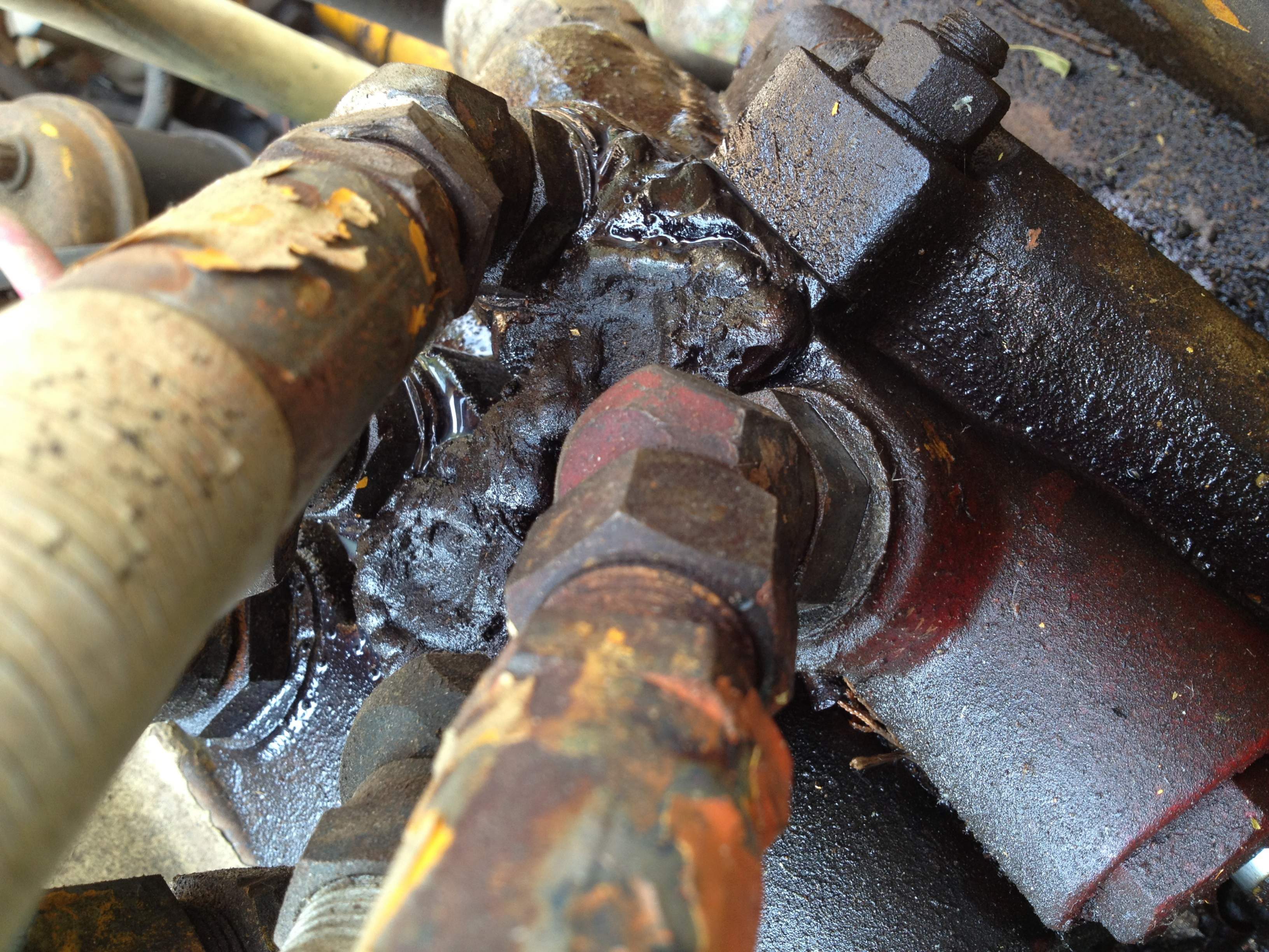

While Im at it, anyone know a reasonable replacement controller for the loader? Someone tried to patch a leak somewhere on top by laying on about 1/2" of weld. Started leaking a couple days ago. Not sure I should try to repair it.image.jpg

Is it a cessna valve set?
   / John Deere 300 Industrial hydraulic problems #36

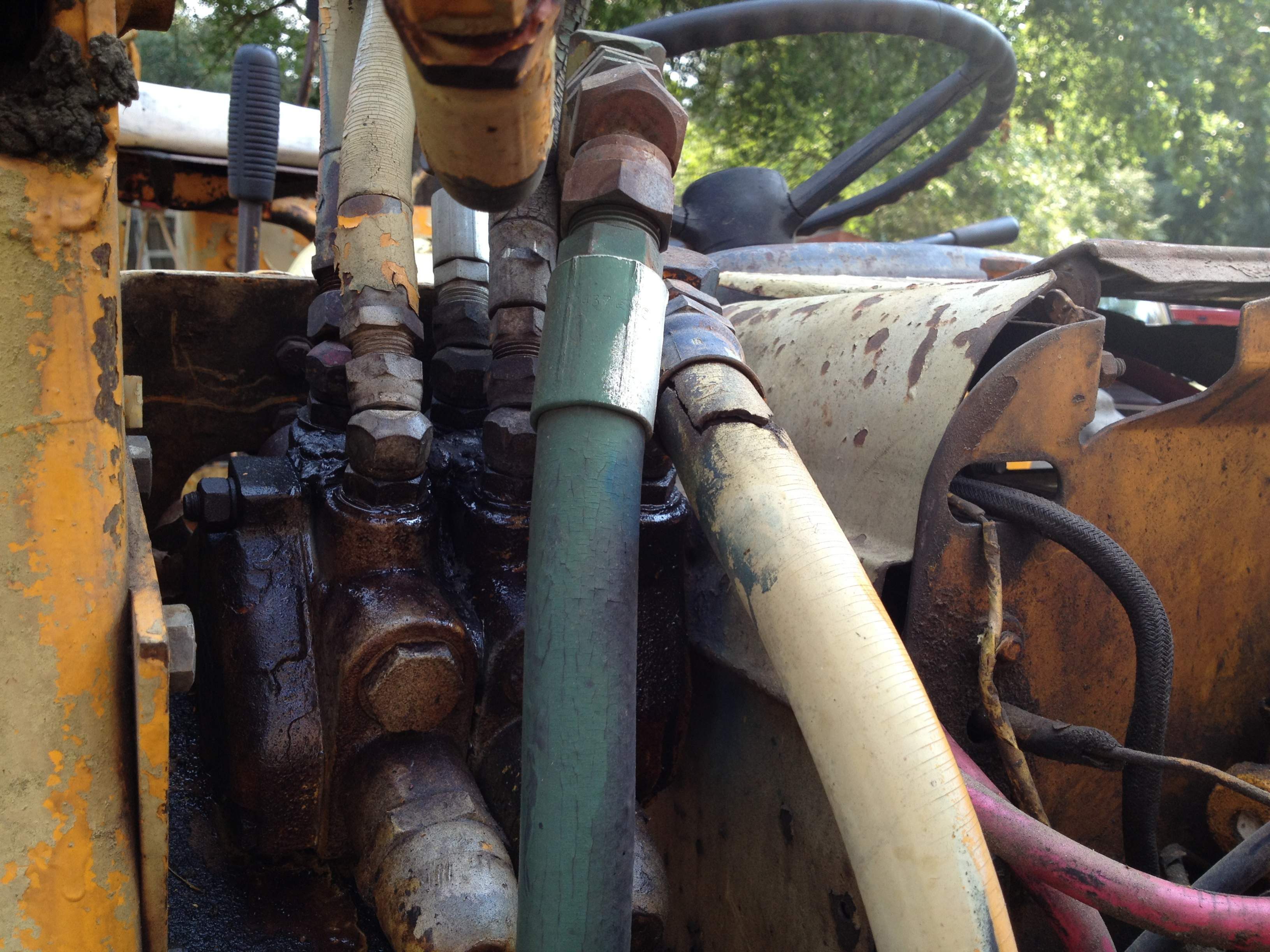

I wish I knew more about these things. All I can do is take photos and let you tell me until I learn about it. I appreciate the patience you guys are showing a newbee. I used to rebuild 94-96 Impala SS's and was on a forum for years. The amount of knowledge that gets passed down is amazing. Just wanted to say Thanks!
I'll drop a photo in a minute.
   / John Deere 300 Industrial hydraulic problems #39
   / John Deere 300 Industrial hydraulic problems #40
If you may want to add a grapple later youbmight want to get a 3spool valve instead. If it's a cessna when you remove the valve it will say cessna somewhere on it. Best not to replace with the same brand since you can't rebuild them.
