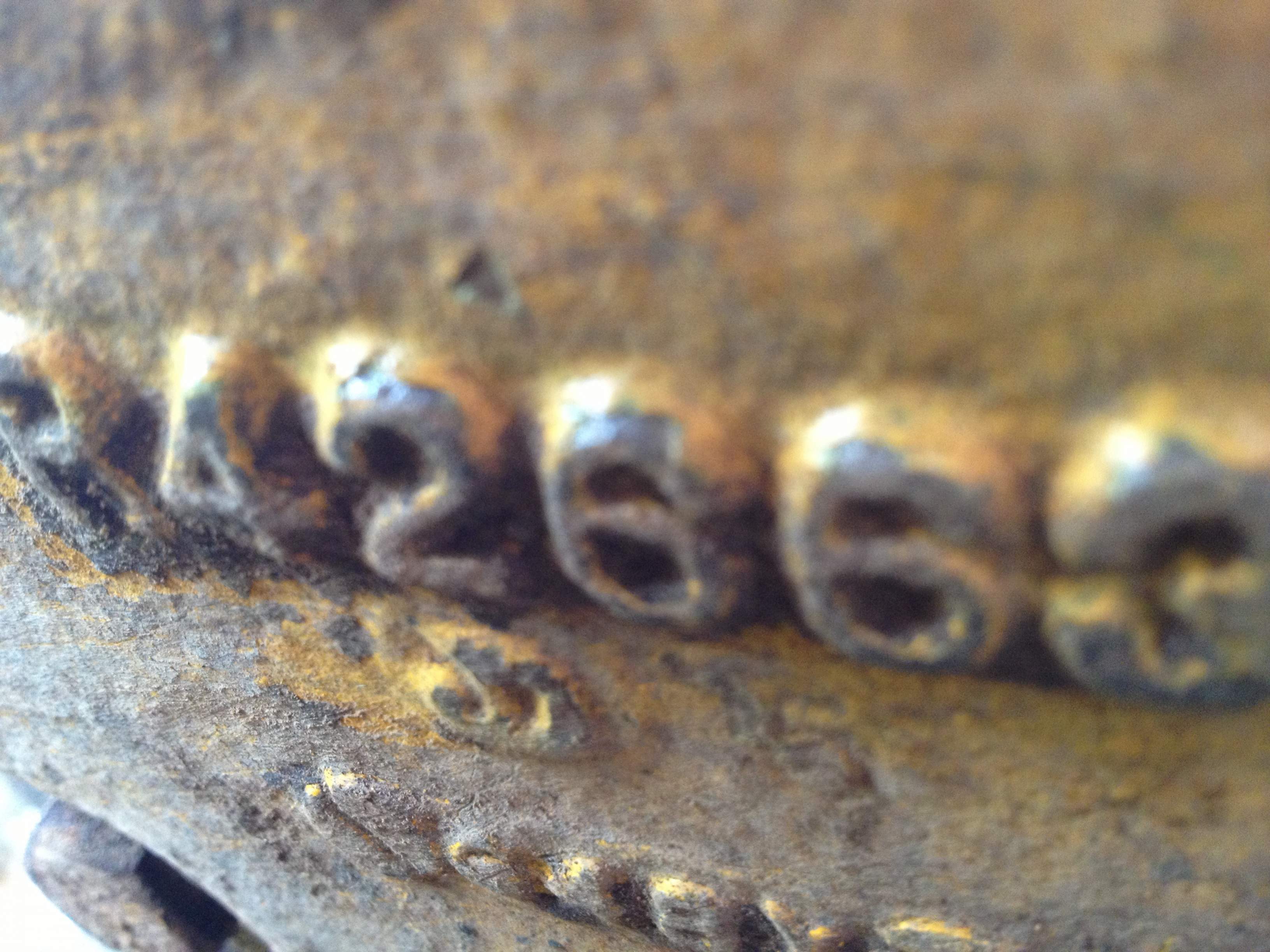

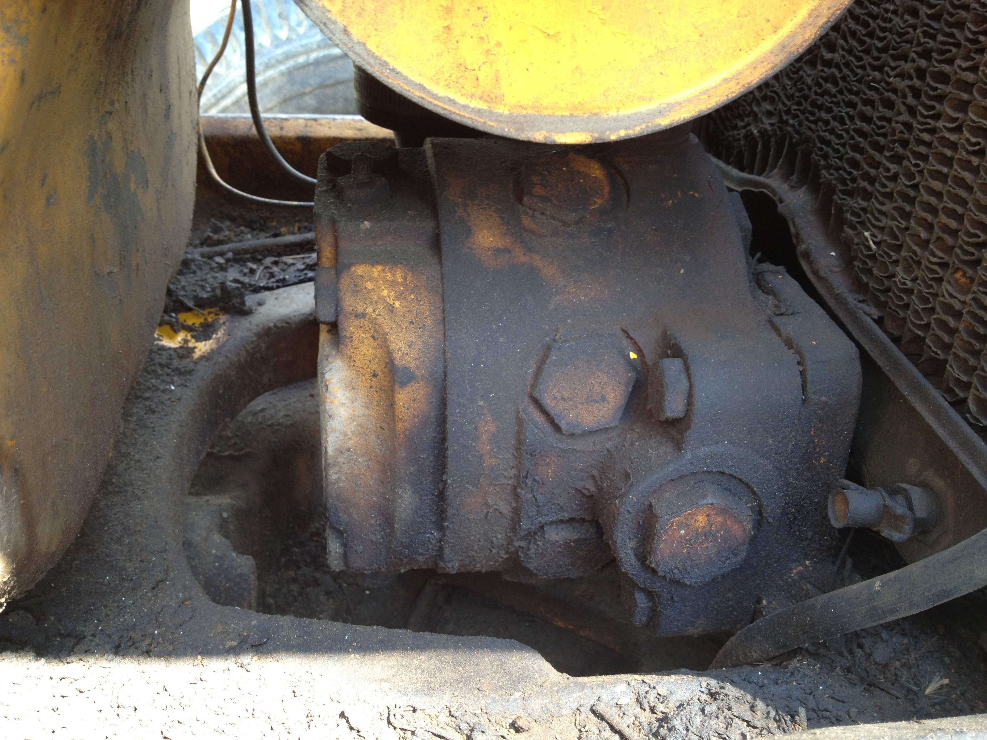

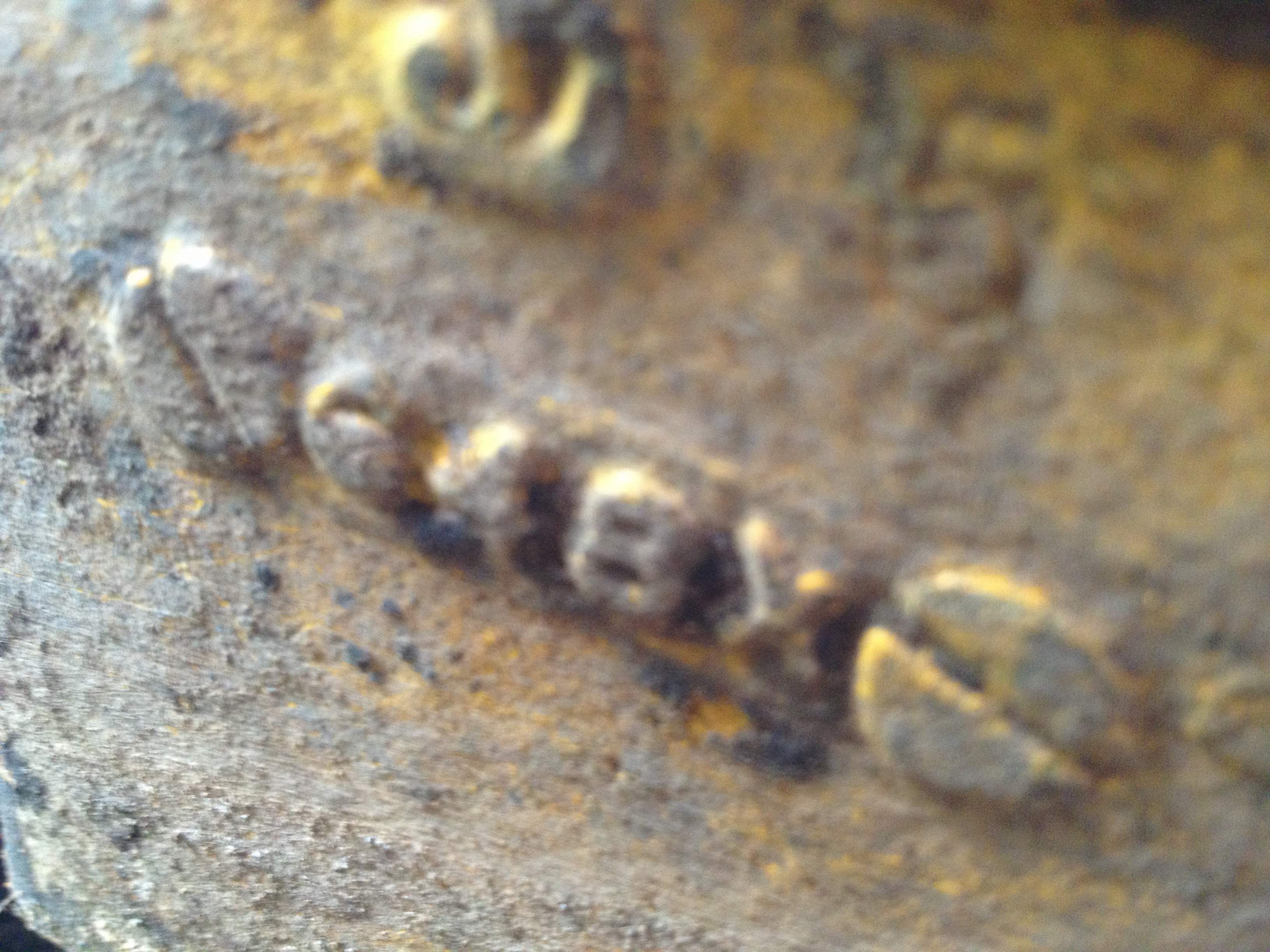

The back and forth steering trick worked. Started 3 times in a row!
I didn't find a metal tag on the pump but there are #s on the front.
View attachment 325623View attachment 325624View attachment 325625

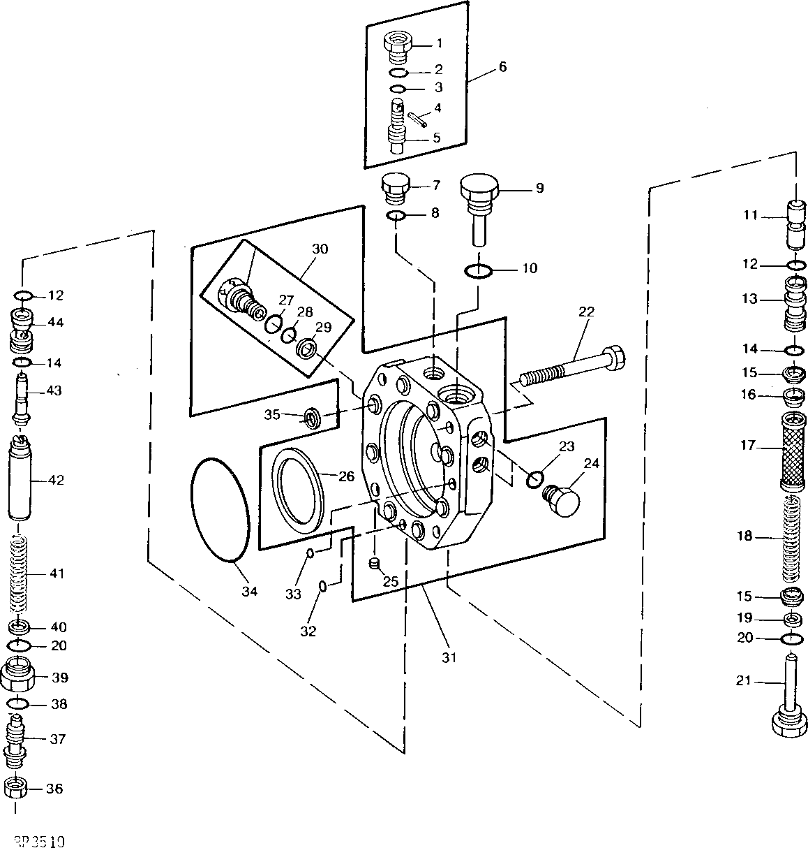

The casting # R42633 doesn't show up in the 300 parts catalog. Here's the destroking screw(parts key #6) that will fit a pump with no serial number tag. AR33249 which now subs to the following part #s
A4365R O-Ring View/Update 0.82 USD
R26448 O-Ring View/Update 1.46 USD
R27171 Screw View/Update 7.37 USD
R27475 Fitting View/Update 5.28 USD
34H254 Spring Pin View/Update 0.33 USD
