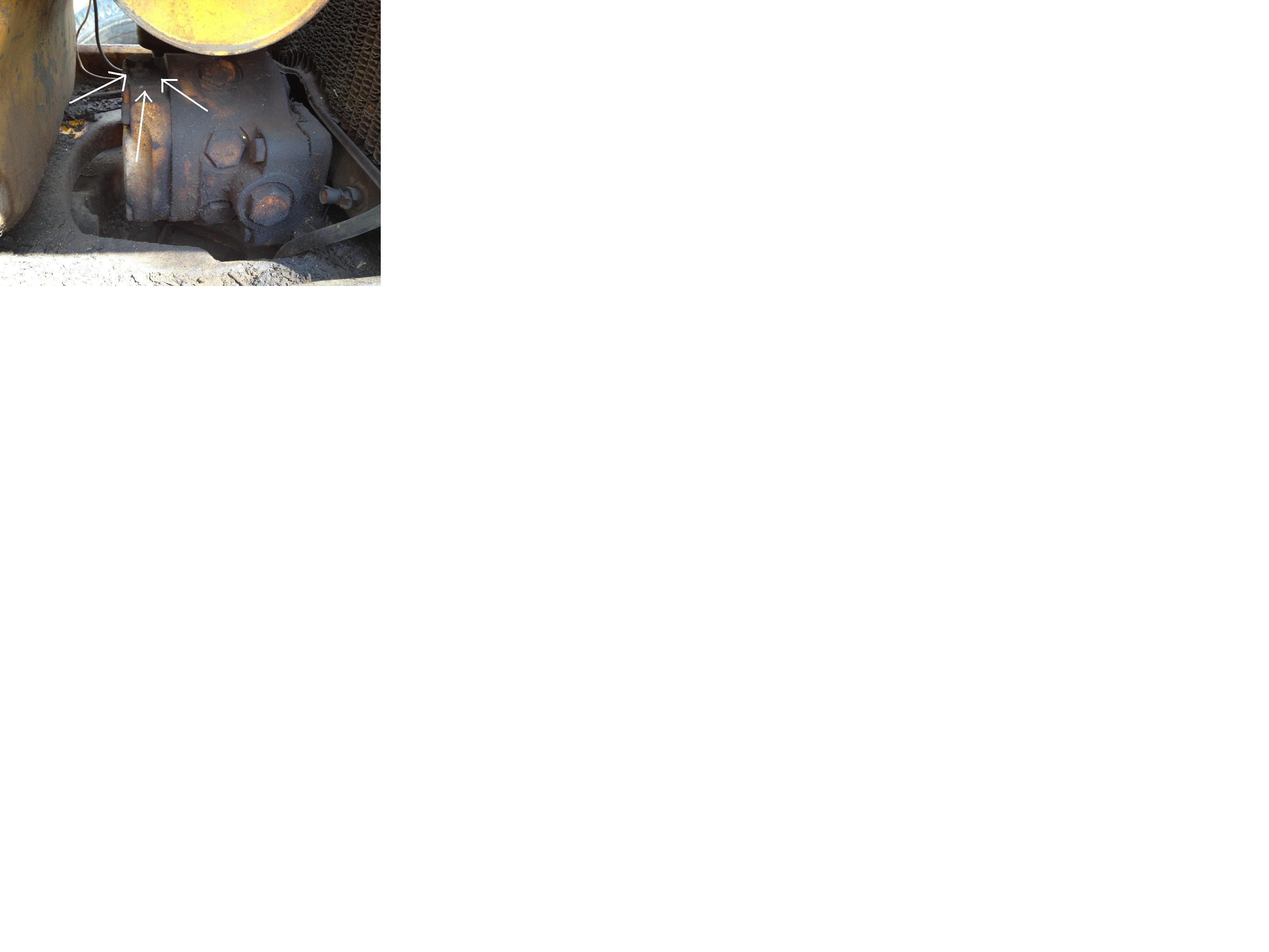

The casting # R42633 doesn't show up in the 300 parts catalog. Here's the destroking screw(parts key #6) that will fit a pump with no serial number tag. AR33249 which now subs to the following part #s

Where does it go? Does it replace #7?
Yes the DS screw goes in the same port that #7 would have to be removed from. Then screw DS screw down to stop all hyd pumping,crank engine,then screw DS screw CCW

Are these John Deere part #'s? Can I order them online? Also, is this where I would put it? (see pic).
The breakdown is different from my pump so that is why I want to make sure it is the right spot.
