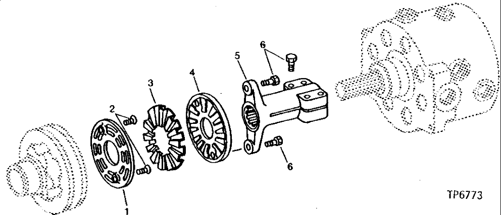

I'm a new member and have 310b john deere and have the same problem no HYD. I was wondering what you did to repair yours.
   / John Deere 310 A hydraulics quit! #28
How long since hyd filters were changed and sump screen cleaned? Also check to be sure frt hyd coupler isn't stripped out.
   / John Deere 310 A hydraulics quit! #29
The filters have been changed and a new main pump has been installed by some one other than myself. I don't know if that spline was checked when the new pump was installed. Is there a way to check that spline with out taking the pump off?
Thank you for responding so quickly
   / John Deere 310 A hydraulics quit! #30
Remove the other end ofpump hose and place in a bucket and turn the engine over for a few seconds.
If no flow, either the shaft coupler is messed up or you have lost prime.
