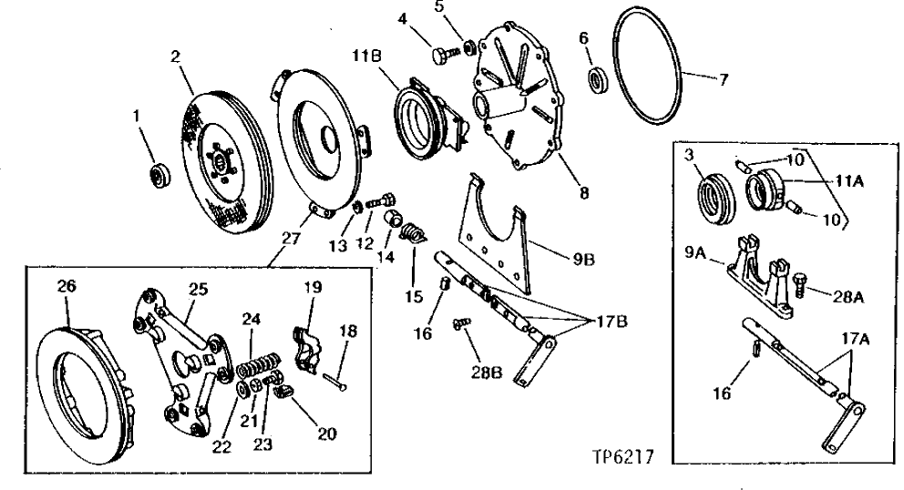

Where is the engine disconnect clutch?

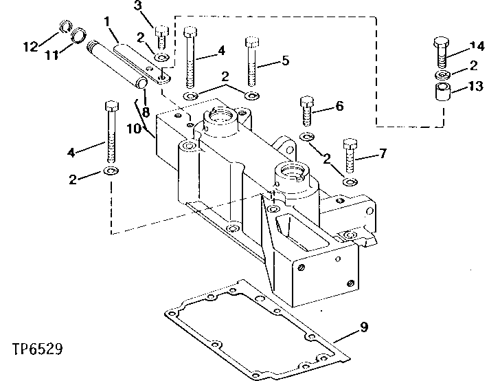

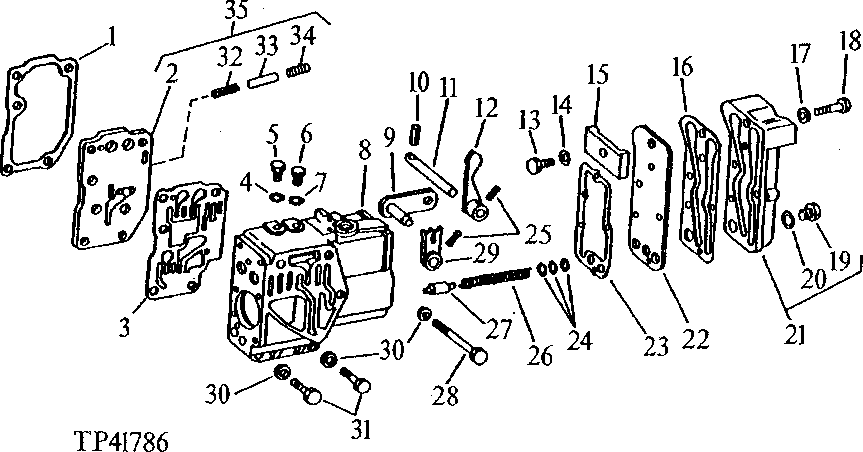

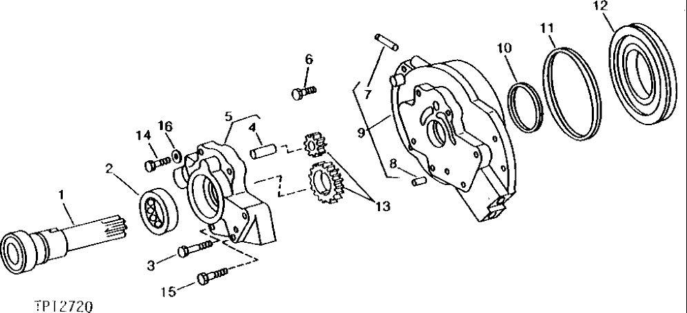

Engine disconnect clutch is located right behind the flywheel. The frt hyd pump has nothing to do with tractor moving/not moving. It is possible one of the gears in the trans pump(charge) broke(2nd photo). Block on RH side is the reverser control valve(3rd photo). Does tractor have a pto?

Trans pump pressure should be 165 psi. Pressure can be checked on shift valve that's located on RH side in my 3rd photo from previous post.To check condition of drive clutch I suppose one could remove the clutch housing cover,VERY CAREFULLY bump engine over and see if input shaft is moving.

I have limited experience diagnosing JD industrial tractor failures but a lot of experience on JD agriculture tractors which however have a few differences
