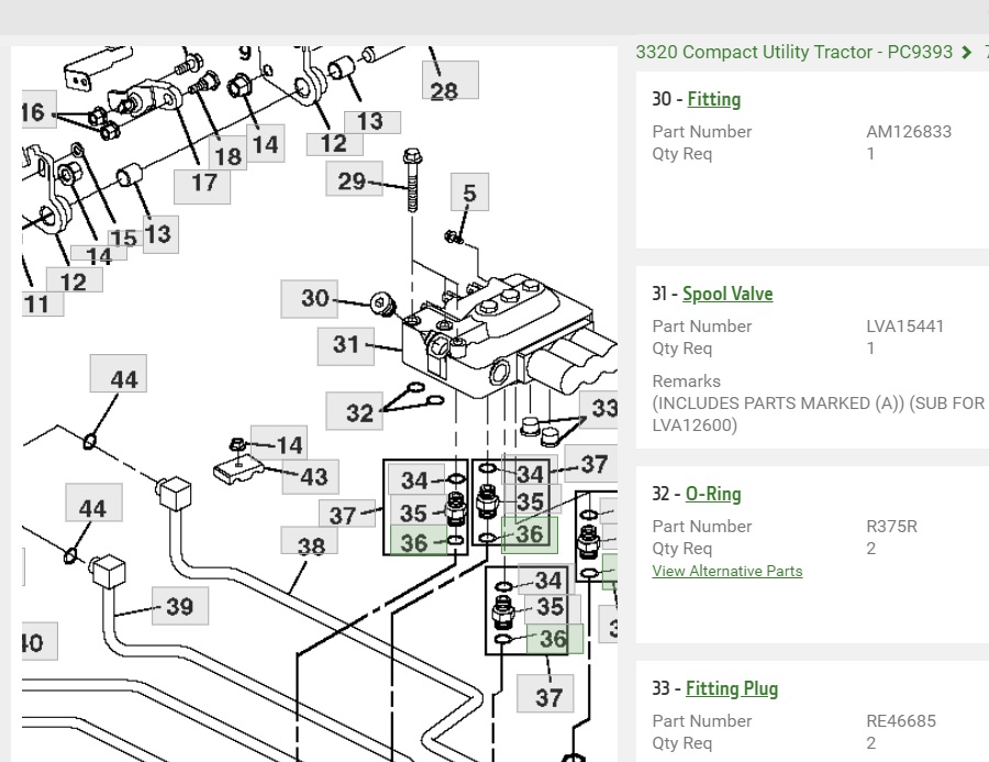

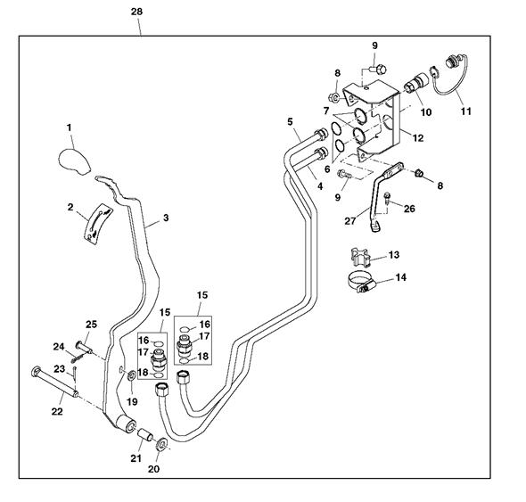

Good that you can get the 3rd SCV kit from your dealer. Not a big task to install (did on my 4300) and the 3rd spool valve is included in your existing spool valve (looks like it from parts), IF your s/n is under 71000.
Remove the right rear tire and fender.. enough to get at the dual SCV valve and connect to the 3rd spool with linkage and hyd lines.
Added mine to use with the hyd. top arm which I cannot live without. A nuisance when I have to disconnect it to use the grapple.. working on a plan to add a diverter, but very little room to work with so for the present, just switch the hose pair at the rear.

Ok, thank you for that information, both of you. The diagram helps also.

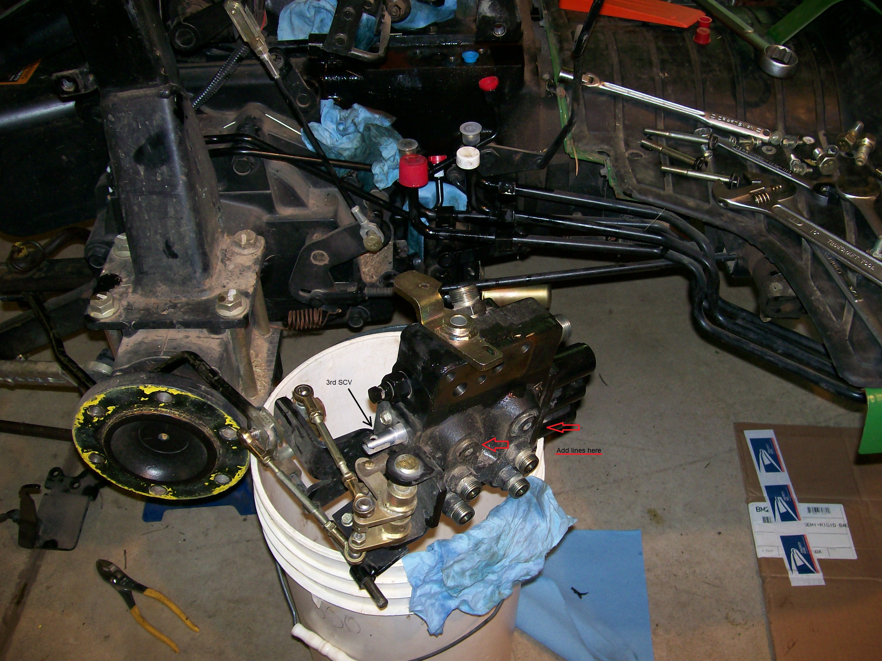

I have pics of the addition of the kit on my 4300 if interested.. tire and fender removed, and valve assembly exposed to add the hyd. lines. Suspect the kit is nearly the same. Pretty straight forward getting at the valve bank and adding the lines. The good part is you said you can get the kit.
