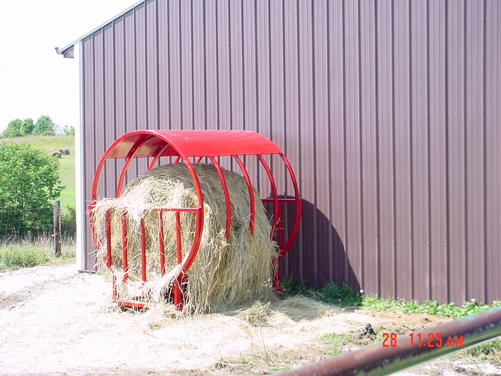

I even built my own roundbale feeder (picture attached), to keep them up off the ground. Got my ole' gelding spoiled with second cutting, and he wastes a lot of the first, so hence, the upending, and feeding, just what they will clean up.
Nice feeder!:thumbsup:
   / John Deere 335 round baler?
Yes sir.. that's a real nice feeder!

Thanks for the compliments on the feeder. It's hard to see, but I put it on treated 4X6's, and 45'd the ends, so as to move around. This is the 6th year for the feeder, and has held up well. Thought about making some to sell, but with the price of steel, not sure if they would go.
A neighbor said I should get a patent on it, LOL.. I checked the patents online, and there are umteen of them.
Still may try to make one or two to sell here in a year or so. Just too many irons in the fire at this time. Might make a good over the winter project..!!
