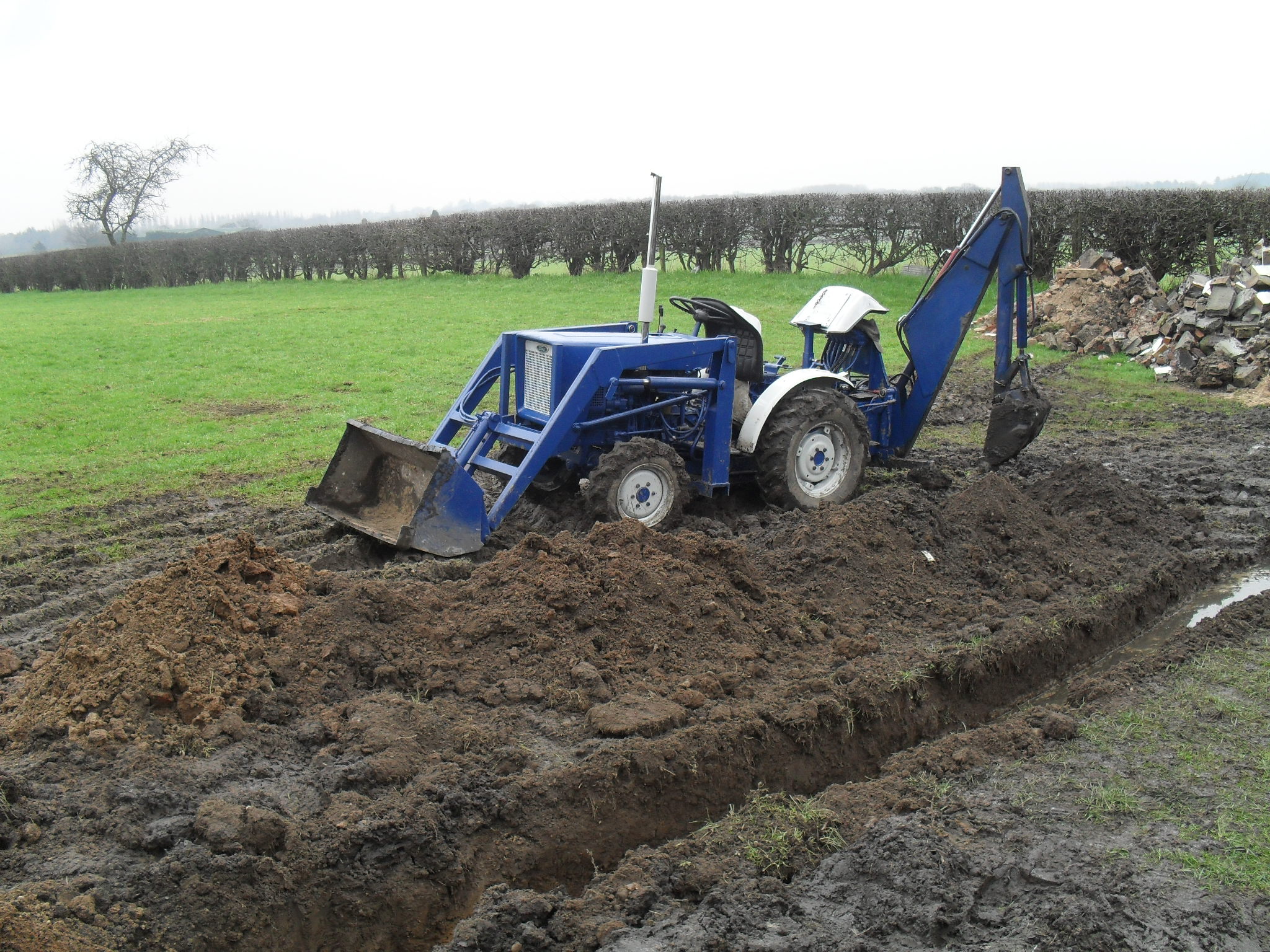

looks good! I have to ask why the vertical exhaust??? i hated older tractors with it coming out the hood for visibility so i'm wondering why you want this or you say you like it ??
Vertical exhaust shows it's a proper tractor and not a toy:D
I binned our cheap an nasty looking box from the side if the engine and made this one.
Not quite in the same league as a Deere but hey:)
Fine job on that modification! And from the looks of your tractor you've done a "bang up" job of maintaining the machine, too. :thumbsup:
(Must rain a bit there... as well! :D)
