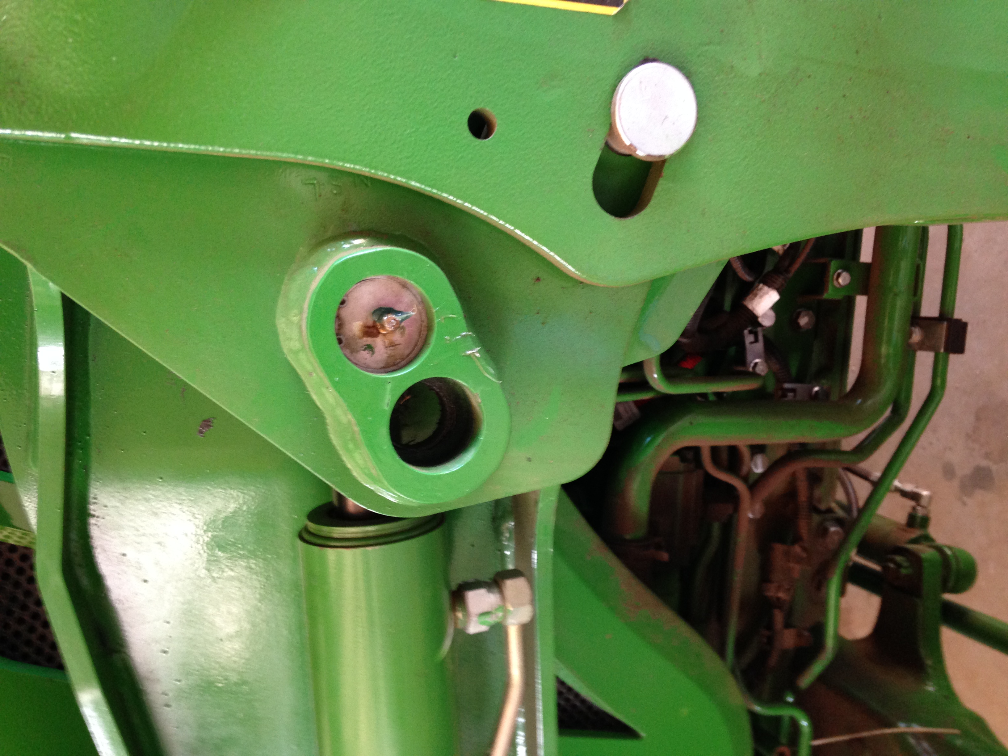

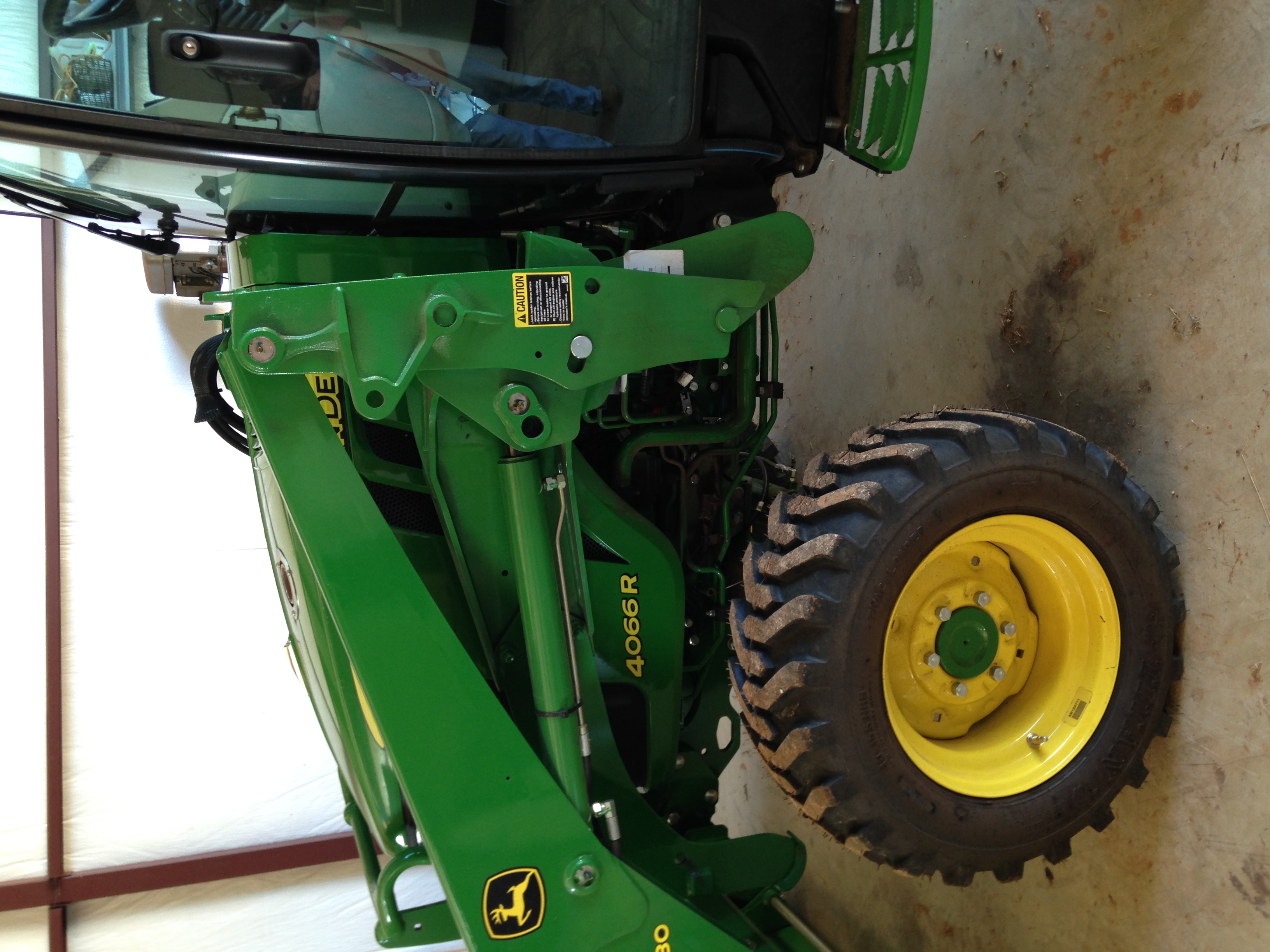

I have a 4066r....i notice the loader wont lift my yracter like my 4520 did...mentioned the problem to my dealer and he pretended like he never heard of the pronlem he called john deere and all..im pretty disappointed with john deeres service so far

I also have a 4066r and had the same problem. My sales rep told me that the lifting cylinder was all the way back and so the loader couldn't go any lower. Then we noticed there were two mounting holes. I moved the loader to the back hole and now I can lift the front of the tractor, just like my old 4600. You apparently will give up some on how high the loader will go but that's not a concern for me.
Hopefully you can tell what I'm talking about from the attached pictures.
