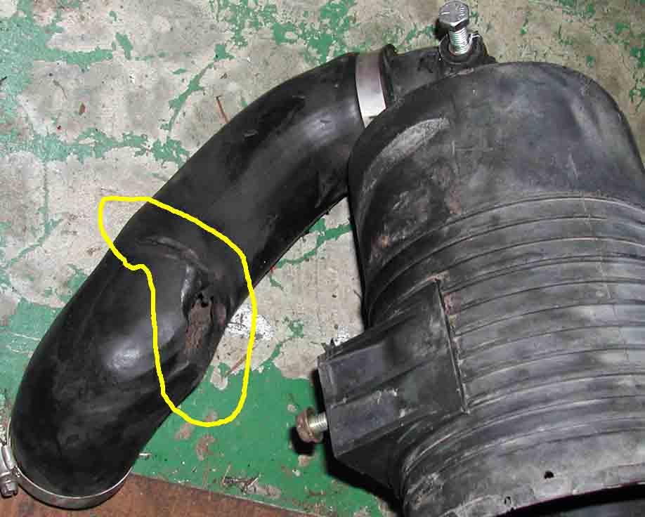

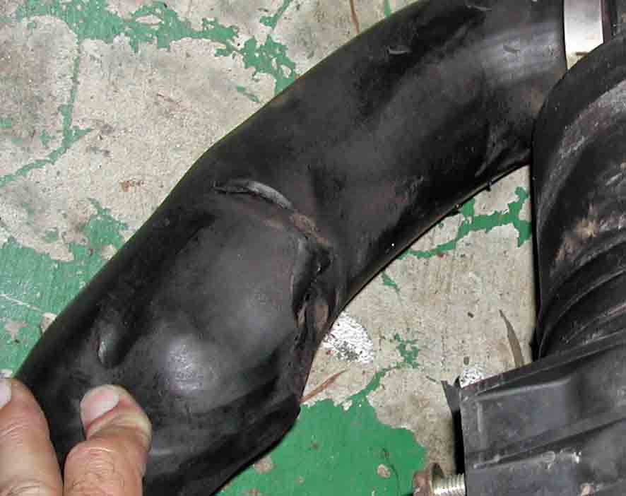

I done a test today like Wayne_H did to check to see if the hose had a hole in it.
The first test i put my hand over 'air intake hose while it was at low 'idle', and the engine didn't stall & the 'filter minder' went down... I heard a hissing sound that sounded like it was coming from behind the 'filter housing', but listening to it for a while it sounded like it was in the housing....(so much noise)
Then i ran the 'idle up higher' and the intake hose collapsed... The hose that's under that stupid tank is hard to see, and i looked on the fuel filter side and could see the hose... I could see out the other side. and it didn't look like the tank or the overflow hose was hitting the big hose... (and also i could pull slack in the overflow hose.)
I started it up again with the engine at 2000-rpms and put my hand back over the intake hose, and looked at the hose under the tank...The hose under the tank 'collapsed too'
So since that hose under the tank collapsed too, would the hose be OK ?
I need to take out the 'filter housing' and see if i can look at the hose better...(Like you mentioned)
I took some pictures but they might be hard to see the hose under the tank.
* The last 2 pictures are the hose under the tank.... Pic.#3 is before I covered the intake hose.
* Picture#4 is when the intake hose was covered, and the 'hose under the tank' was collapsed in the middle..... Notice that you can see more light through the other side.

I'm no expert, but i've got to imagine if that hose collapses under RPM, the intergity of the hose is ok. I still have a hard time imaging how much abuse that machine DK is working on had. Heck, I feel bad for the tractor, but as a restorer of old tractors, I'm glad it is in good hands now!

I took another look at my old hoses and I took a few more pictures with
them up against my newly assembled engine. A closer look indicates that
I was wrong....the hose does have fabric reinforcement. I can see it at the
end where the hose clamp is. Very hard to see in the break.

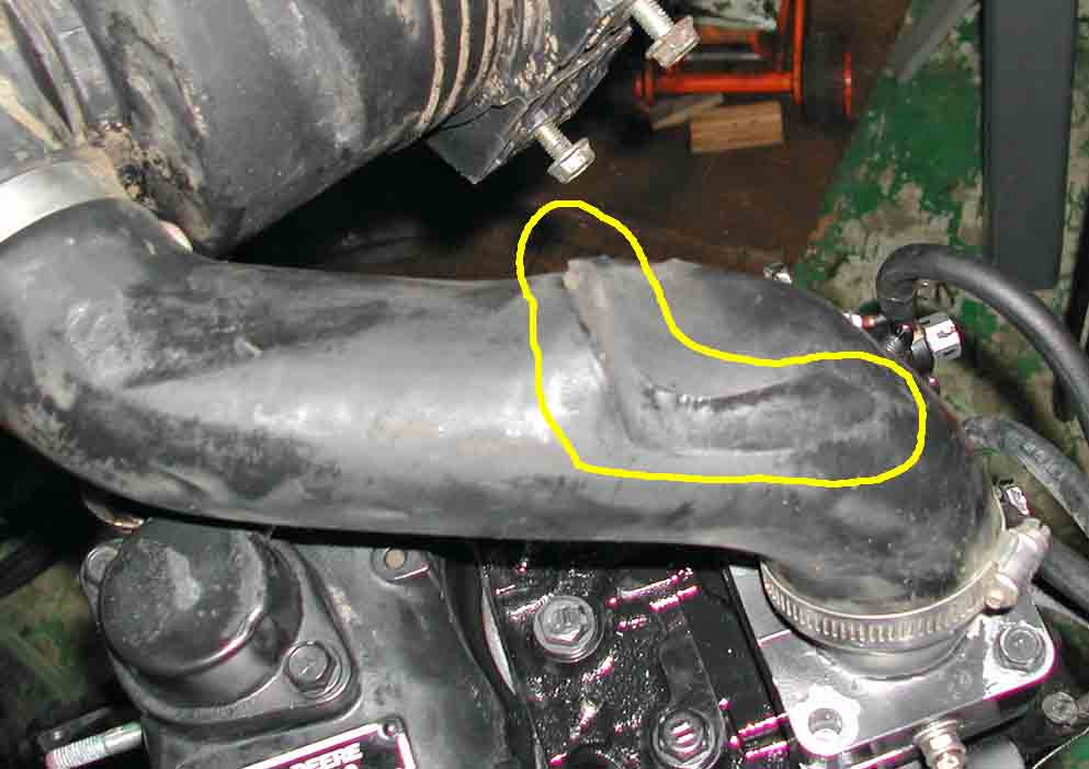

Anyway, this is good news that the hose collapses during your test. My
fuel drain hose has become very hard. There are 3 places on the air
hose that have significant wear from being pinched. Only one has broken
thru, but that one tore, too.

Those are good questions. Maybe JD had not tested this filter approach
adequately as they rushed it into production...
Regardless, we are not stuck with a bad design if we want to customize it.
The first thing I will do is eliminate (or re-route) that fuel overflow hose.

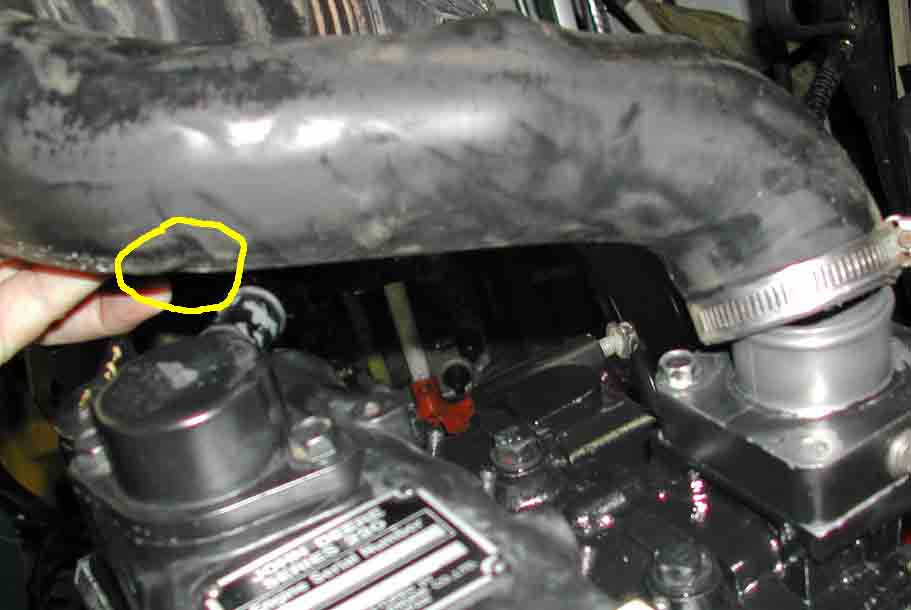

Anyway, here are more pix of the damaged hose, and where it gets pinched.
The first photo is what I posted earlier, with a large hole and split. Installed,
the hole is pretty much closed up, as you can see in the 2nd photo with
my hand pushing down on it. With some dirt on it, the split and hole are
hardly visible.
The 3rd and 4th pix illustrate the 3 damaged areas, due to pressure from
the fuel tank, fuel overflow hose, and the breather on top of the valve
cover. 2 of the 3 damaged areas have not penetrated, but quite a bit
of rubber has eroded away.
