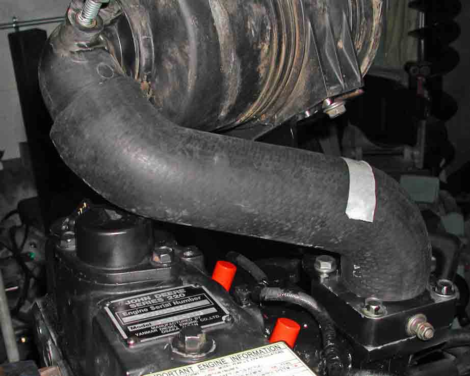

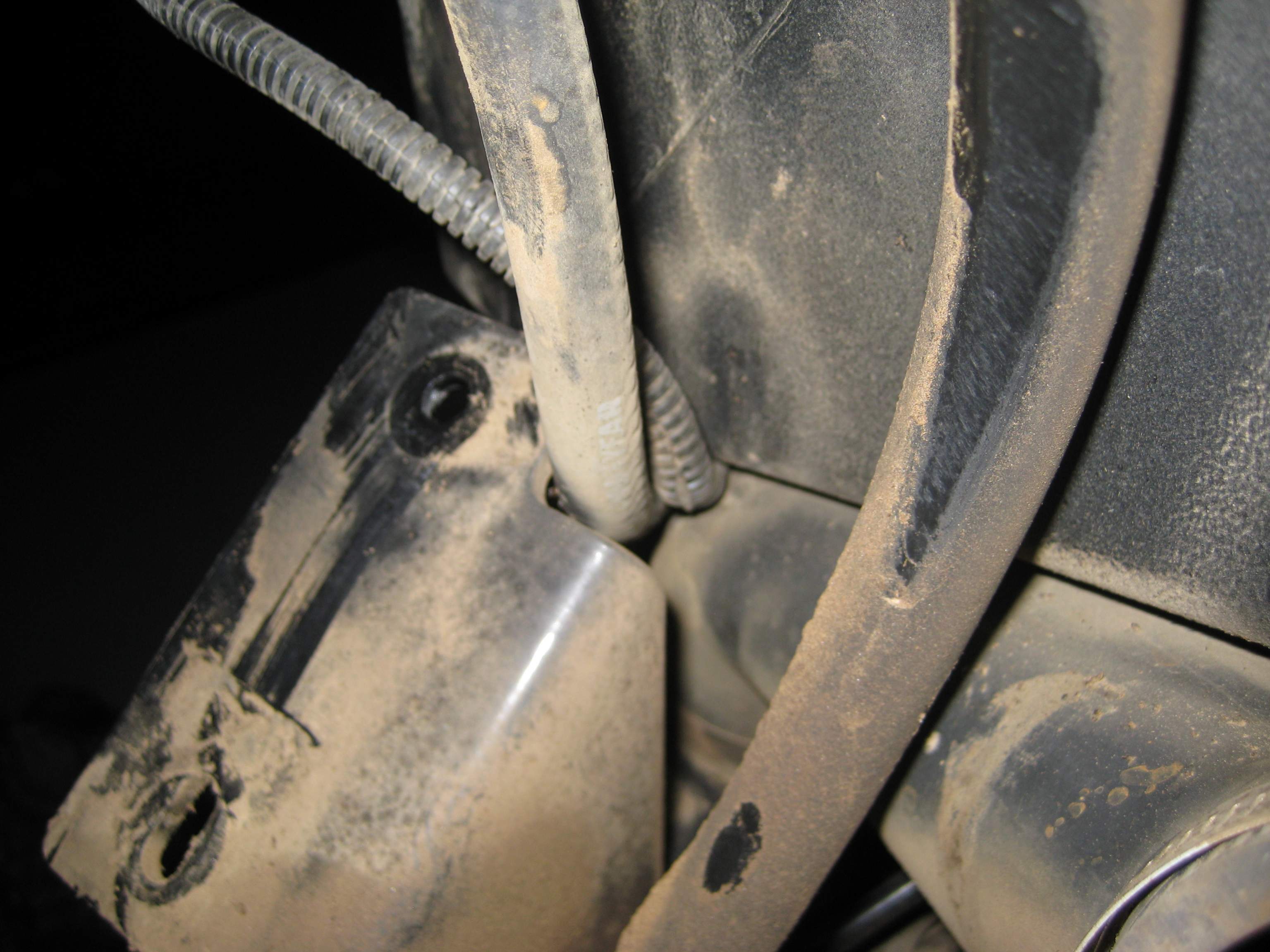

Anyway, here are more pix of the damaged hose, and where it gets pinched.
The first photo is what I posted earlier, with a large hole and split. Installed,
the hole is pretty much closed up, as you can see in the 2nd photo with
my hand pushing down on it. With some dirt on it, the split and hole are
hardly visible.
The 3rd and 4th pix illustrate the 3 damaged areas, due to pressure from
the fuel tank, fuel overflow hose, and the breather on top of the valve
cover. 2 of the 3 damaged areas have not penetrated, but quite a bit
of rubber has eroded away.
Yea, i can see where they put pressure on the hose.... This is something that really needs to be checked very often.
I think JD really has a bad setup on this... Yesterday when i looked at mine from the fuel filter side, the tank isn't touching the hose.. and i wonder why it was on yours.
Next week we could get a lot of rain, and i plan to take my filter housing out and see if i can check on the hose better... and also look for any dirt buildup around the hose.

Here is a photo with a new hose. There seems to be enough room in
there between where the tanks goes, and the valve cover.....as long
as there is nothing else in there.
I was hoping to reuse this filter housing, but it looks like I will be
ordering a new one.

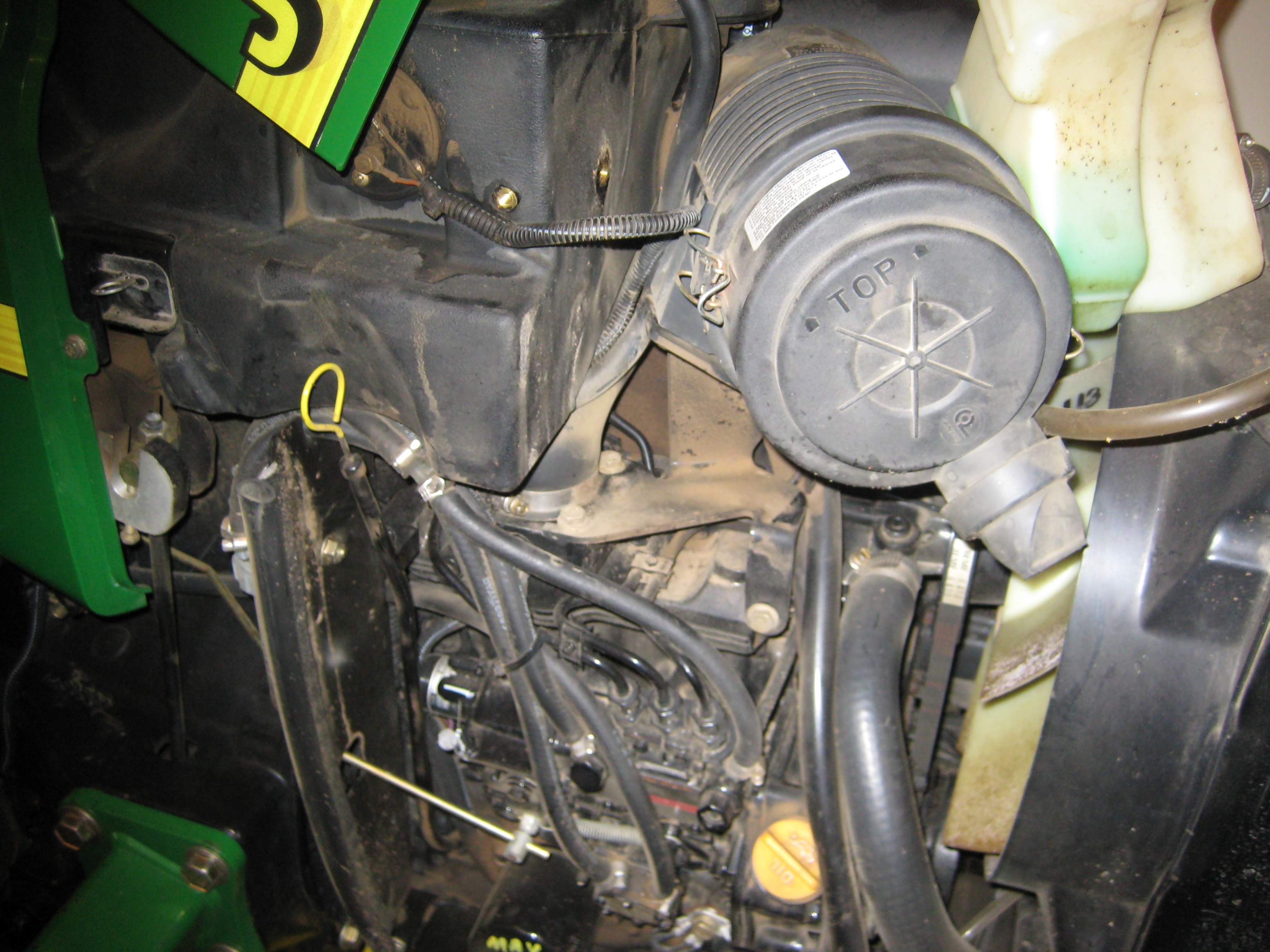

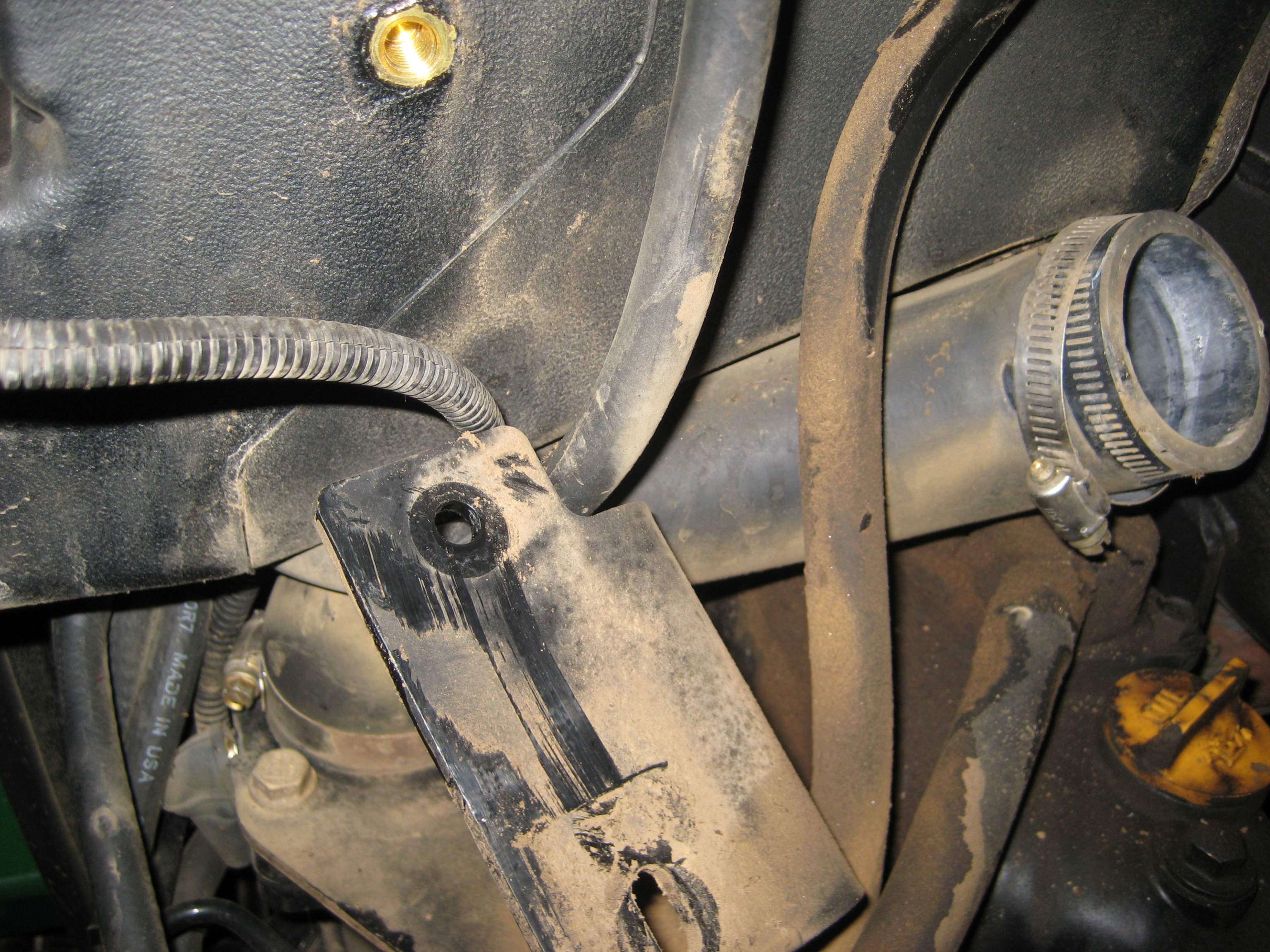

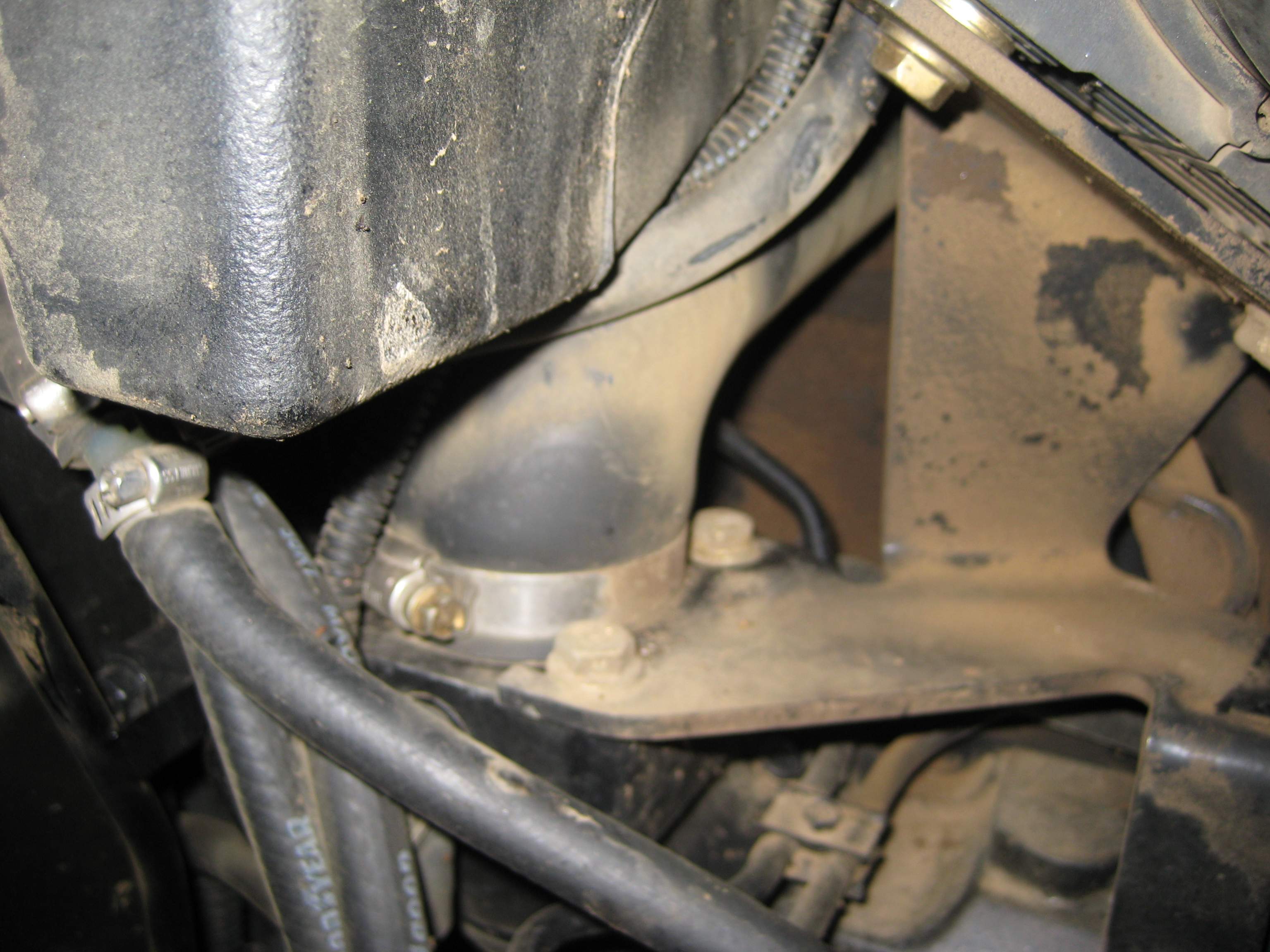

OK, DKRUG, you motivated me to do some more looking at my 4400. I assume the tractors are extremely similar, even down to the engines. It took about five minutes for me to inspect the hose that goes from the air filter to the intake manifold. First, I removed the coolant overflow tank and got that out of the way. (one bolt). Second I too the two bolts off of the air filter hosing. You have to remove the coolant overflow to get at them. Then, I loosened the hose clamp that is closest to the air filter on the hose the goes to the intake. Then I took the filter housing off and looked around. There are two possible hoses that could be an issue. One is the overflow for when you put two much fuel in and it spills in the bowl area around the cap. That hose drains to the ground. There is a second hose near the air intake hose that is part of the closed loop fuel system. It is connected to a "T" fitting near the IP. None of these hoses touch or are touching my air intake manifold hose. BUT, but if somebody misrouted them you might have a problem...
Here are some pictures. The first is the air filter housing with the overflow moved to the right some. Now if you take a look at the overflow hose that is routed close to the water hose, if you put that on the wrong side of the filter housing bracket you will have contact.
The last picture shows clearnace between both hoses, but not much! If the gas tank moves or is somehow pushed down, it will make contact. There was no/no contact or even appearance of wear on my manifold air intake hose.
Wow, I'll sleep better tonight now. If I could only figure out how to put this back together....
Wayne
