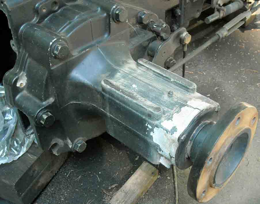

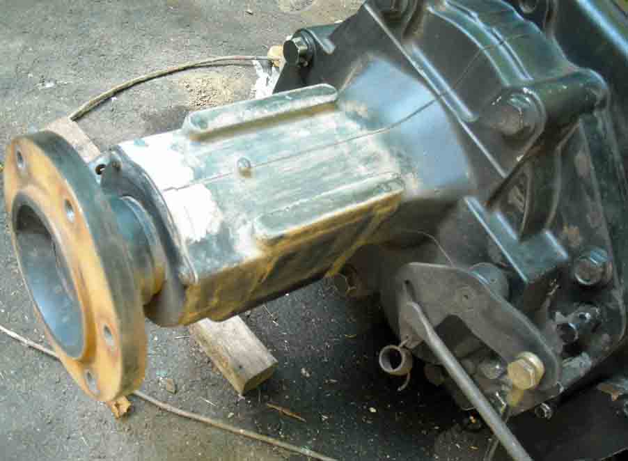

Moving on to the rear axles and final drive.....
All these photos show corrosion on the rear axle housings. Dirt accumulated
in these locations, and it often got wet. Aluminum is very intolerant of
acidic contaminants.....JD owners should clean these areas if they want
their tractors to last a long time. This is especially true if the tractor is
used in and around horse barns or other areas with a lot of acidic liquids.

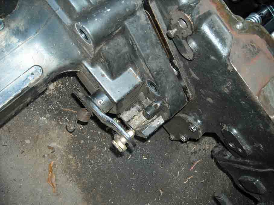

In the third photo, I have removed all bolts. The brake control lever needs
to come off before the housing can be removed. You can also see the
diff lock shaft (painted black)....some models put the control lever on the
left, and some, the right. I will need to remove the paint from the shaft
to get it out.
The brake levers on both sides were very hard to remove. The roll pin is
nearly solid, instead of the common C-shaped style, and it took a sledge
hammer to get it out. None of my gear pullers could remove either lever,
so I had to resort to surgery....

I should have warned you about the roll pins in the levers. They are a smaller pin pressed into a larger pin. I made a tool out of a piece of 1/2" diameter x 18" long 17-4 sst heat treated to about 44 rockwell. It was basically an 18" long punch that was turned down to drive out the smaller "inside" roll pin. Having it this long was handy to be able to get a 3lb sledge to convince it out. There is a thread somewhere I did years ago about my "naked" tractor. Once you get the levers off it goes pretty easy. But I highly recommend that you replace the seals where the axles come out of the housings. I also lightly sanded smooth the axles where the seals contact it for smooth sealing.
The brakes will work great once you get all the lever's thru holes cleaned and greased.

I got all the roll pins out with the "persuader" and a regular drift....pulling
the levers off was the hard part!
