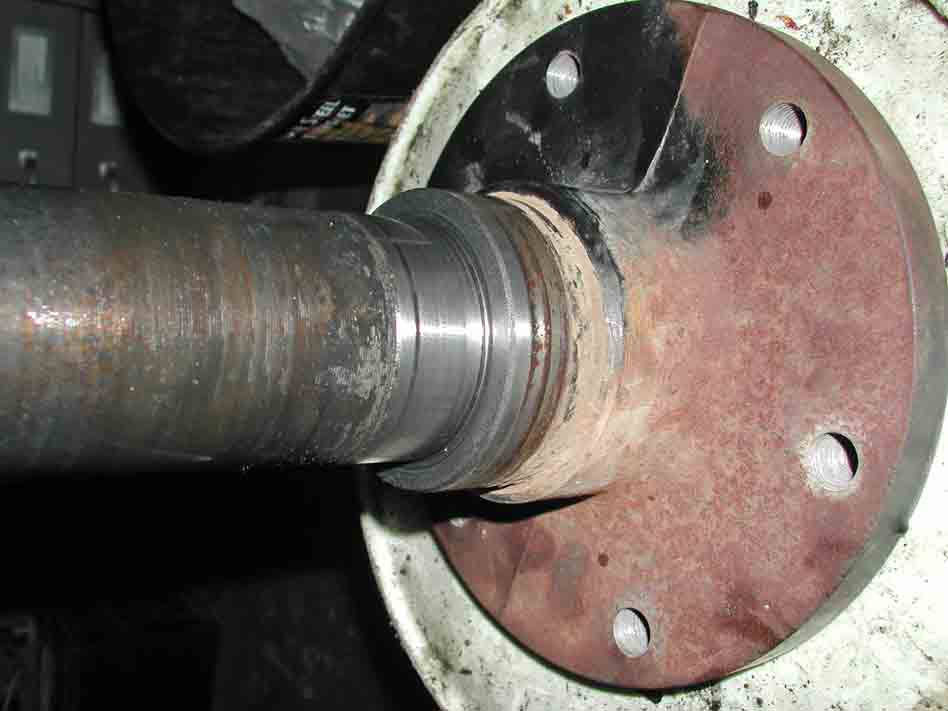

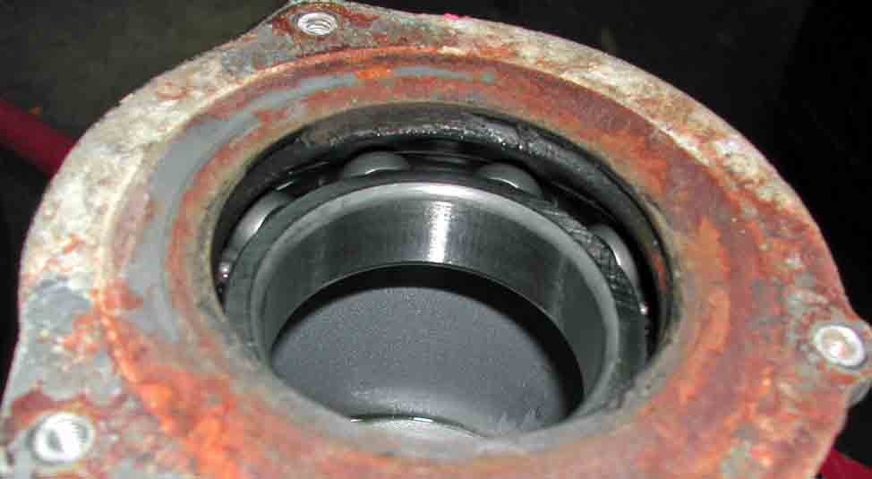

At last here are the rear axles.
Dirt gets around the seal securing bracket, and into the seal itself. I agree
with Kyle that the space between the bracket and the seal, and the space
between the bracket and housing should be sealed up to keep mud from
getting in there and causing all this corrosion. The first 2 pix are exactly
what I saw when I removed the axle. In the second, you can see dirt
lodged between the two rubber lips of the seal. Not good. But the seals
do not leak, so I am not changing them. The only way to avoid getting dirt
in there is to not drive in mud up to the hubs. The Russian bearing in there
is also still good.

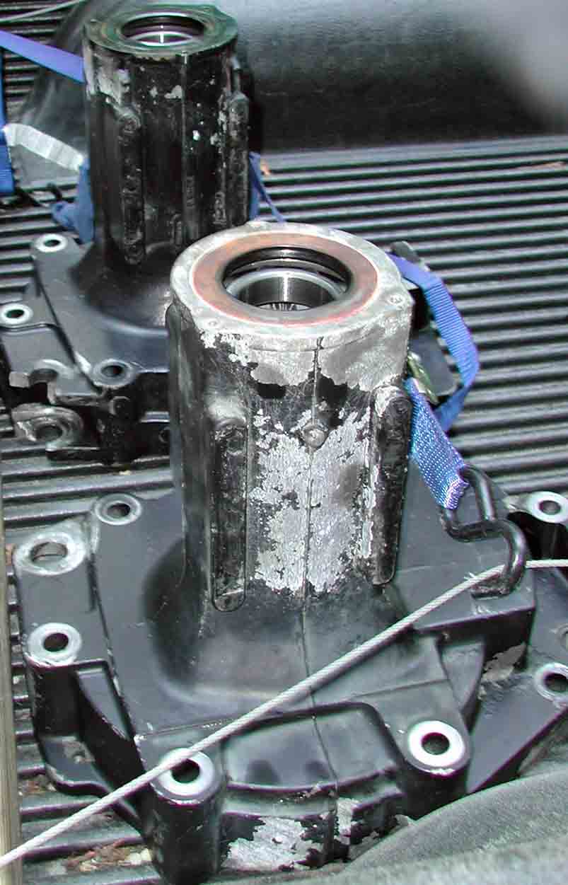

In the third photo, the housings are both out and ready to go to my welder.
The closer one has been cleaned up with a wire brush; the other one
has been cleaned, the seal cleaned, and the end and seal painted. It will
all be painted when the welding is done.

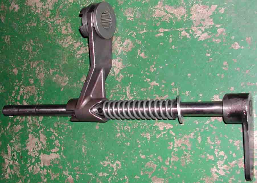

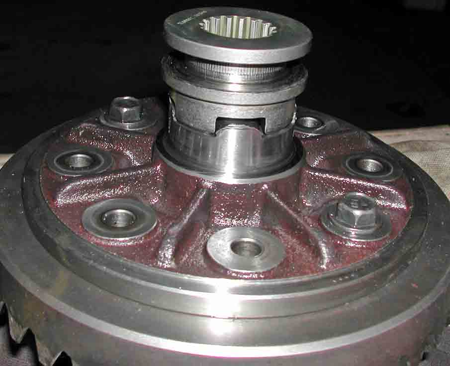

As I opened up the differential locking mechanism, I can see that it is not
in very good shape.
In the first photo, you see the moving collar, and the shift fork that moves
it. This is right behind the wet brakes on the right side of the tractor. The
dirty oil sediment is quite visible....everything will have to be taken apart and
cleaned well.
In the second photo I have removed the shift fork, rod, spring, and bellcrank
(lever). This lever did not want to come off, like the brake levers. Rather
than resorting to surgery, I extracted everything out the left side of the
gear case, and I will press it off later. Note that there are no O-ring seal
grooves in the shaft. That's good, or the shaft would probably be broken.
I did have to remove all paint from the right end of the shaft first, before
I could pull it thru the fork.

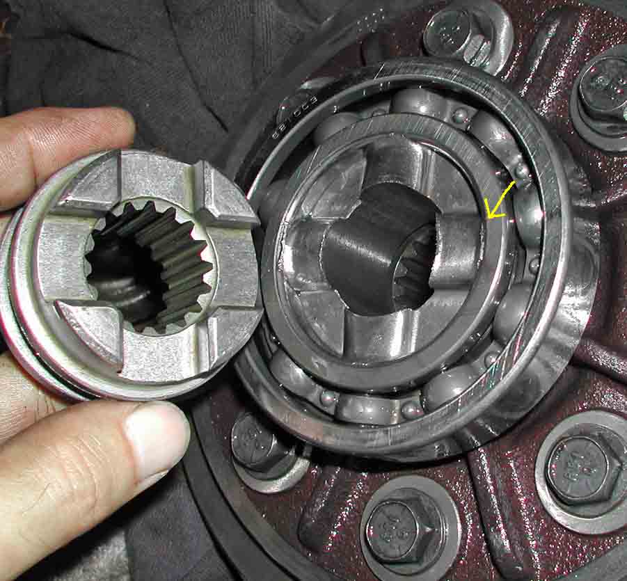

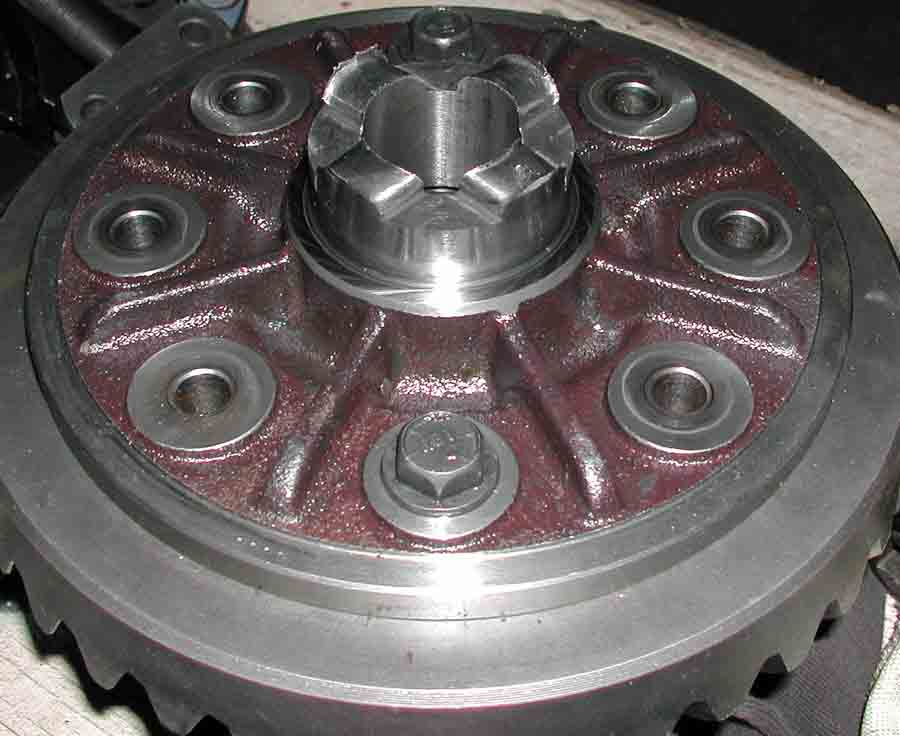

And here is my problem (photo 3). The moving collar that engages its 4
teeth with the 4 slots on the differential is in fine shape, but the latter
slots are worn by at least a millimeter. They are rounded off and somewhat
"mushroomed". The engineers chose to use a very soft cast steel for the
differential to engage with the hardened collar. Big mistake, IMO.

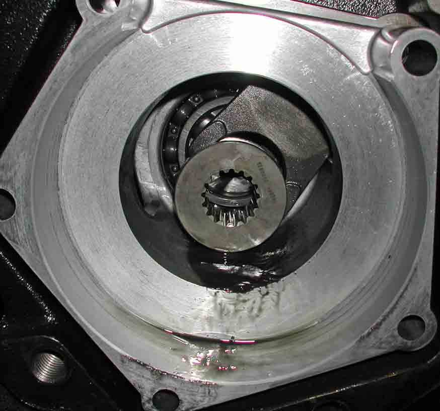

But first, I have to remove the 2 differential bearings (photo 4). If you
don't have one of these bearing removers, this bearing is not coming off.
Both of these bearings will be replaced.

With the bearings off the differential casting, you can see in the first
2 pix what has happened. Quite a bit of the cast steel has been worn
away, making it so the diff lock pedal had to be constantly held down
to lock up the rear wheels. This put a bunch of steel fragments into
the oil...not good.
Rather than replace the diff casting, I decided to grind off the displaced
metal, and re-contour the pawls (teeth) on the diff. A bit of work with
the air grinder (photo 3) and I am good to go. Now the two parts grab
much better. I was carefull not to remove too much material, however.
The photo does not show the new contour very well. Since I introduced
abrasives into the diff, I will need to take it all apart and wash thoroughly
with soap and water (next).

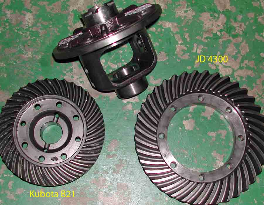

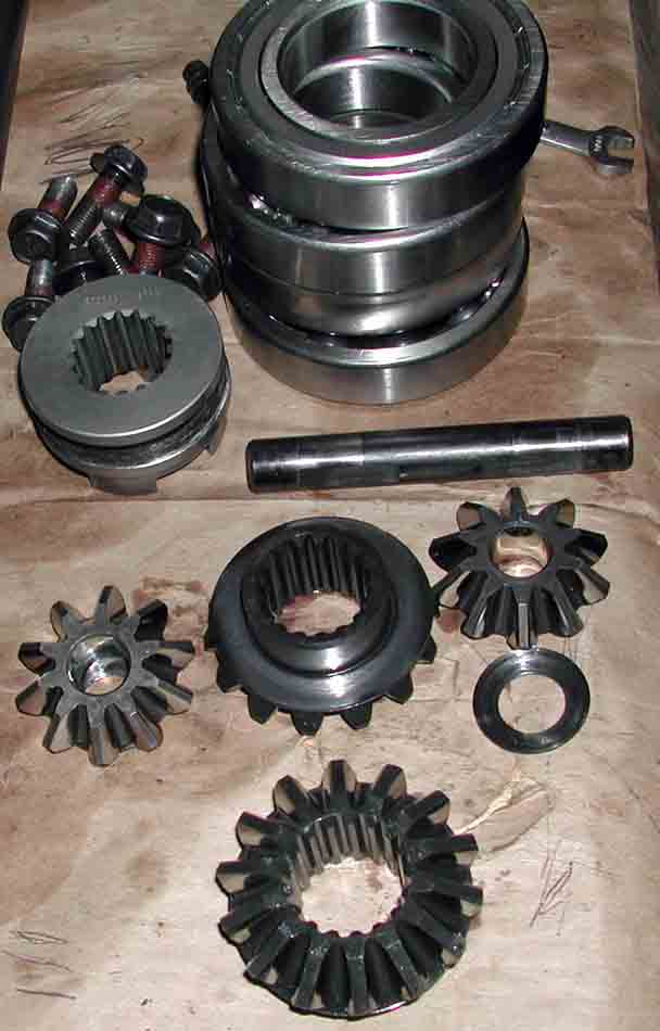

This is what the differential looks like, all apart.
Just to give a comparison, the Kubota ring gear I removed last year is on
the left.
The 2nd photo shows the spider gears. They are small cast teeth that
do have some wear (more than any other gear in this tractor), but are
reusable. My new bearings are waiting to be installed.
