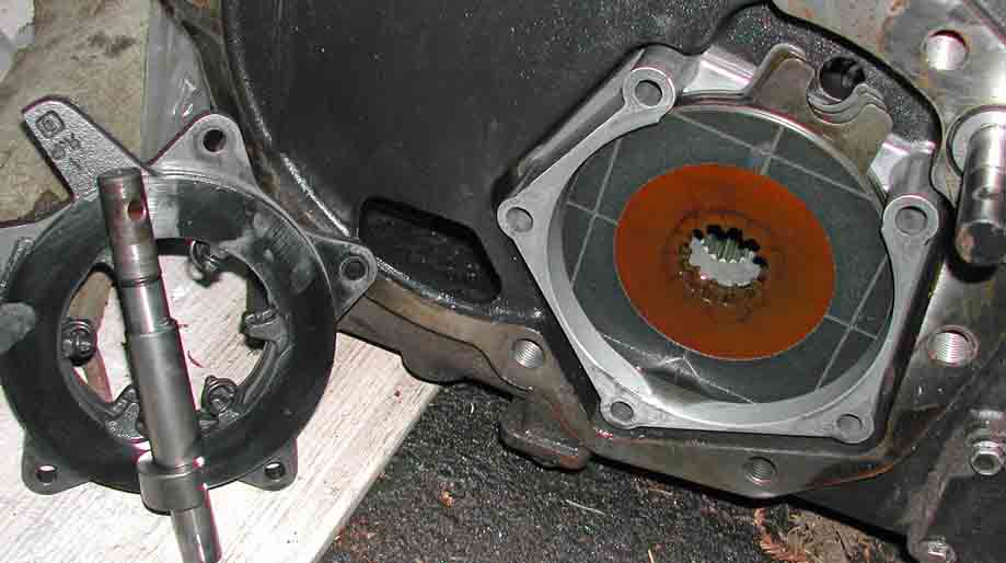

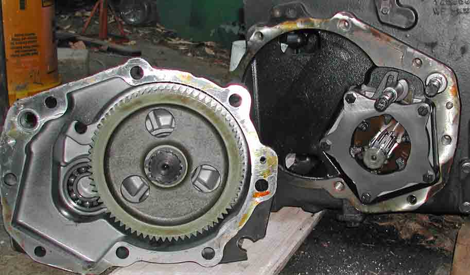

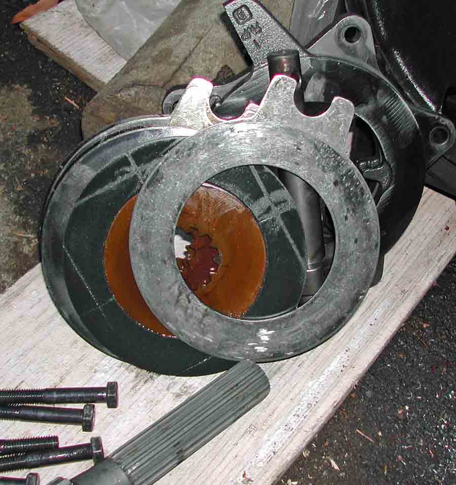

Now that the brake levers are off, I can remove the axle housings. All
moving parts inside the final drive will have to be removed and cleaned due
to all the metal fragments in there. It is amazing that there is little
damage.
In the second photo, the axle is out....what a big gear! You can see the
even polish of the contact surfaces of the gear teeth...looks good. The
axle itself is over 2" in diameter. This is where all the torque is maximized;
it is good to see robust components here. No bearings were bad, even
the Russian ones out near the hub.
In the third and fourth photos, I have removed the wet brake components.
They are not worn out, so I will reuse them. There are some aluminum
fragments between the last plate and the aluminum disc basket, so that
will have to be cleaned up.
