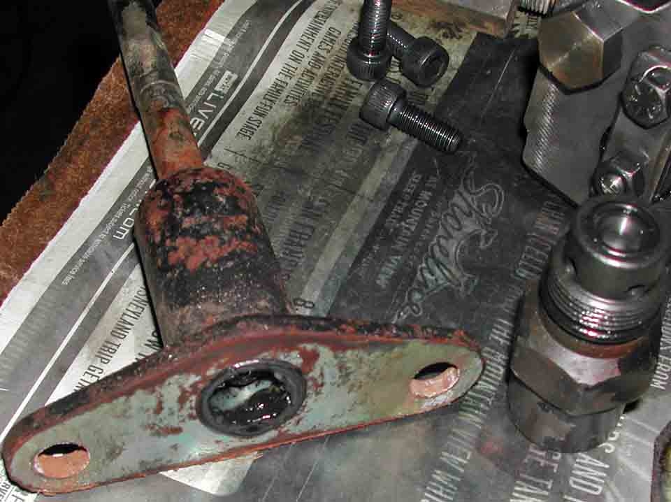

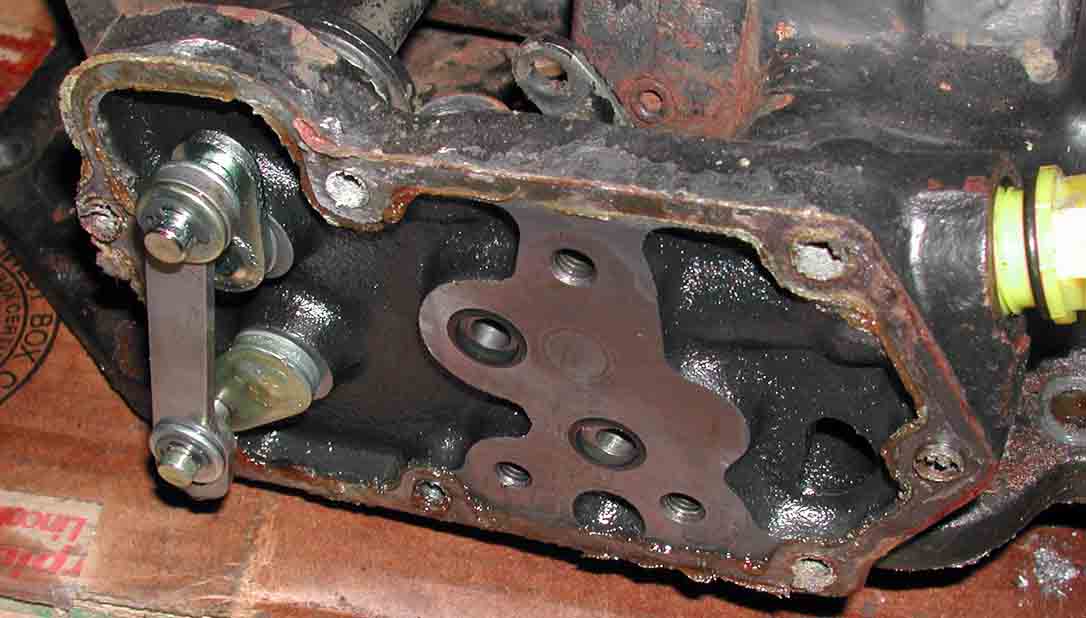

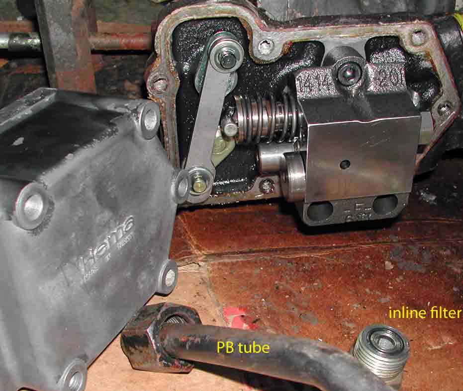

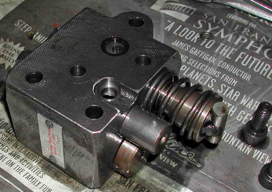

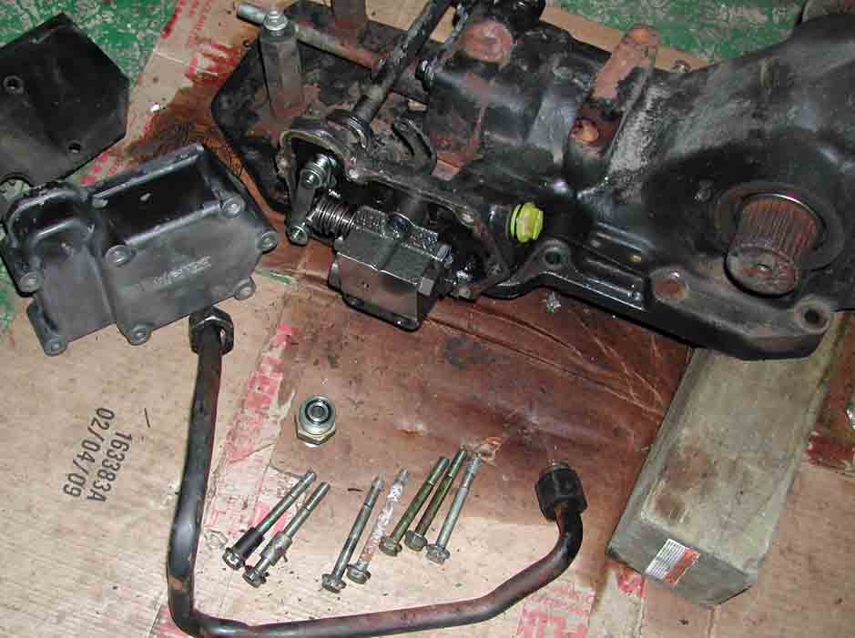

In this series of pix, I am taking apart the 3-pt lift (rockshaft) hydraulic
system.
The whole rockshaft assembly, including the cylinder casting, is made by
Hema in Turkey...they also made the implement hyd pump and PS/charge
pump.
The service manual does not even talk about the internals of the valve
itself (made by Danfoss in SC), except to say that if the inline filter fails,
you have to clean it out. My filter has failed.

For some reason, my 4th photo in the last post did not take. Here it is.

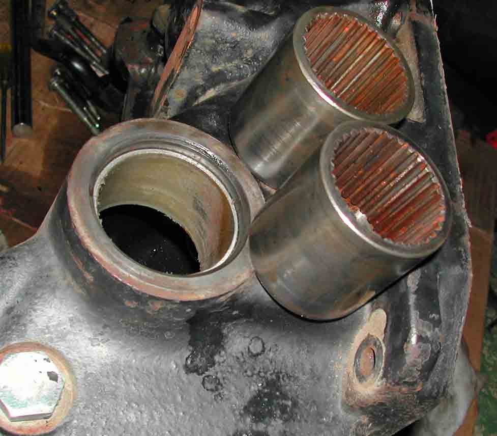

Currently, I am in the process of removing the spline shaft from the
rockshaft housing. It does not just slide out, so I may have to lug it over
to the press.....

My past experience ( non JD 4300) was that a heavy punch centered on the shaft end and a heavy hammer was all that was necessary. I would be surprised ....I often am, that it's not a true pressed fit.

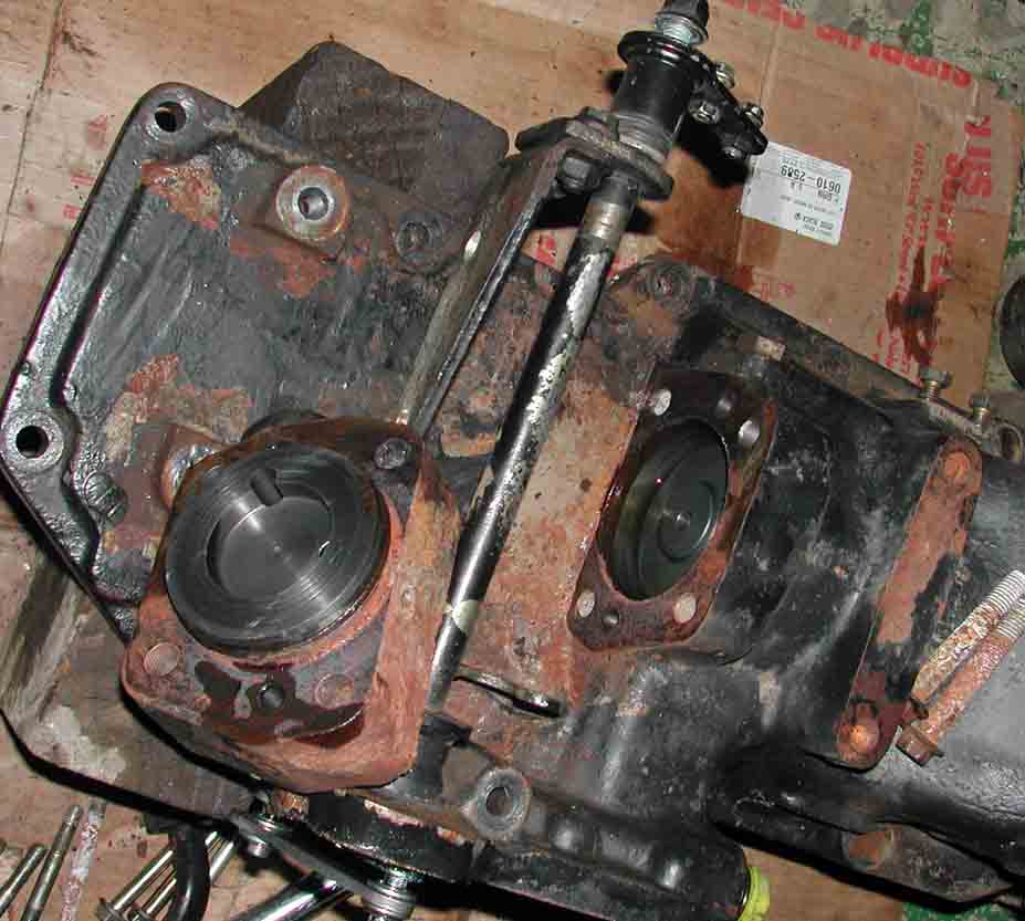

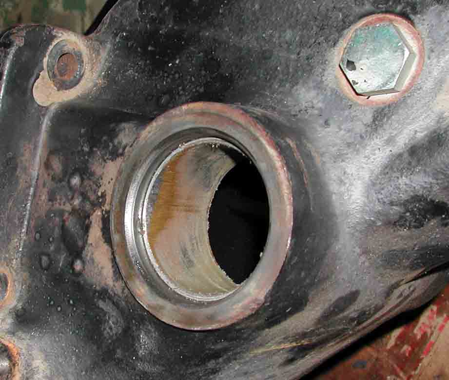

   / John Deere 4300 complete rebuild
#220
...a heavy hammer was all that was necessary.
Good suggestion. Stepping up to a bigger "persuader" was all it took.
The bushings fit snugly over the spline shaft (rockshaft), but not so tight
as to require a press. Good thing, as I would need help to hold this
casting on the press bed if I went that route.
You can see the bore in the first two pix. The inner bushing seems to
have a plastic coating over a copper- or bronze-plated steel press-fit
bushing. My service manual has no spec on the wear limits here, maybe
because Hema has produced multiple variations for Deere. The book
talks about an outer bushing diameter of only 1.83" and mine is about
2 1/3".
Pressing these inner bushings out and replacing them may be a good idea,
but I would need help to hold the housing in the press. They may be OK
as they are. Another judgment call.

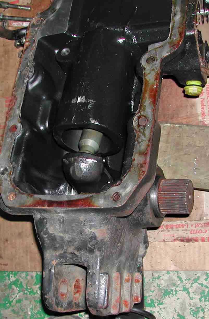

Also pictured are the rate-of-drop valve controller and the rockshaft
valve housing and cylinder head. Rust on both items has gotten inside.
Recall that this housing was covered by more than an inch of dirt (mud)
that caused the corrosion you see. Rust did not get past the O-rings,
however...that is good. In the last photo, you can see the piston. The
cylinder bore is smooth and the piston is quite snug, so I will not remove
it. Removal likely can not be done without damaging its seals.
Owners of these tractors should keep this hidden area under the seat
clean to avoid corrosion. Hema's paint adhesion is awful. I will be doing a
bunch of scraping, cleaning, and painting before all this goes back together.
