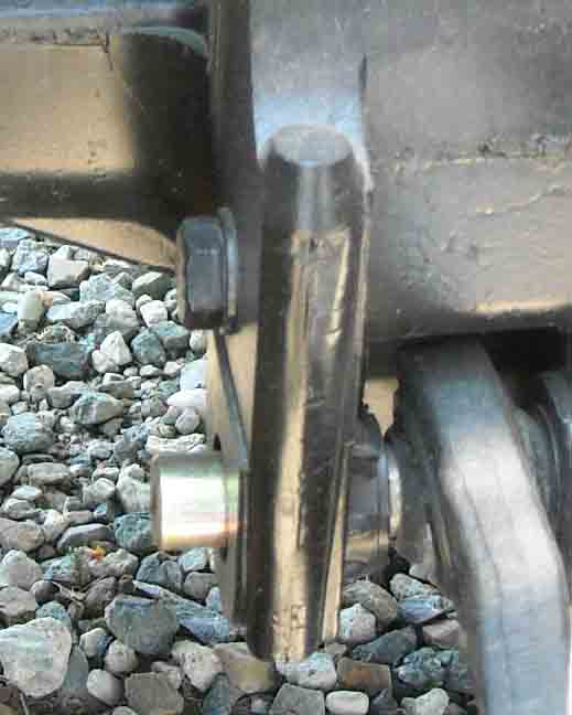

Nice work!
One question...I know its all done now...BUT...Why not bore the holes to 1.125" and have some 1/8" steel bushings pressed in?
Would be alot stronger in the long haul by spreading the load on essentially a 1 1/8" pin thru the aluminum and wouldnt egg out as easily...and if they DID egg out, remove & replace the bushings....good as new!

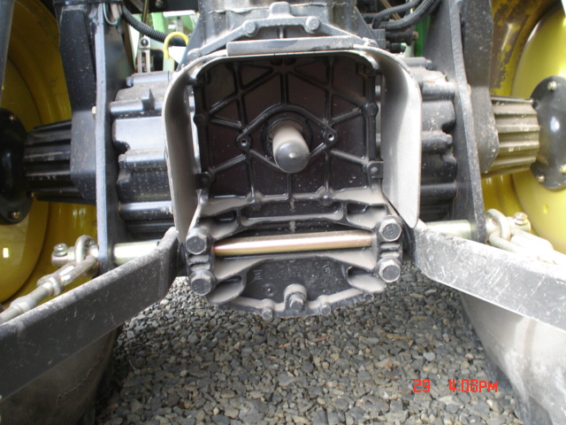

I seriously considered doing it that way, or even something like the rather
bizzarre solution they used on the new 3x20 tractors (see photo). I even
have steel bushing stok here that would work.
I chose neither for two reasons. One was because I decided not to
bandaid what is essentially a bad design. I made it slightly better than stock. If I kept this tractor for the long term, then I would have
done more. The other reason is that there 2 failure modes
here: one is the holes get egged out from steel-on-Al wear. The other
is the casting is pulled out due to excessive tension. A steel pressed in
bushing would reduce the first problem, but increase the second one. With
a bushing, there is less Al material to pull apart, so it is weaker. My welder
agrees.
Anyway, I certainly spent enough on this.

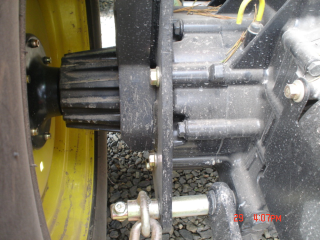

   / John Deere 4300 complete rebuild #207
This is the 3032e rear shot,is it similar to the other 3000 & 4000 series tractors..? Mixture of AL & cast steel I think. the axle housing & final drive case is AL upper rockshaft area is cast steel, magnet sticks hard there,also mid-tunnel section is cast steel as magnet also sticks there. Is this how all the 3000 series & some 4000 series are done..?
great project you are doing & I am following with geat intrest
Joe
That looks tons different from the old 4x00, old 4x10, and current 3x20
series. Is the 3032e a current model?
I posted earlier about the current 4x20 series....essentially NO aluminum
used in those big boys. Not is the same class as the older series that
started with 4.
Thx for posting, Joe.
