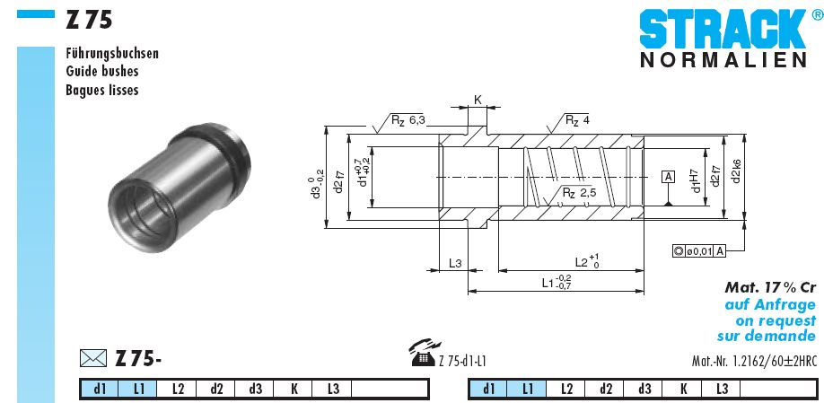

In Europe they have a lot of standardized mass produced components to choose from (cheap compared to making your own or custom). Includes tool steel bushings with grease passages etc. STRACK NORMA

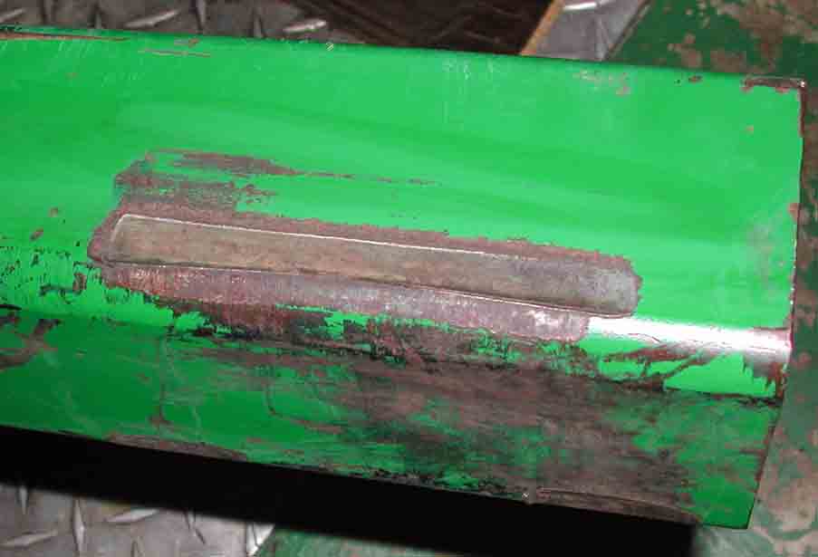

Since I am about to install the bellhousing over the HST, I thought
this was a good time to repair the loader support beams. As can be
seen in these pix, they are quite warn. One spot seems to be a full
millimeter in depth. Note that the feet of the loader mast is also
warn. You can see a bit of mushrooming at one of the contact points.
This part is cast, but probably only a bit harder than the mild steel of
the support beams. I have never had this type of loader before, but
I hear it gets quite sloppy with age and use.

   / John Deere 4300 complete rebuild #226
I knew a guy who had one with the loader mount like you have. I agree that the loader becomes very sloppy after using it awhile. I was suprised at how lose the loader was on the square tubing. I feel they would have been better to have pinned the loader onto the square tubing instead of letting it rest on top of the tubing.

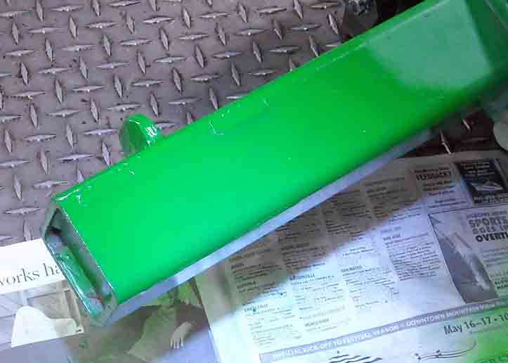

Here is how I repaired the FEL support beams.
First, I am doing this repair at this time in the Big Rebuild because the
beams are installed on the bellhousing....I saw no need to remove them
and they provide convenient support points for the tractor reassembly.

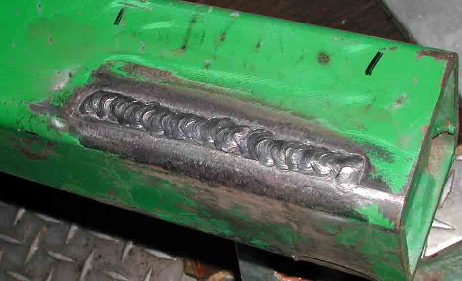

I decided to go with welding a bead or 2 in the areas of wear, then grinding
down to a planar surface a bit proud of the surrounding original material.
The official John Deere fix is to weld shims in all these areas. See this
thread for that procedure:
http://www.tractorbynet.com/forums/john-deere-owning-operating/152571-loose-430-loader-shim-fix.html
(good job, Chuck)
I am generally satisfied with my welds (stick and MIG), but I have much less
success with out-of-position (OP) welds, as in vertical or overhead. So,
I try to do all mine horizontally. I flipped the bell housing over for each weld.
You will have to remove the beams on an intact tractor to avoid OP welding.
For this job, I went with a 7014 rod and my Miller Thunderbolt DC welder.
For those not familiar with this rod, it is very low spatter and makes very
pretty beads on flat surfaces, such as butt welds. They work poorly (for me
anyway) at fillet welds. There is no hammering to remove flux....it just falls
off. In the 3rd photo, it came off all in one piece. Like the common 7018
rods, this rod is a 70,000 psi steel.

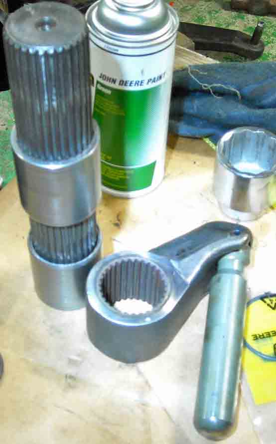

Here is the actual "rockshaft", as Deere calls it.
It is quite hefty, as is the push rod and arm. The push rod fits loosely
inside the bottom of the piston....that is why only the weight on the
three point keeps it from lifting.
Since the shaft's splines are exposed to the elements, you get a bit
of rust, which explains the resitance to removal. My retaining washers
are missing (this tractor was a spare parts donor), so I can't fully assemble
the rockshaft system until I buy (or make) replacements.
