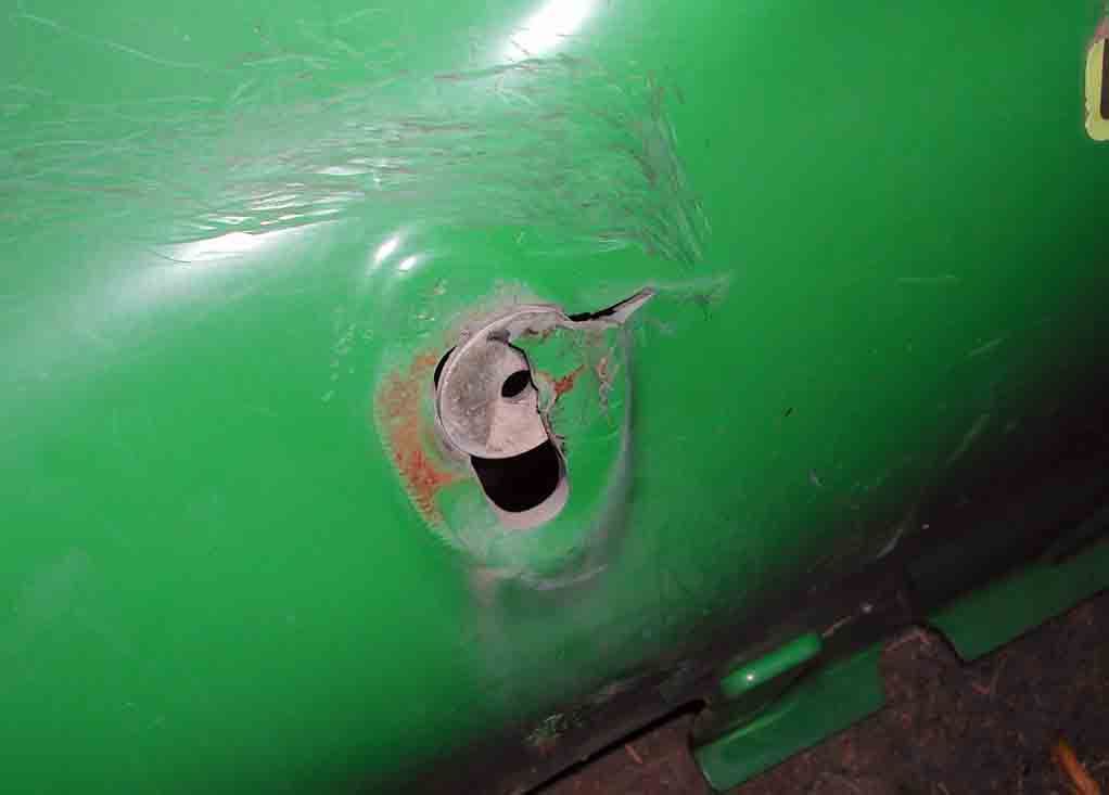

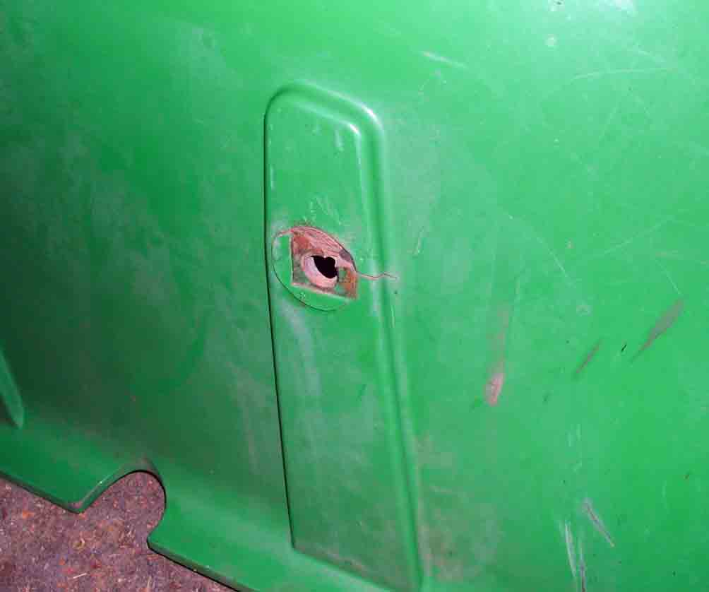

Here is the first serious failure I have seen in the plastic rear fenders.
On these 4300s, like most CUTs, you have to lean on the left fender to
get off and on. Eventually, that can cause damage to the fender. My
first rental tractors had all-steel fenders, and flexing had caused fatigue
in the metal in multiple locations. These Kubotas had anywhere from
1700 to 2300 hours on them. I removed the fenders and welded them,
adding some more steel in critical locations.
Plastic fenders won't be fixable that way, but I am happy to say that
all the other 4300s at the rental yard (one with as many as 2700 hrs) had
no serious rear fender failures.
This particular unit, with 2019 hrs failed more due to being improperly
secured to a trailer. You can see the marks of a chain that went between
the fender and the ROPS. One of the large washers has almost pulled
all the way though. Another mounting point is seriously challenged.
I will fabricate some large steel backing plates to replace the washers.

   / John Deere 4300 complete rebuild #490
You have to wonder about some people when you see a machine's been chained down using the plastic fenders.:confused2:
