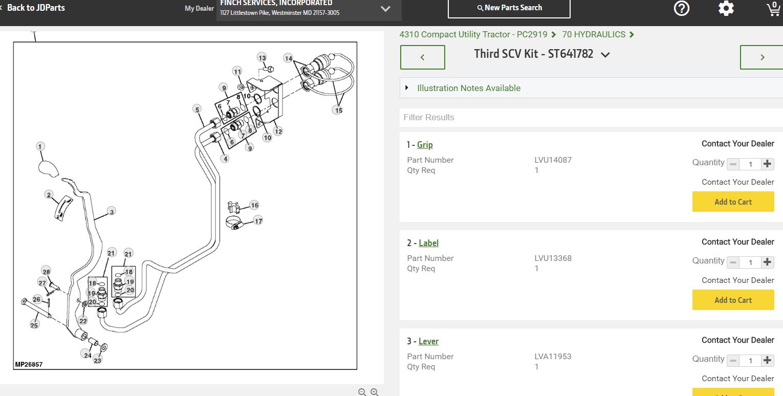

On the tractor there is a VALVE-3 SPOOL SCV part #LVA10901. On the tractor we have, the valve spool is using 2 of the valves,
1 valve is not being used.
I am wondering what is the purpose of the 3rd spool? Since only 2 are being used.
My husband wants to do a top & tilt function on the tractor. Has anyone installed the top & tilt?
What about POWER BEYOND KIT?

The 3rd spool was for the "3rd SCV kit" from JD, it added the handle, linkages, hardlines, and couplers on the rear of the tractor to operate on addition device. The part number is LVB25084, they are getting hard to find now but if you search that you'll find lots of threads and pictures.
For a TnT setup , you need 2 spools, or you can add in a diverter to effectively "split" the single rear remote into two. We actually sell a kit for the newer series tractors to do this.

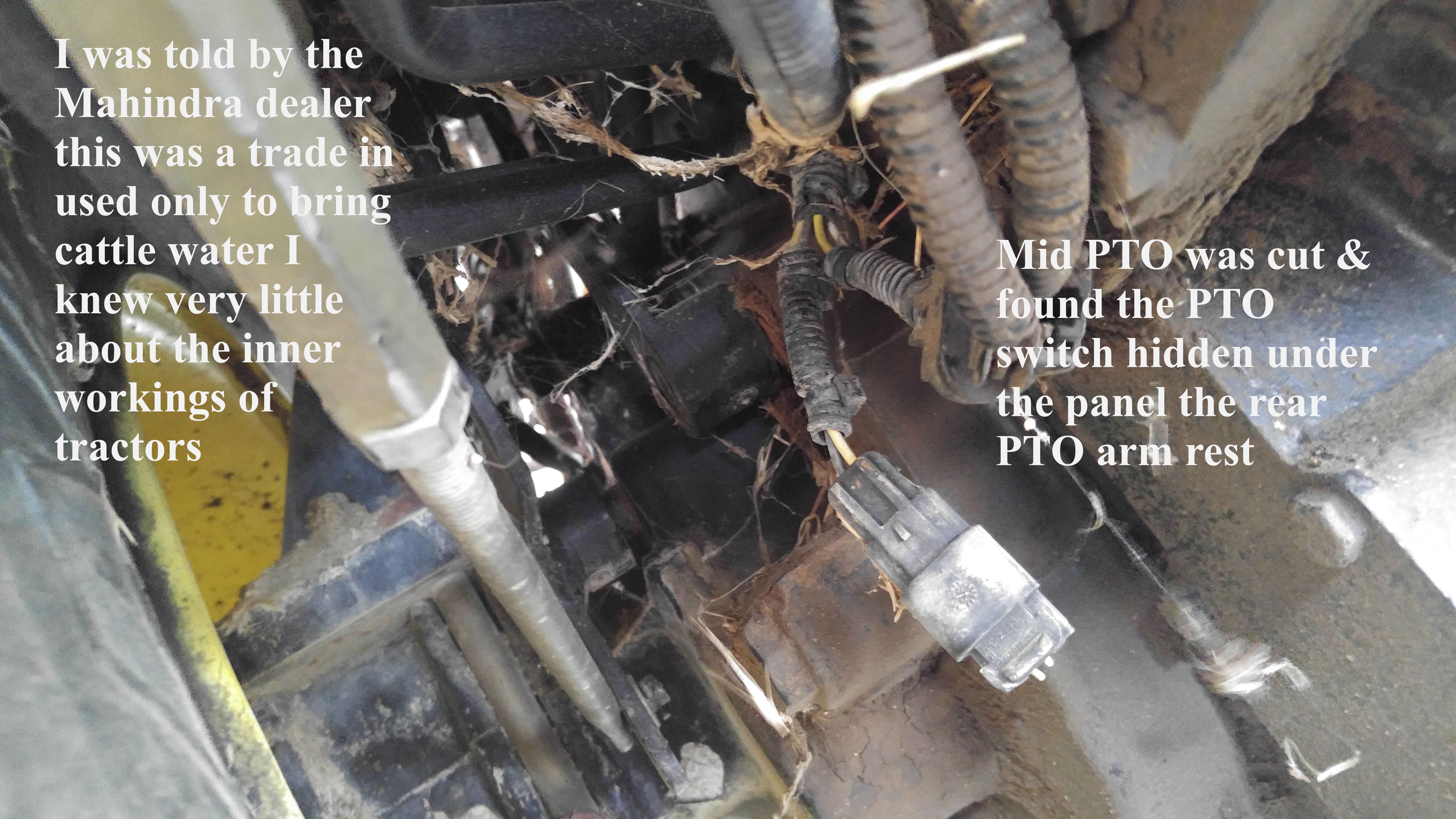

My question regarding the MID PTO, it looks like someone snipped the wires for that function.
MID PTO solenoid, can you use this for a 3rd function? Or is this strictly for the MID PTO?
The REAR MID PTO solenoid was removed on our tractor. I am not sure why this is.
Below, I attached a photo of the snipped wire. My husband labeled the photo.
Regarding the snipped wires, I am not sure Why this would be snipped.
I am wondering if anyone has any ideas?
Maybe an arrow added to the photo of the snipped wire.. I don't see it.
Seems like a lot of trash and maybe the snipped wire is there somewhere.

I don't see the snipped wire either. I guess for some reason they felt a need to disable it, if you don't have a need for it I'd just leave it be. It was used for a mid mount mower (MMM), front snow blower, or a front power broom.

The power beyond kit number is LVB25085. Power beyond requires a loop back to the system reservoir. You can use any open center spool valve configuration attached to it. So if you can find a good place to mount it you can have a valve with 1,2,3, or any number of spools connected to the power beyond circuit.
I think I've seen a couple of different options on the unused third SCV spool. I believe it's original intent was for a mower lift on a mid mount mower. I don't have the other option numbers handy but one kit used a cable to operate it and another kit just had a handle. The LVB25084 kit Ken mentioned has the direct handle according to the pictures. John Deere lists a LVB25311 Top and tilt kit (4210 - 4410) that requires the LVB25084 and a LVB25087 Diverter valve to operate it. All of this stuff can be fabricated from scratch with some mechanical abilities and the right fittings. It takes a lot of research but it can be done. The ports on the unused 3rd SCV are metric M18x1.5. The adapter used to convert it to a standard #8 ORB fitting is JD#38H5003. You may find this thread helpful.
The "snipped wire" is a plug JD uses to terminate unused options on the wiring harness. You will probably find another like it on the right rear which I think was for the trailer option. Mid PTO was an option. Not all the 4310s had a mid PTO. Mine doesn't. Does your tractor have the mid PTO splined shaft underneath? Does it have the second yellow knob on the right fender?
